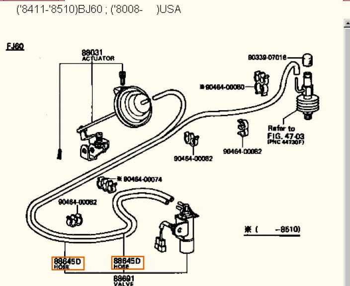

The ac idle up screw is on the front of the carburetor. It should only be "active" when the AC is on, but I suppose your AC idle up vacuum switching valve could be stuck open or your vacuum hoses could be routed wrong such that the AC idle up is always active.
Below is a schematic of that circuit. The actuator is located on the front of the carb. The vacuum source is from the rear of the intake manifold (where the brake booster vacuum connects). The connection of the vacuum lines on the vacuum switching valve is important. The lower port should be connected to the actuator as it is vented to atmosphere when the valve is closed.

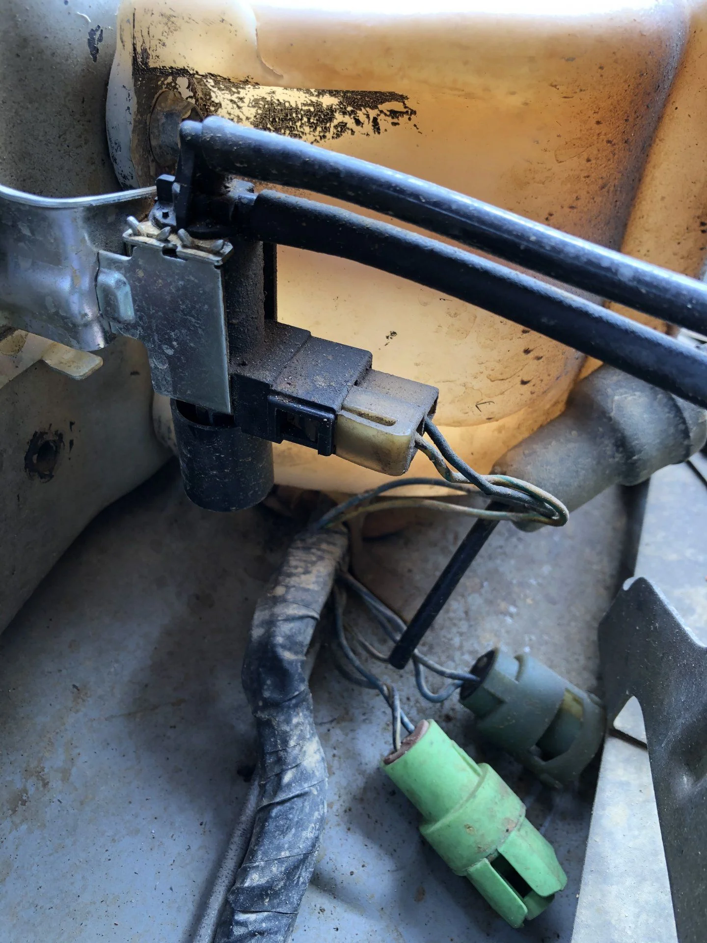

@cheezypoof I adjusted the carb via the lean drop method. Then I learned that my VSV was not working at all, actually visibly broken. I replaced it with part number 88690-32280. Then I leaned drop adjusted again to make sure the "AC Idle up" RPM was correct. All seems to be well now. (well, with that part.... Its a 33 year old truck, so there are other things...)
