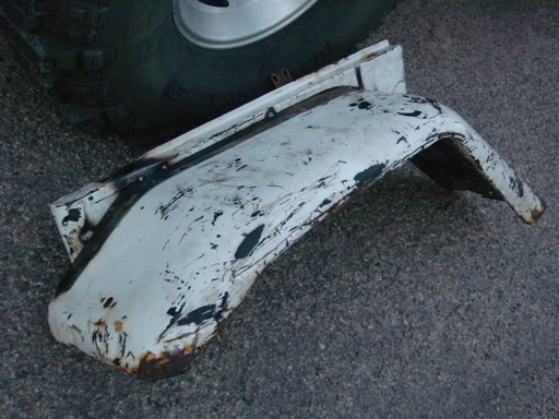

step 1.
-get a set of good fj40 fenders... (sometimes harder than expected. I didnt use the ones on rank..)
step 2.
-if they are on the truck remove them because there is going to be a whole lot of cutting to them happening...

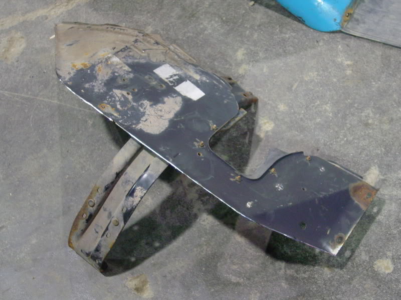

-cut the inner skirt of the fender off. cut along the inside fender line where the top of the fender is spot welded to the inner skirt.
step3.
cut the fender support off because it wont work now with the fender in its soon to be new postion...

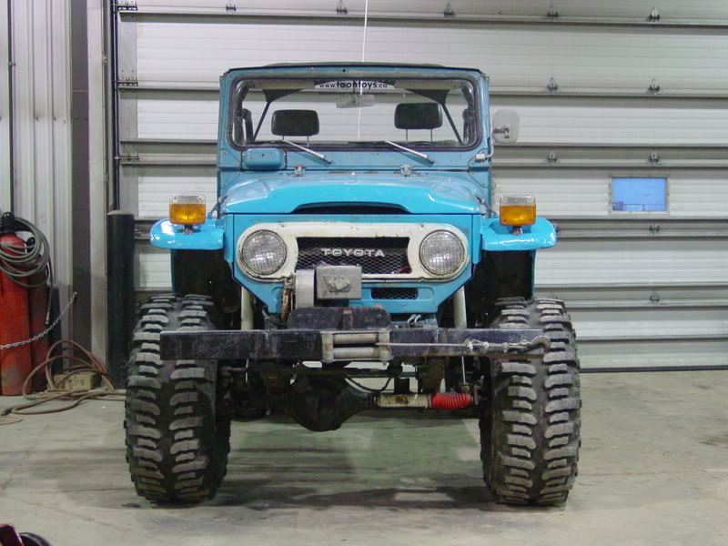

here is another pic to show what is happening with the fender placement..
step 8.
once everything is tacked and wont fall apart for the time being you have to bob the front of the fenders... you dont have to but i found it looked like a set of fangs hanging out there so i bobbed them back to a length that I though stuck out as close to stock as possible...
from here weld everything up but dont go crazy or else you might get a lot of warping...i welded mine up on the truck and found it helped quite a bit..
step 9.
once you are happy with everything, do the body work.... my fenders were awfully rough and i didnt have any kind of body filler at the time so i just primed and painted...
- attatch your light and now you have some high clearance fenders that not even 40 inch tires should be able to touch...
