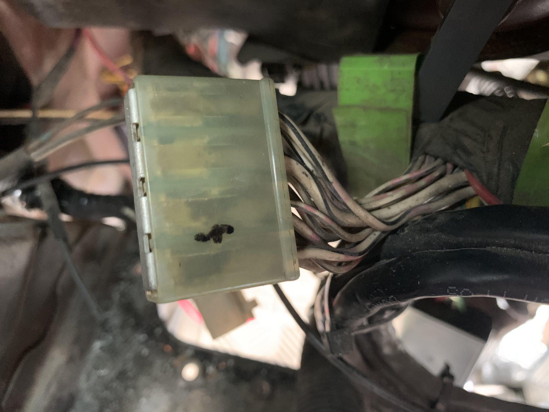

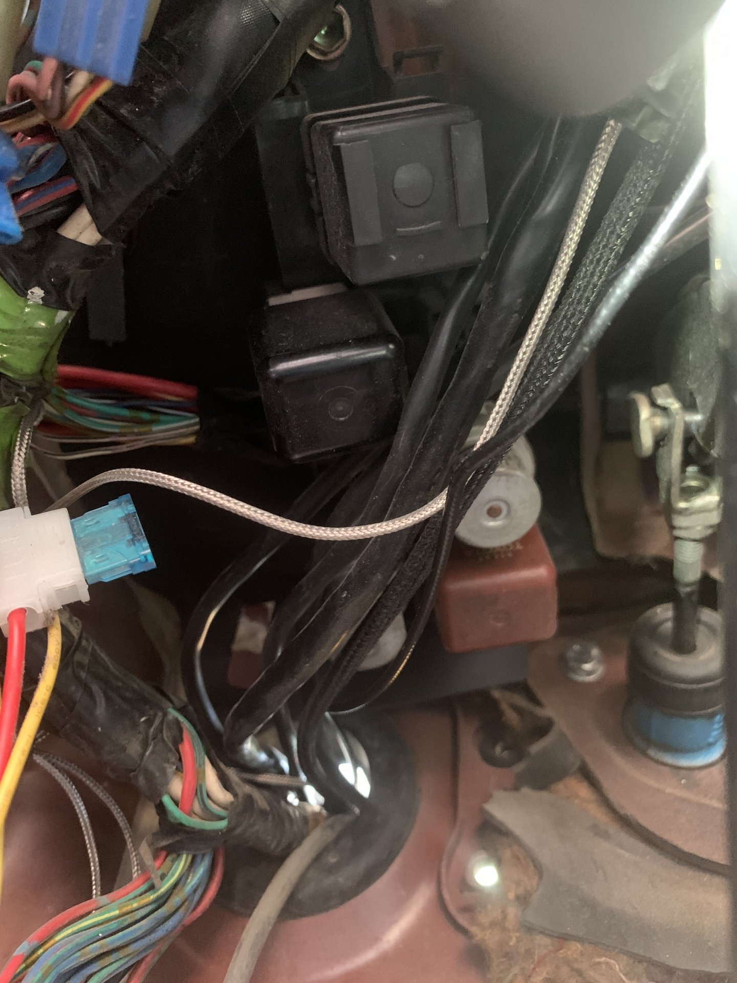

I have removed the instrument panel and located the common ground which seems to be the source of a lot of electrical gremlins. I don’t see any indication of burning other than some dark spots inside the casing.
Does this look like it could be a source of trouble? I have bunch of different size pin removal tools, how do I know the correct pin out tool?
If the common ground isn‘t the cause of my short where else should I look? is there a safe temporary workaround? I plan on changing/gutting the dash in the fall.

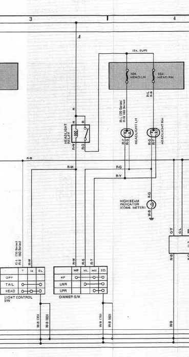

A short to ground causes fuses to blow, not a bad ground connection. Were you able to try what OSS recommended to swab bulbs left to right and see if the other fuse blows. Looking at the wiring diagram, I would suspect the bulb is bad. The bulb provides the resistance that controls the current flow. If there were a short between the fuse and the bulb, then the fuse would blow on low or high beams. A short after the bulb would mess with when the lights turn on, but not blow fuses.
If you have a different wiring harness, then it would be helpful to see what that is like.
This, "I tried some spare bulbs but the lights don’t have power with the gauges removed."
You have some weird stuff going on with aftermarket wiring, a "headlight harness", and custom gauges. This is not something easily diagnosed through the FSM and a stock wiring system.

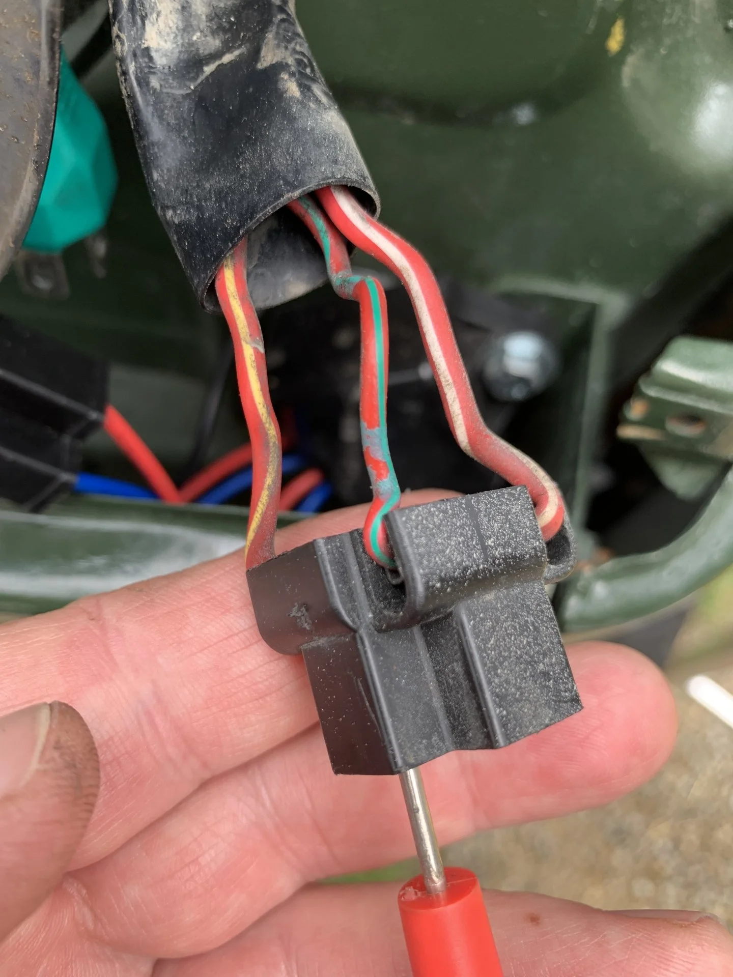

I swapped bulbs and still popped the fuse.
I checked resistance and found the red/white wire has .239 resistance and the red/yellow has .493 resistance.
Installed a 20 amp fuse and it did not blow. I‘m using LED headlights from Cityracer.
I inspected a large portion of the wires under the hood (de loomed) and found no breaks or burn marks.
Next I will located the hi beam relay and check it for continuity.
