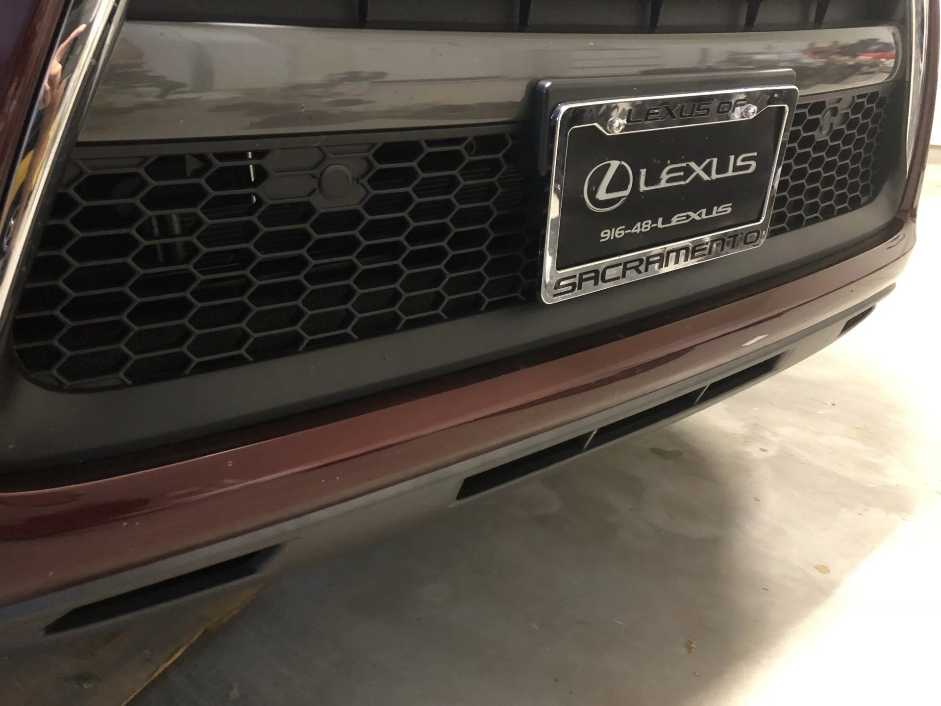

Hey gang
Has anyone installed/mounted hidden led light bar or fog lights begind the “honey comb” grill area on post face lift GX?
Thanks in advance

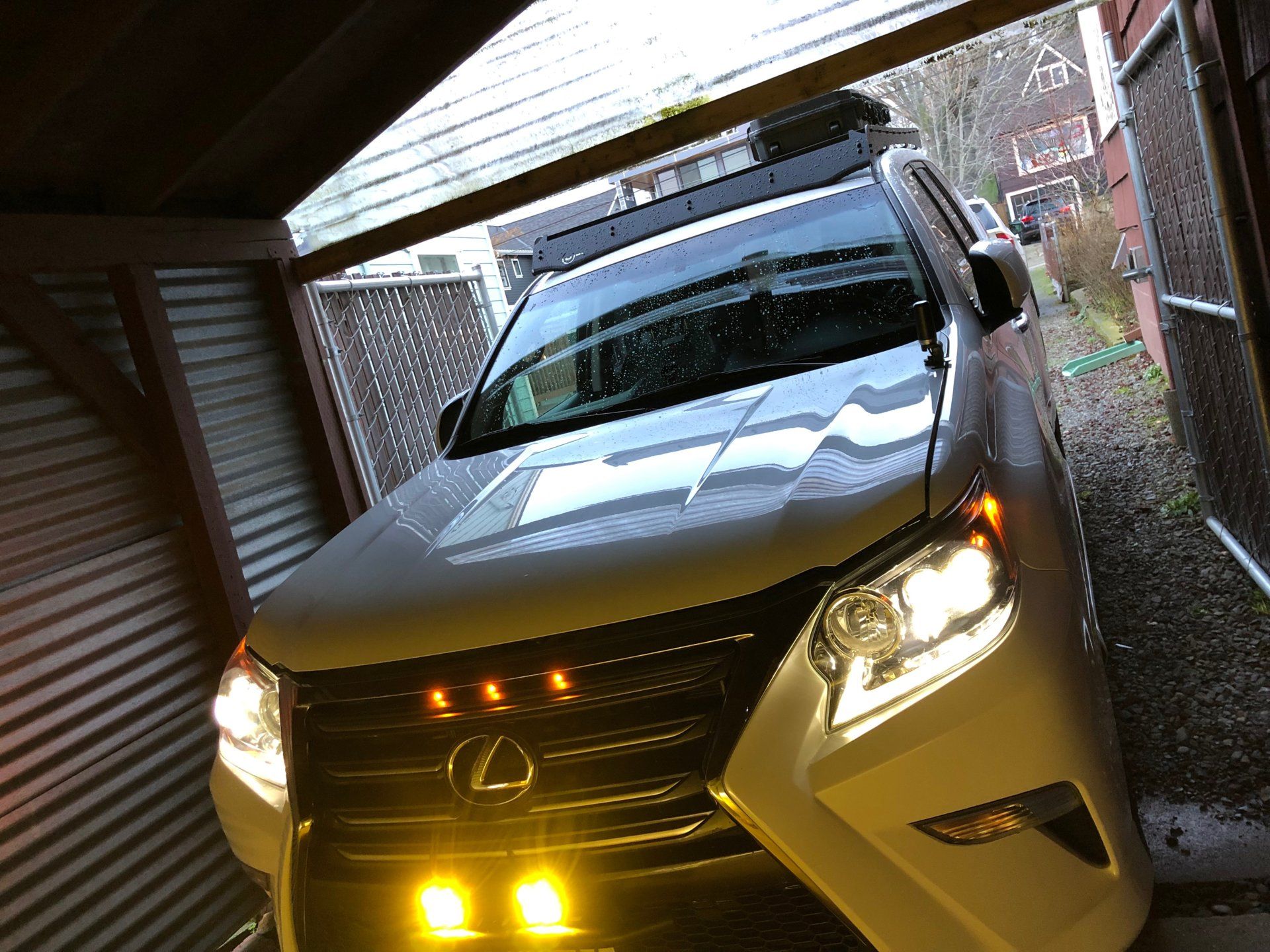

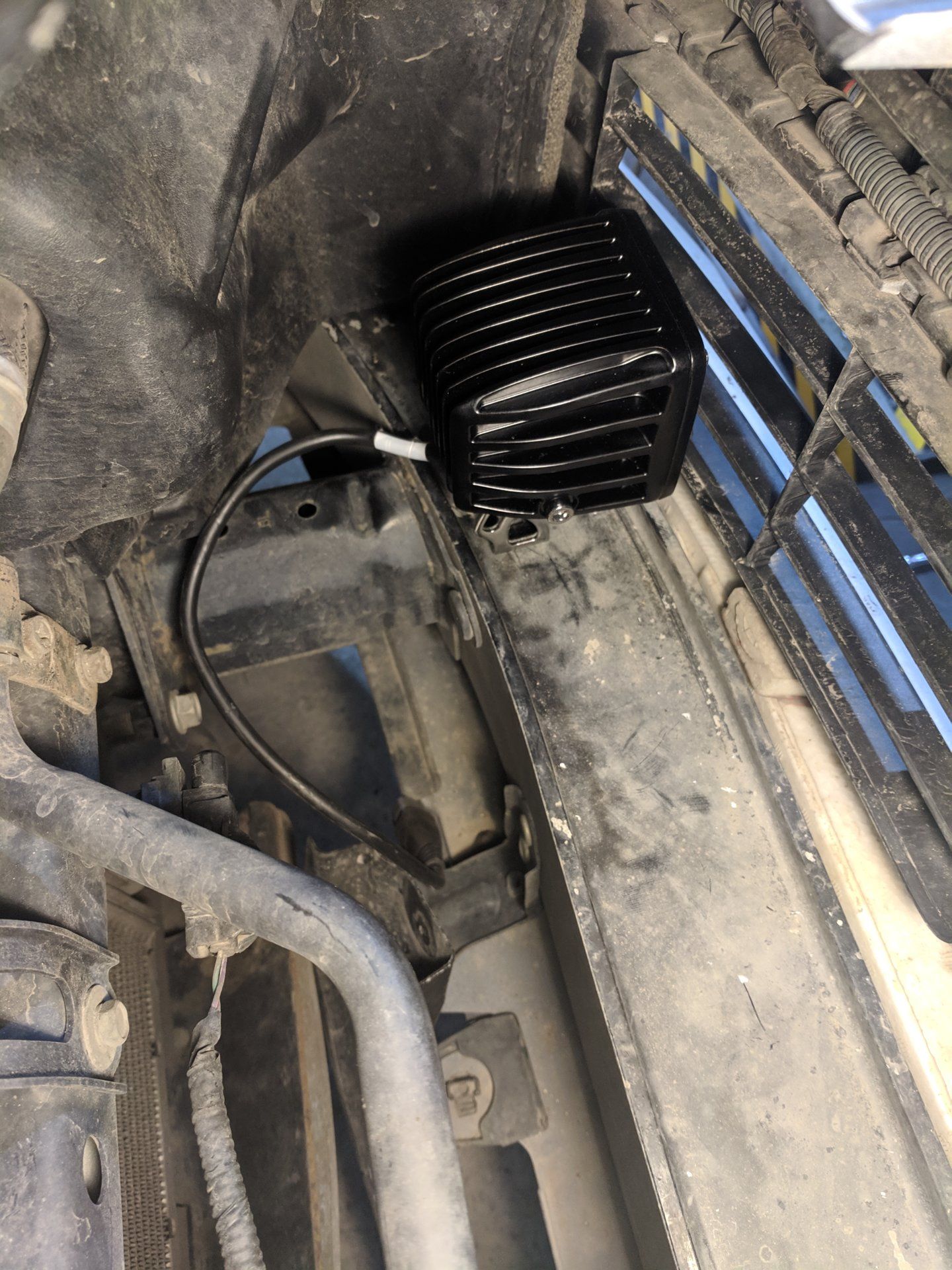

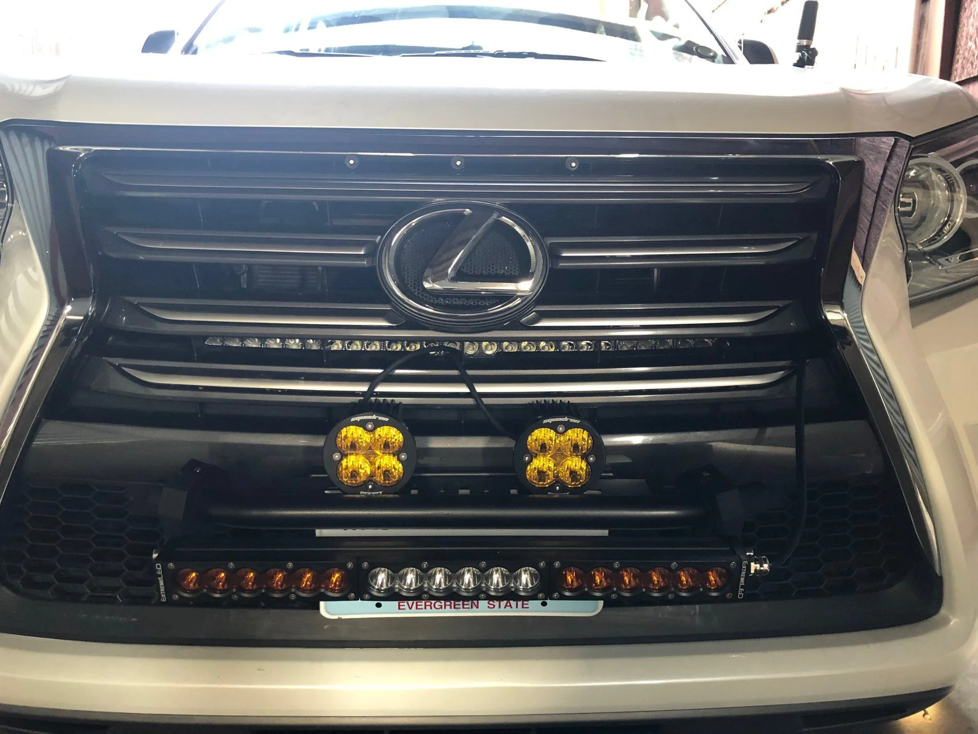

After some thinking and poking around think I’ll go for the cheapy license place mounting bar some here have some and use a small 9 inch Amber/white combo light bar. See how it goes.
There doesn’t seem to be anything structure near the brill so gonna go cheap route for now till I find better solution.

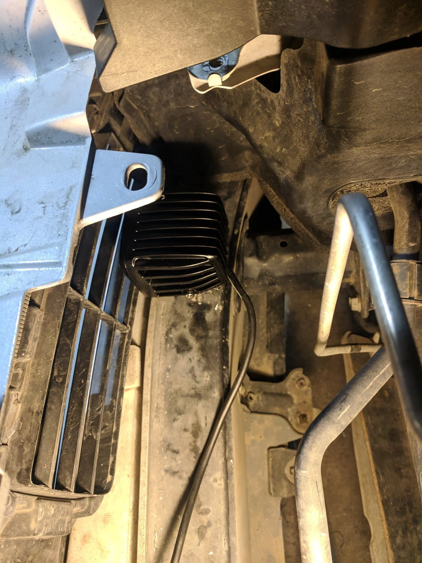

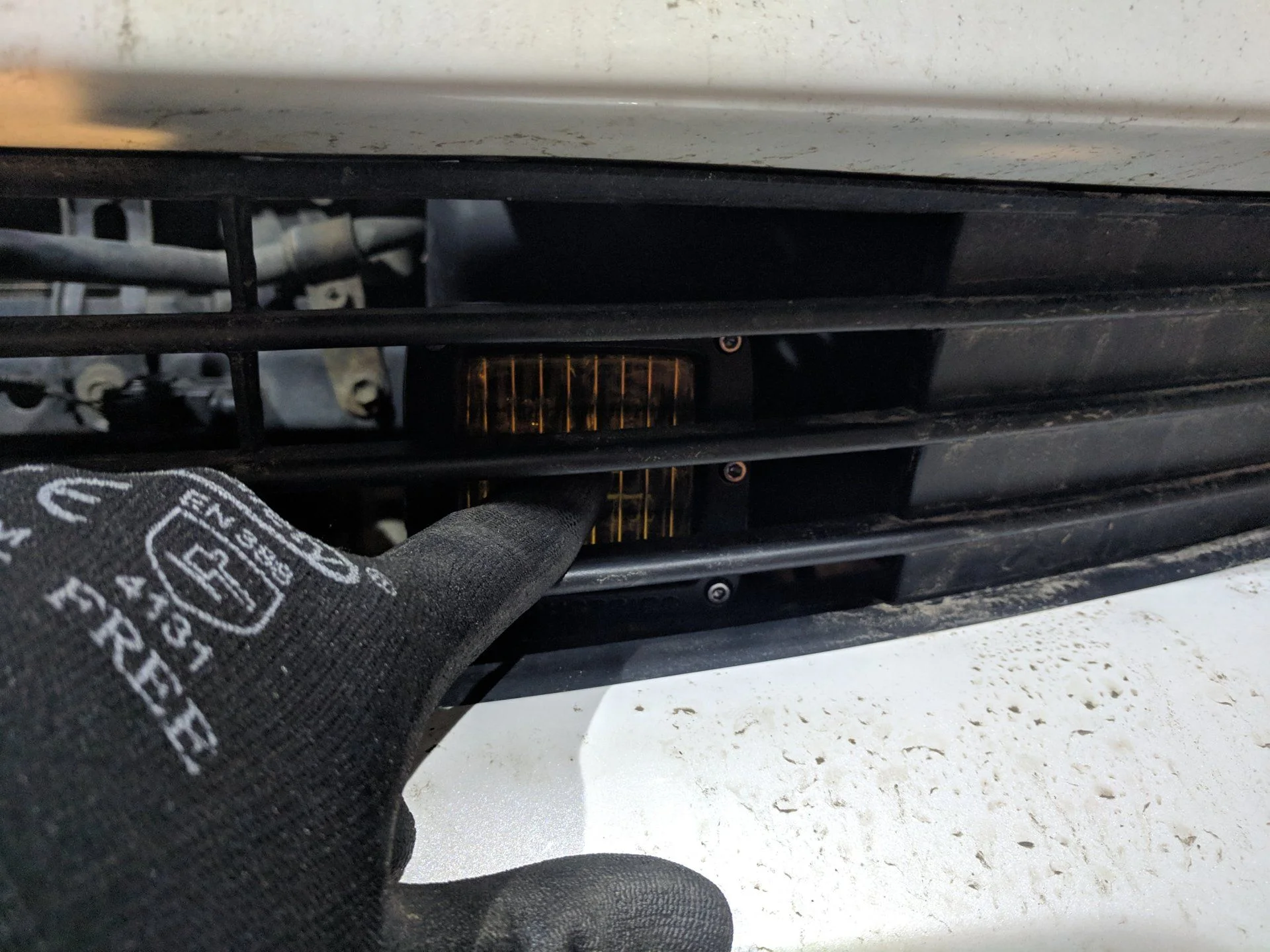

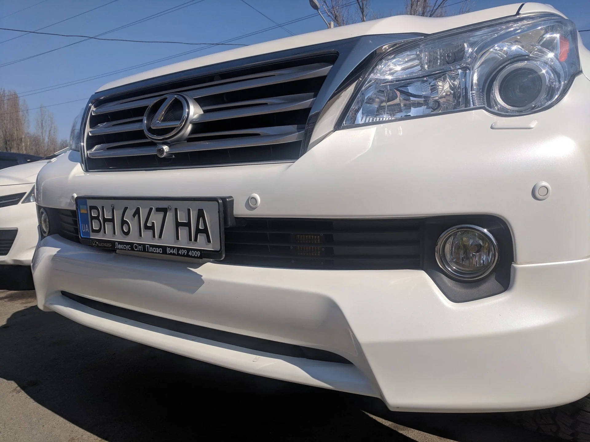

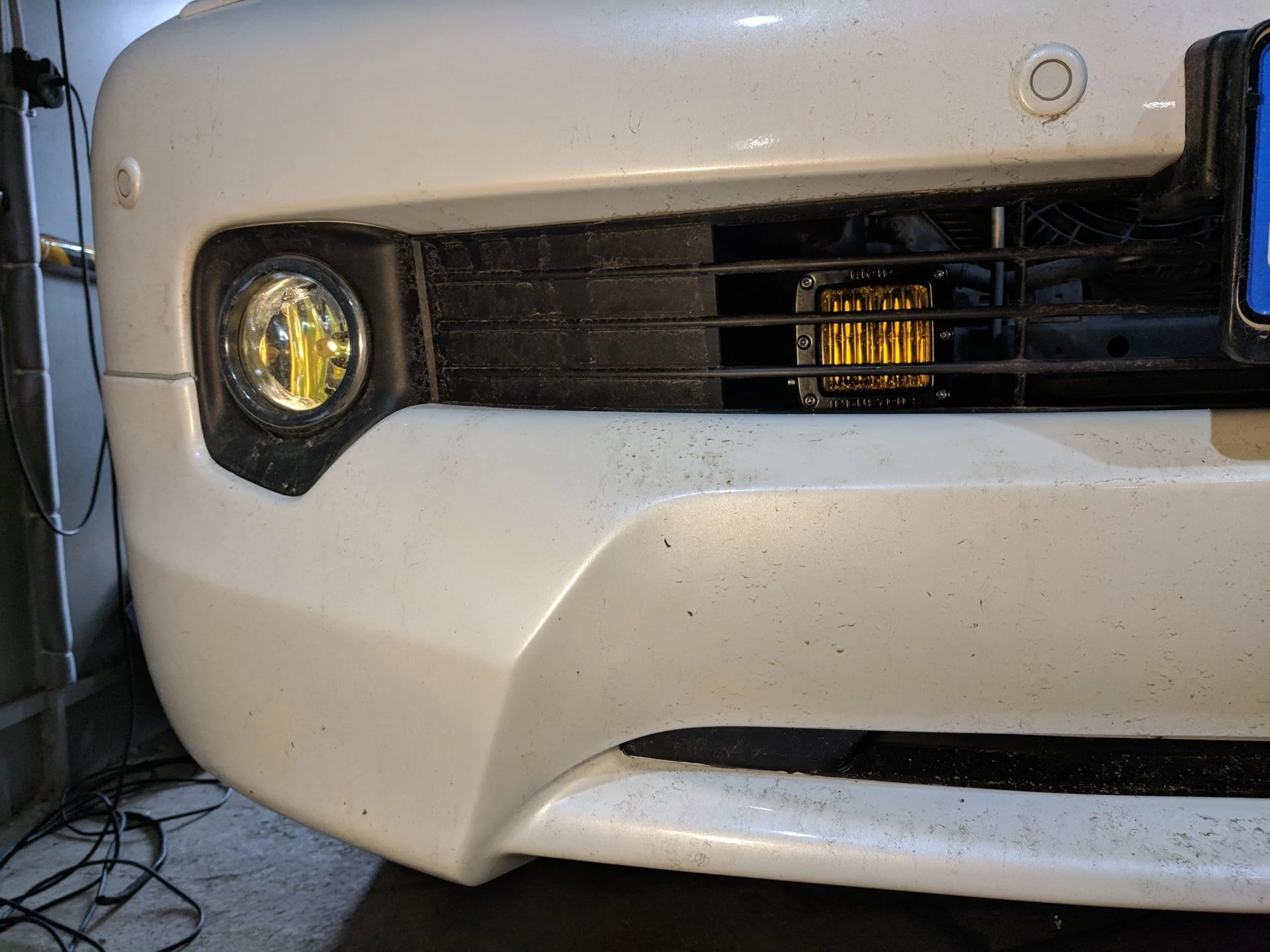

Do you have a pic you can share of how you installed your led light bar with those brackets you linked? Looks really nice.

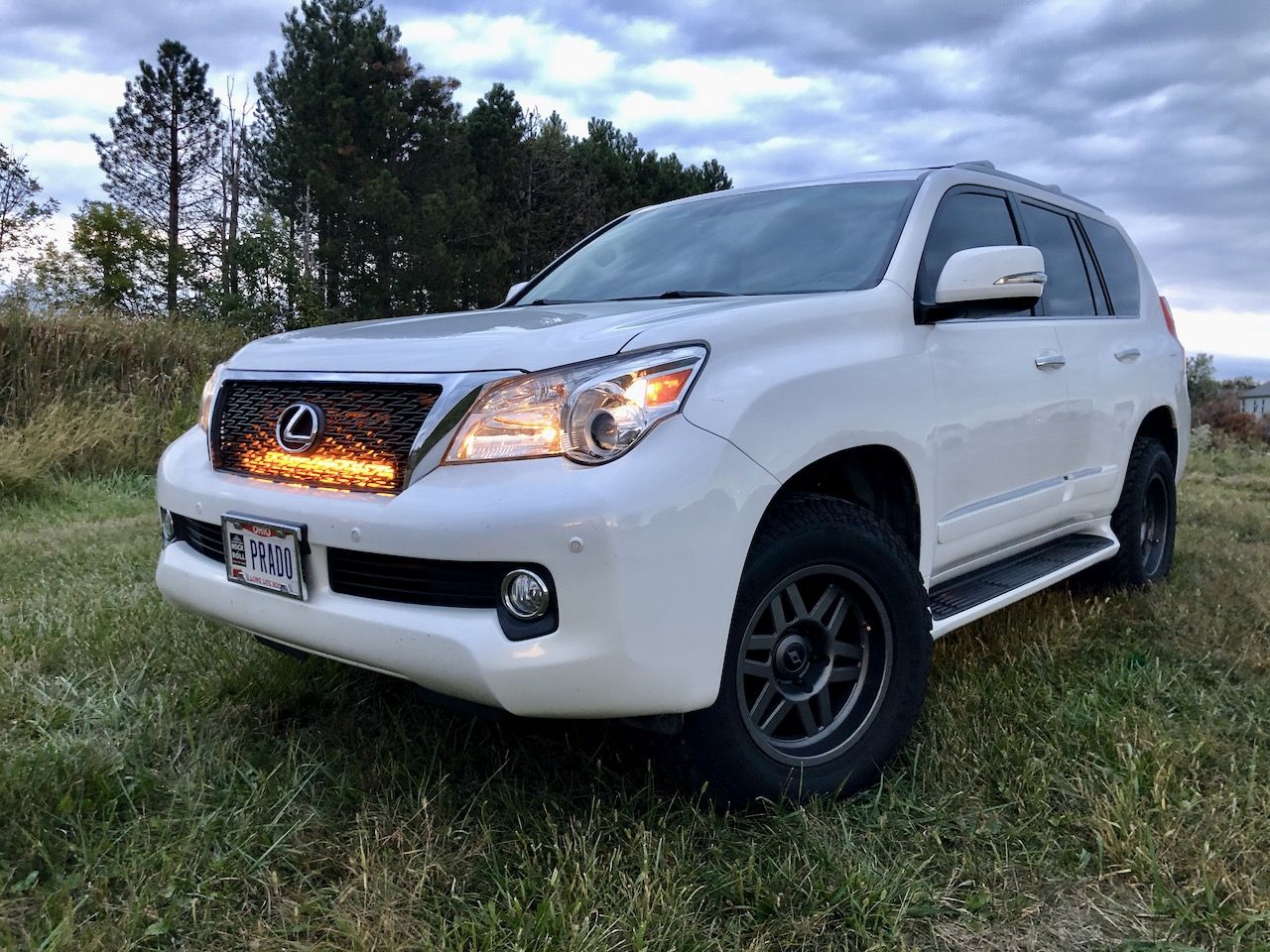

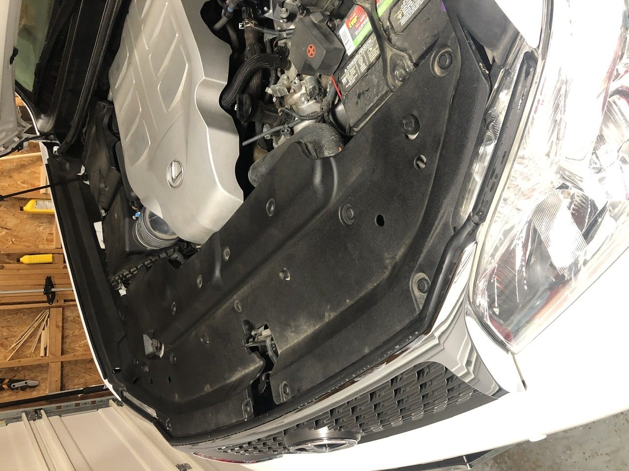

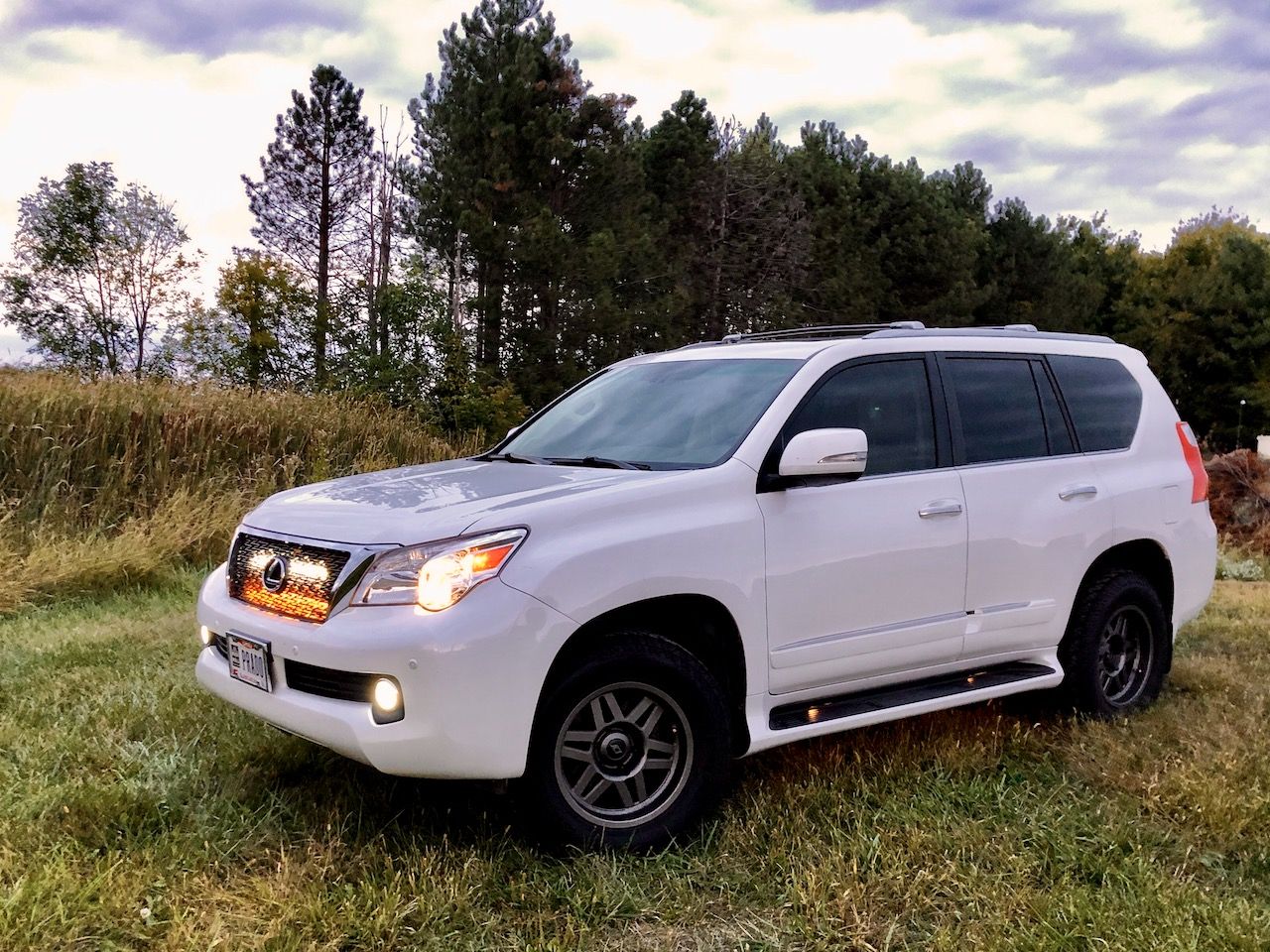

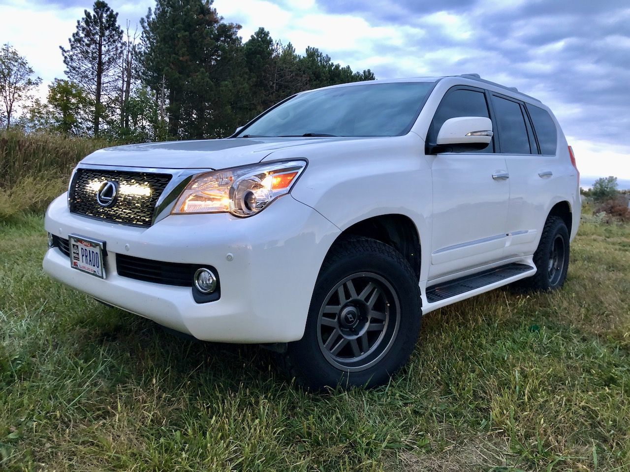

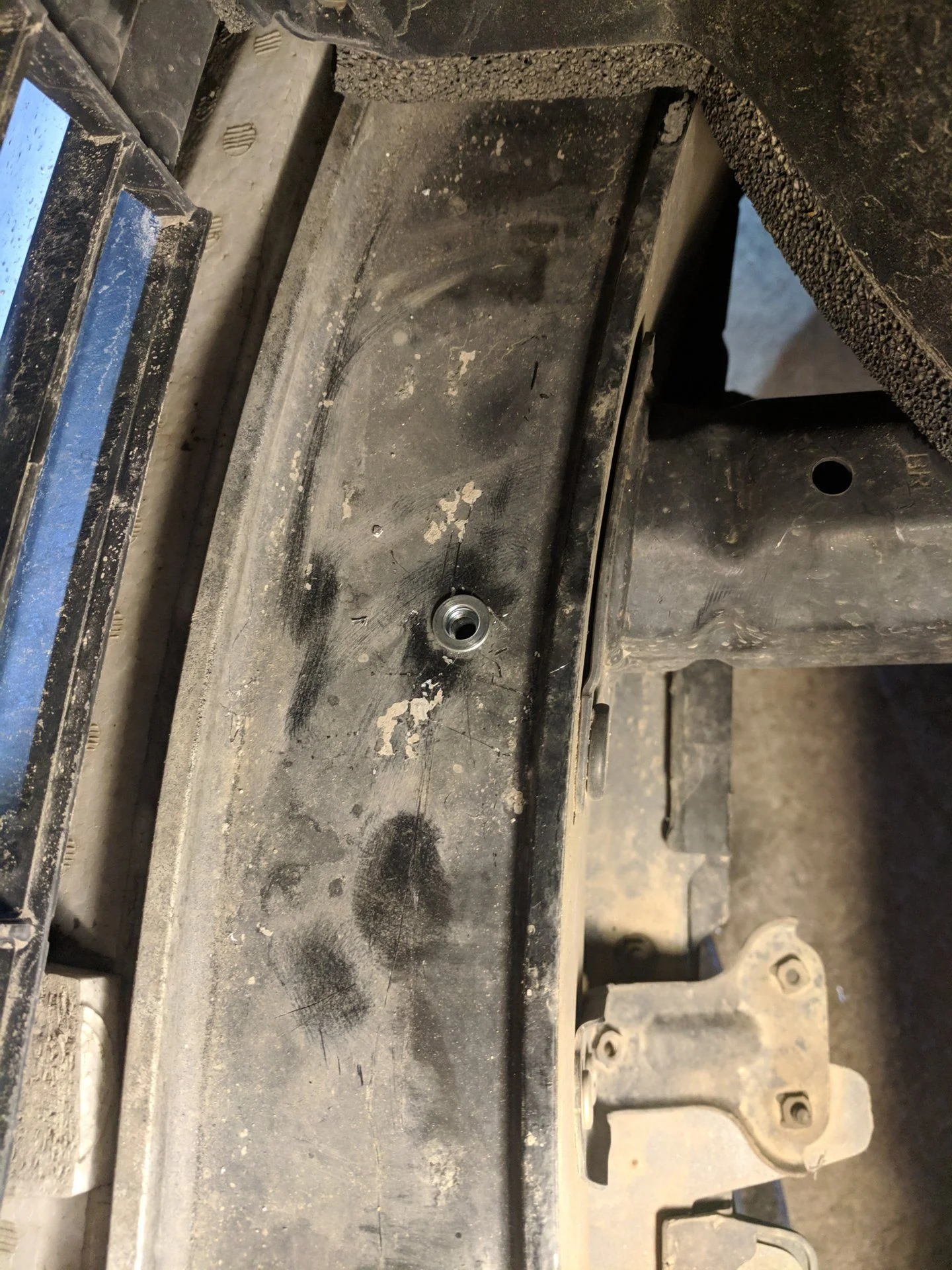

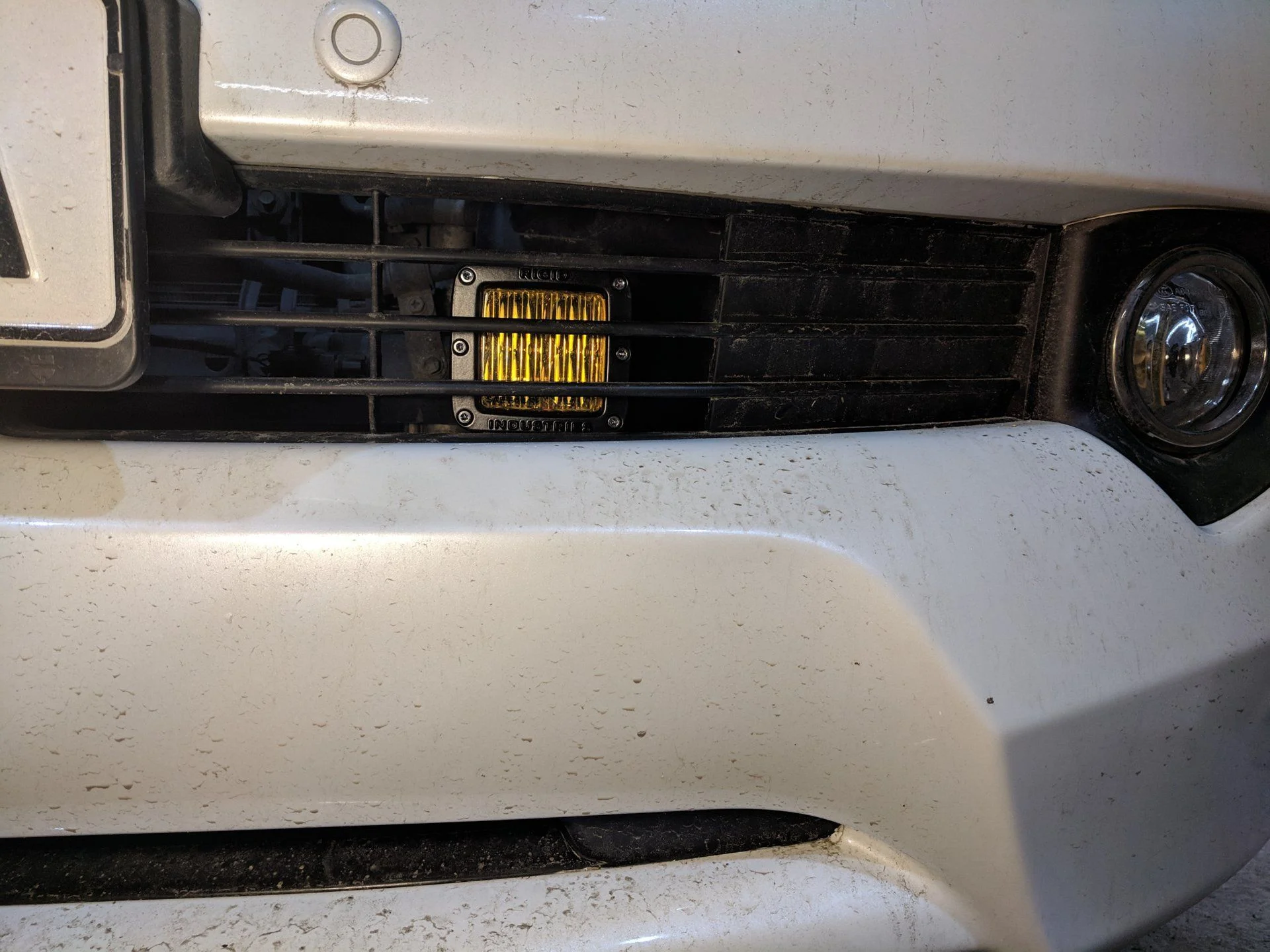

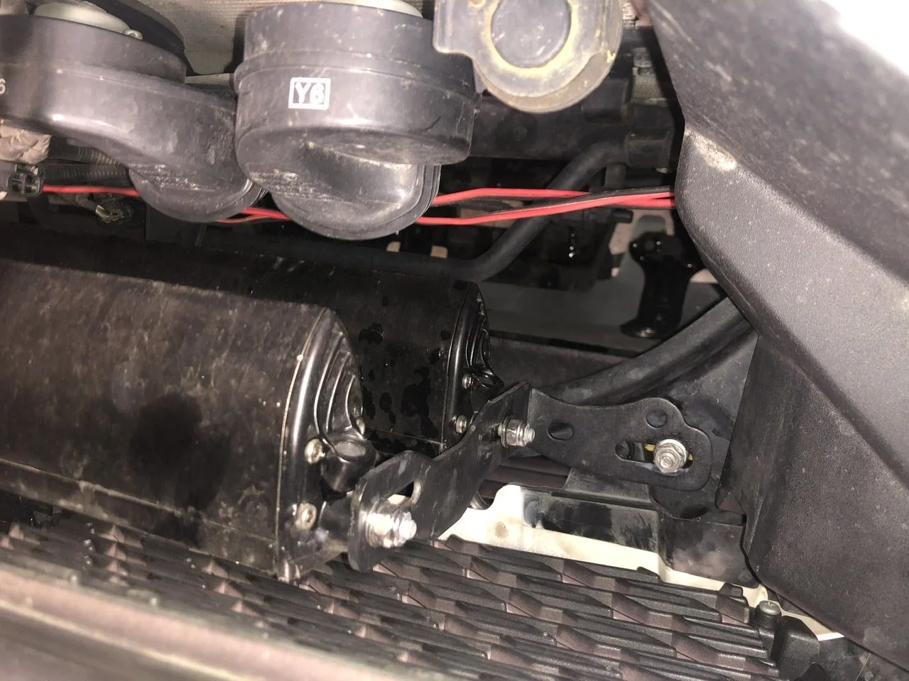

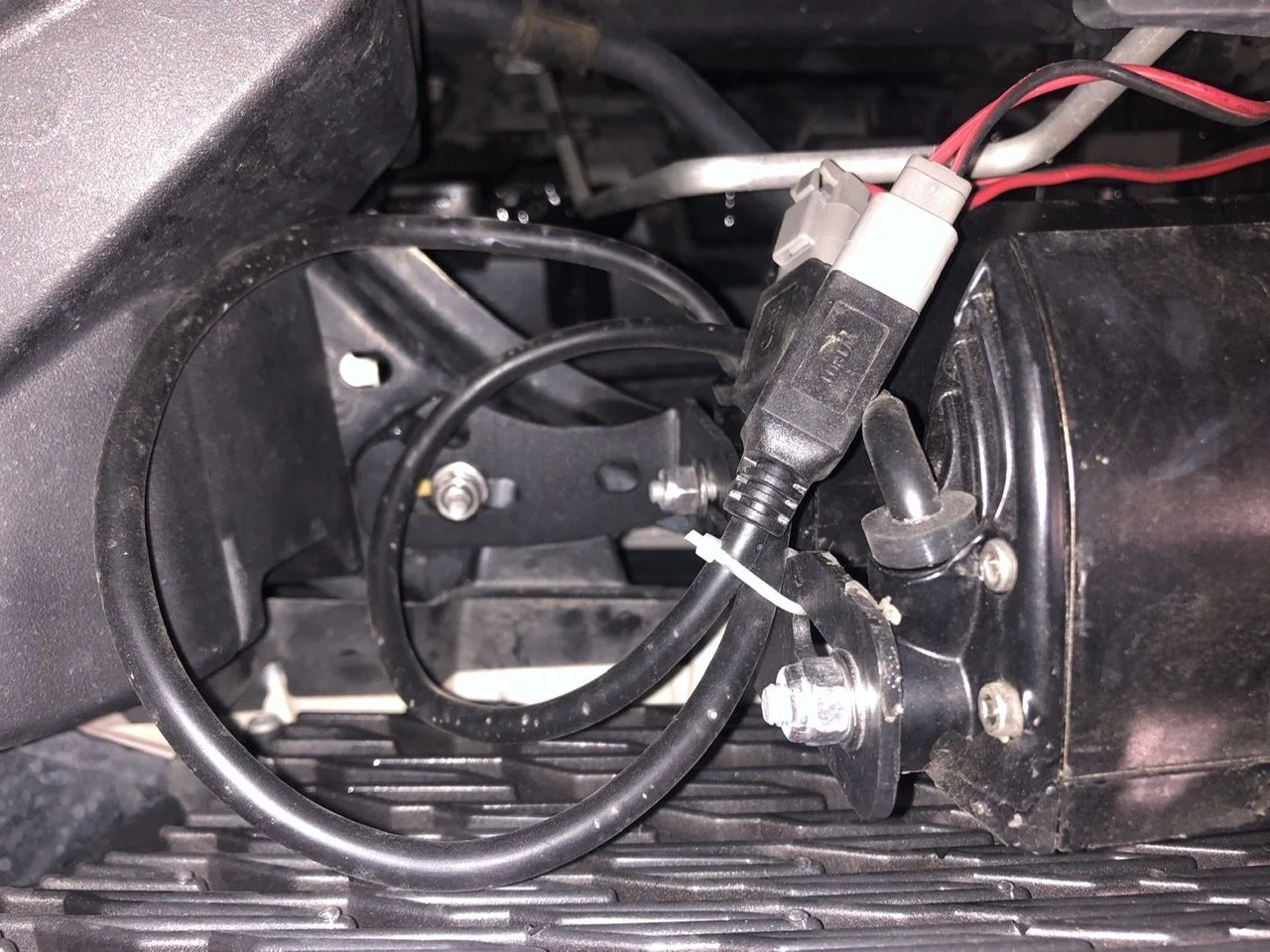

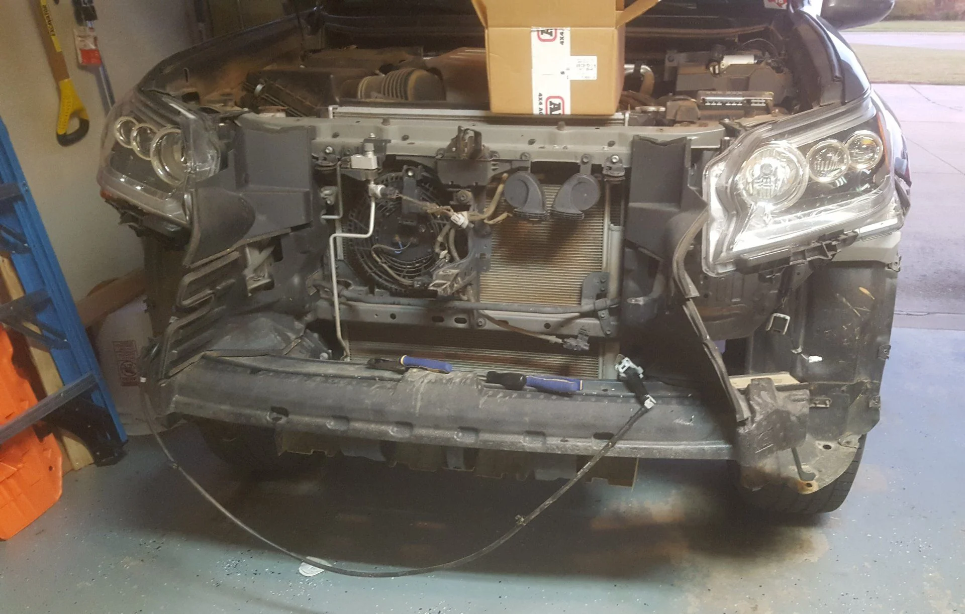

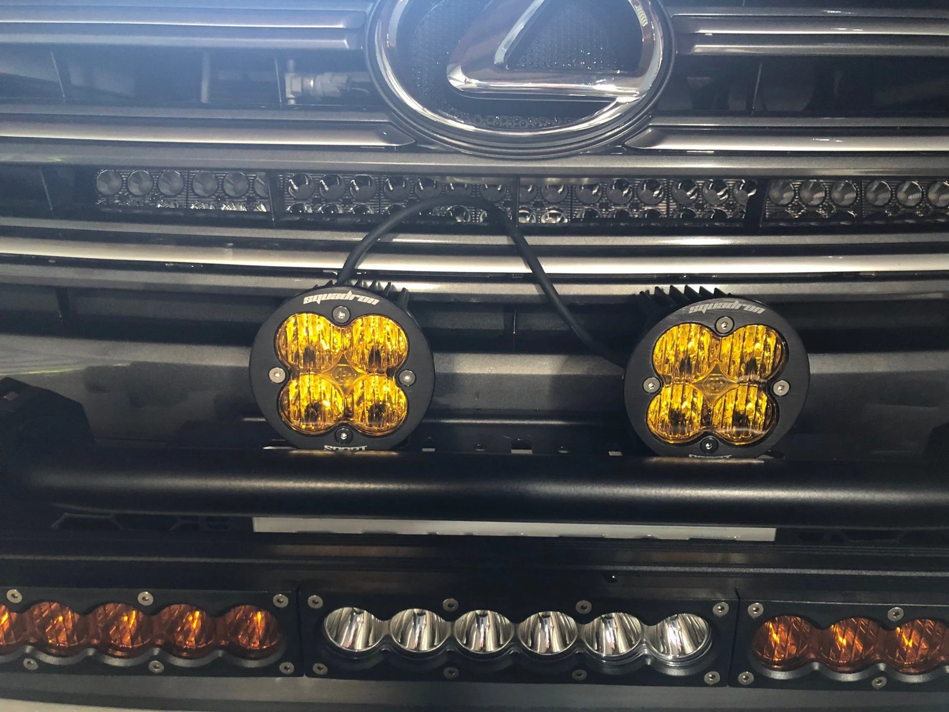

I tried to attach some photos but it’s all from my phone. Let me know if it doesn’t work. Sorry. I had to pull the cover off.
Oh I have 2 Rigid industries single row 20 inch bars back there. I’m 99% sure two double row bars would fit (
Also, what size are the two led light bars you are using behind your grill?
the bracket is designed for them) but I only had single row laying around.
Also make sure you keep that plastic piece under the hood. It forces air through the radiator. The light bars cut down on air flow but I haven’t noticed any issues.

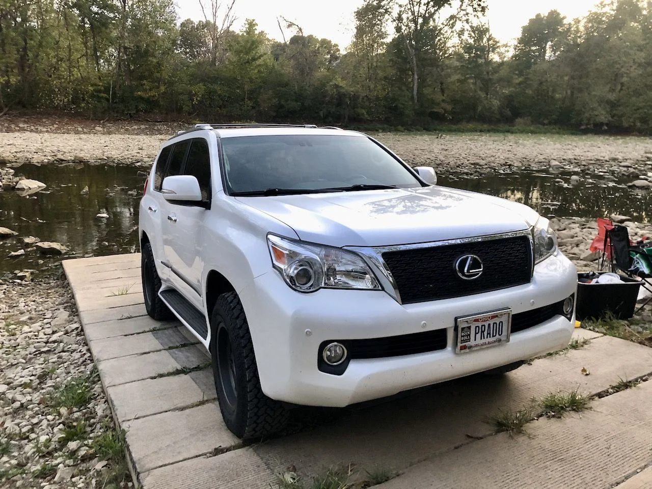

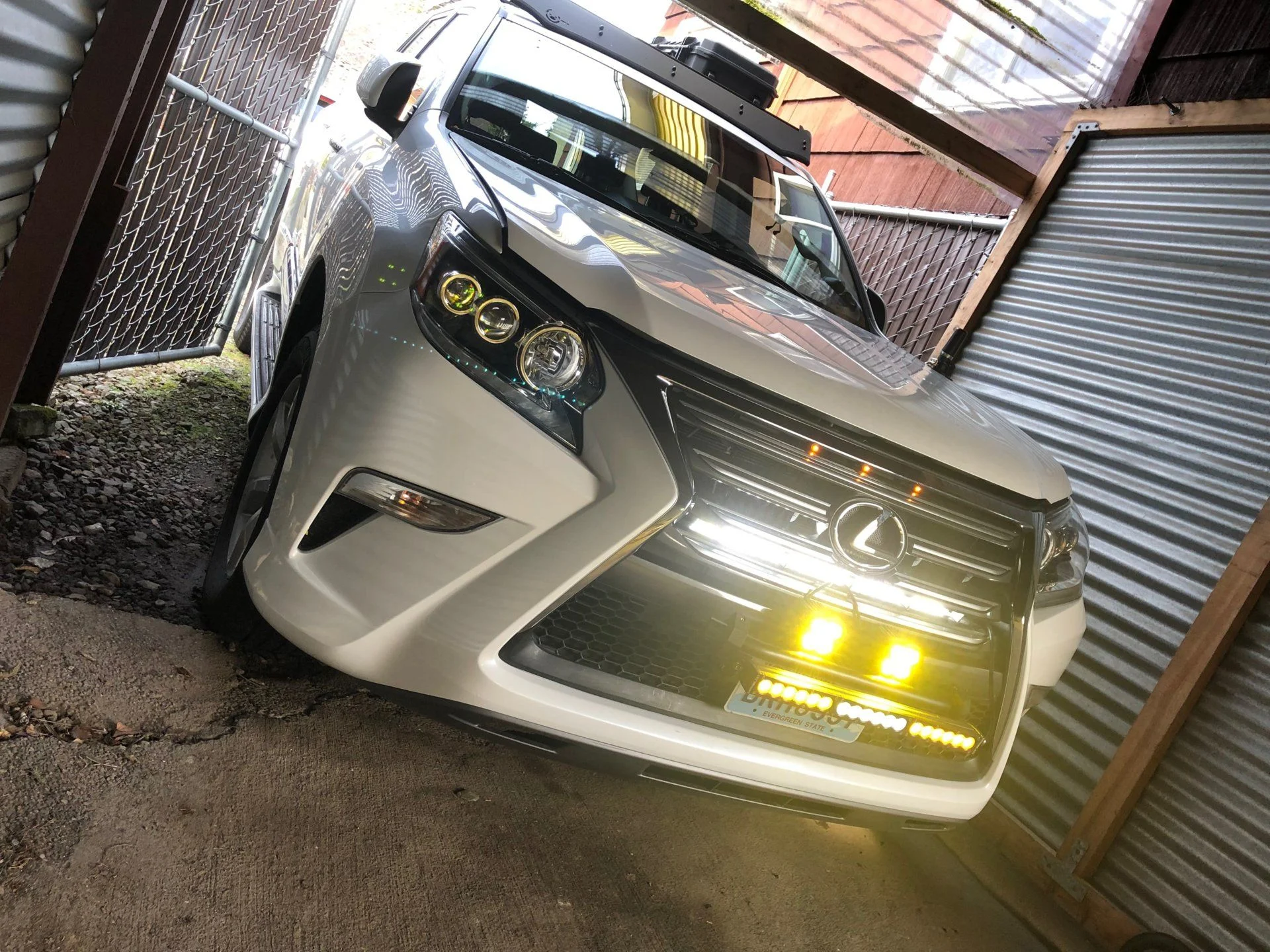

Thanks for the pics and details. Yours really looks nice, also your grill allows more light out. Does that grill fit on a 2018?
Oh I would love to do two light bars with double row behind my grill.
No the grill is for pre face lift only (10-13). I think you could space them right so the bars focus through the slats on the 2018.
