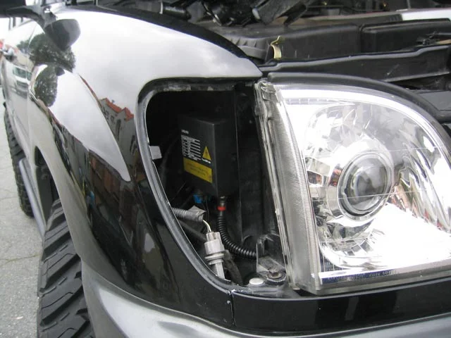

For those doing the retrofit, here is an alternative location for the ballasts.
attachment.php
Those are the exact ballasts I have. I'll get a pic of how mine are mounted in the next couple of weeks.
