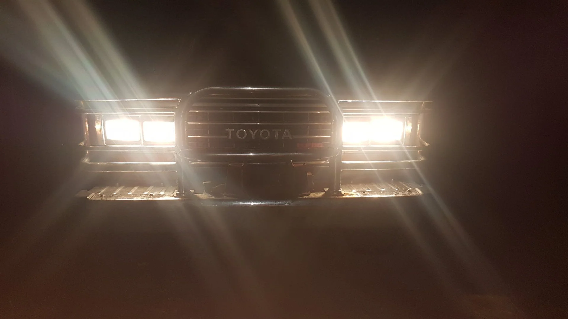

apologies in advance if this issue is in a thread somewhere else but here goes.
1988 HJ-61 JDM started to go solely on hi beams. my initial thought is loose wiring in steering column or the springs in the signal stock. in the meantime, ive adjusted all 4 lenses to act like lowbeams as to not get flashed on the highway, but these H4s are stuck on and draining the battery @ idle.
If they are on all the time that sounds like a relay problem to me.
Can you get low beam when you pull the stalk back? When you do that you get low and high beam together.
there isnt much of a different other than the blue indicator on my gauge clister. the stock pulled back focused the hi beams, but just bareley compared to standard night driving position.
I think this is headlight relay part number.
90987-02007
Is there a cluster of relays up under dash?
