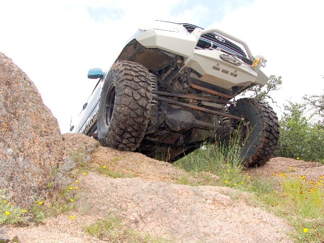

Not a crazy idea at all Christo has that axle under the blue-berry but with a diamond housing way wider than a 58"... prolly more like 63", He has broken the ring gear twice, 4.88s I believe, it hasn't been wheeled that much...
edit: I was wrong 5.29s and 69" wide :)
Really? I've yet (I know that doesn't mean it doesn't happen) to see or hear about a broken SF rear shaft, much less a PP rear shaft.
I broke a rear 100 SF shaft and the front diff of the Blueberry in one go. The front diff is a rear 80 and the 100 is a 32 spline rear. So it can be done :D
