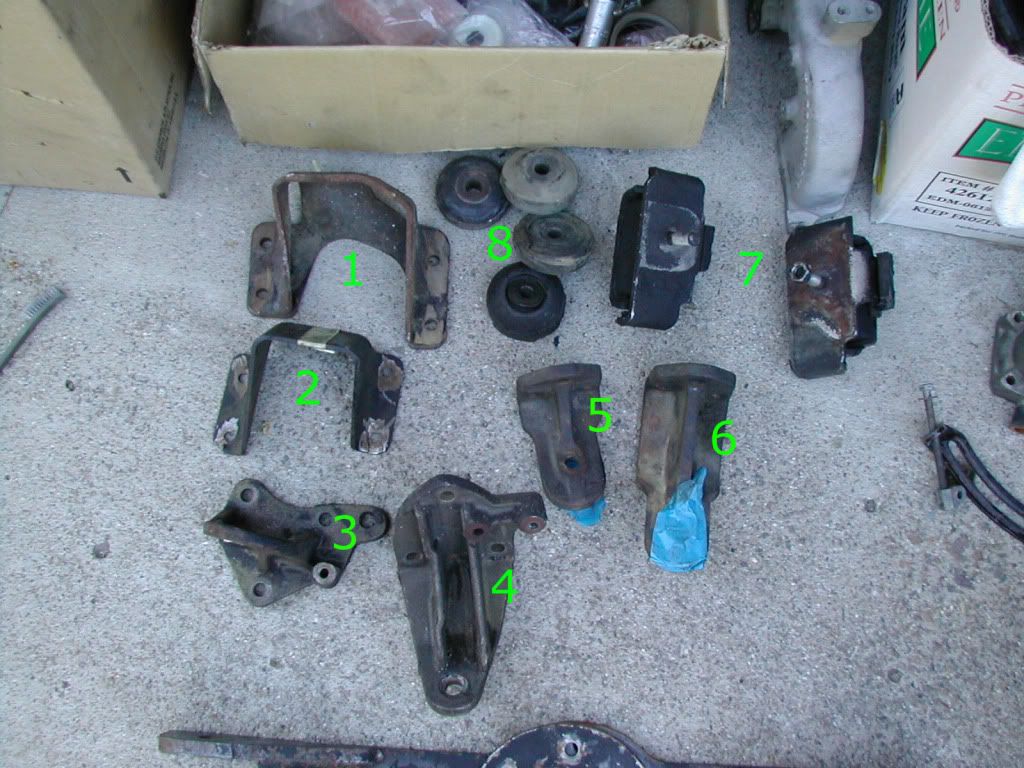

Yeah, you could be right! I took a picture of the mounts I have:
Click image for bigger
I believe 1 & 2 are the FJ40 F Frame mounts, 3 & 4 are bell housing mounts, 5 & 6 are the FJ40 F Block mounts, and 7 & 8 are the rubber bits. Sound right?
The 2F has the large bracket mounts on it already.
I appreciate the help Tim!

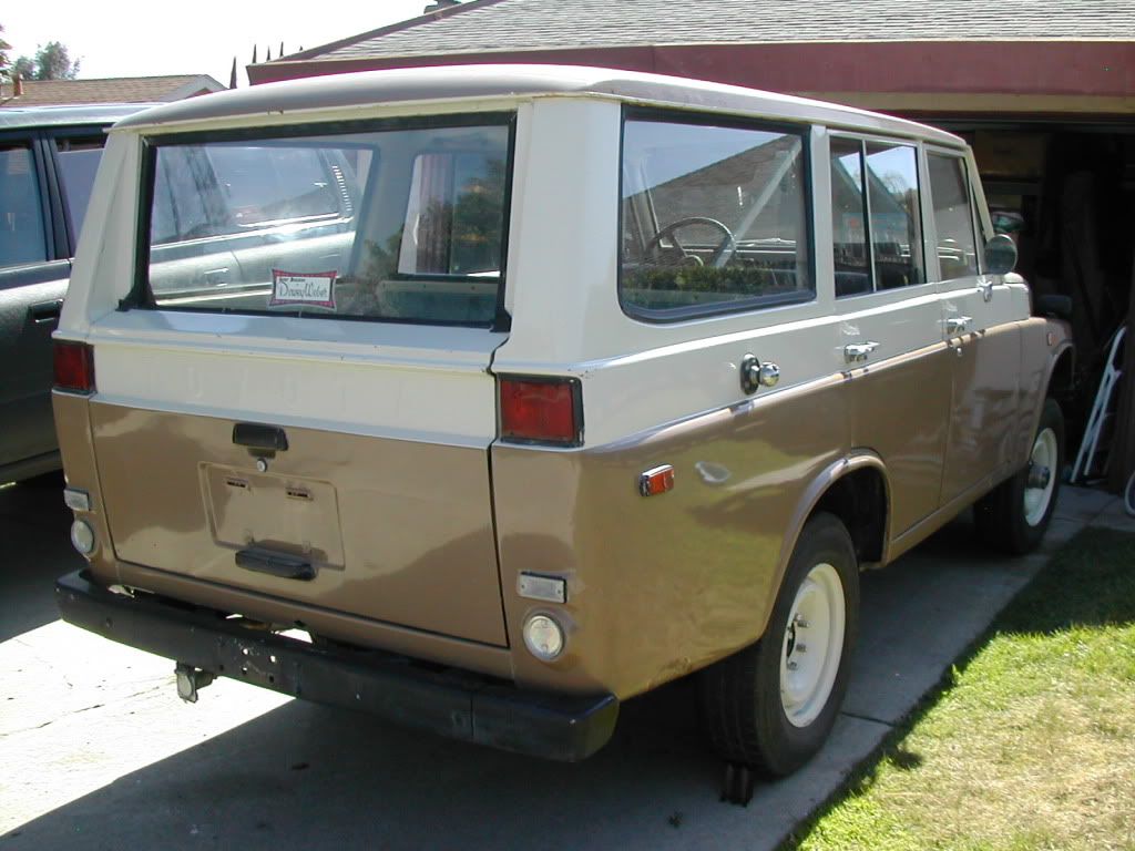

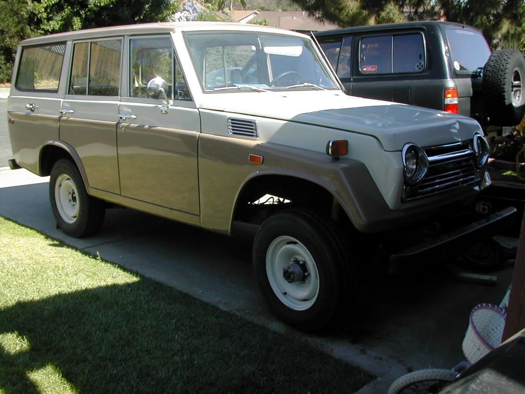

BTW: Here are some recent pictures after a wash . . .
Very nice and clean, love stock pure 55's till they rust then its the run of the swine.
Sweet - I think you have all the correct stuff for mounting the motor to the frame and the rear mounts I removed would complete it. You would just need to weld on a couple of side tabs or a square plate to remount them to the frame.
