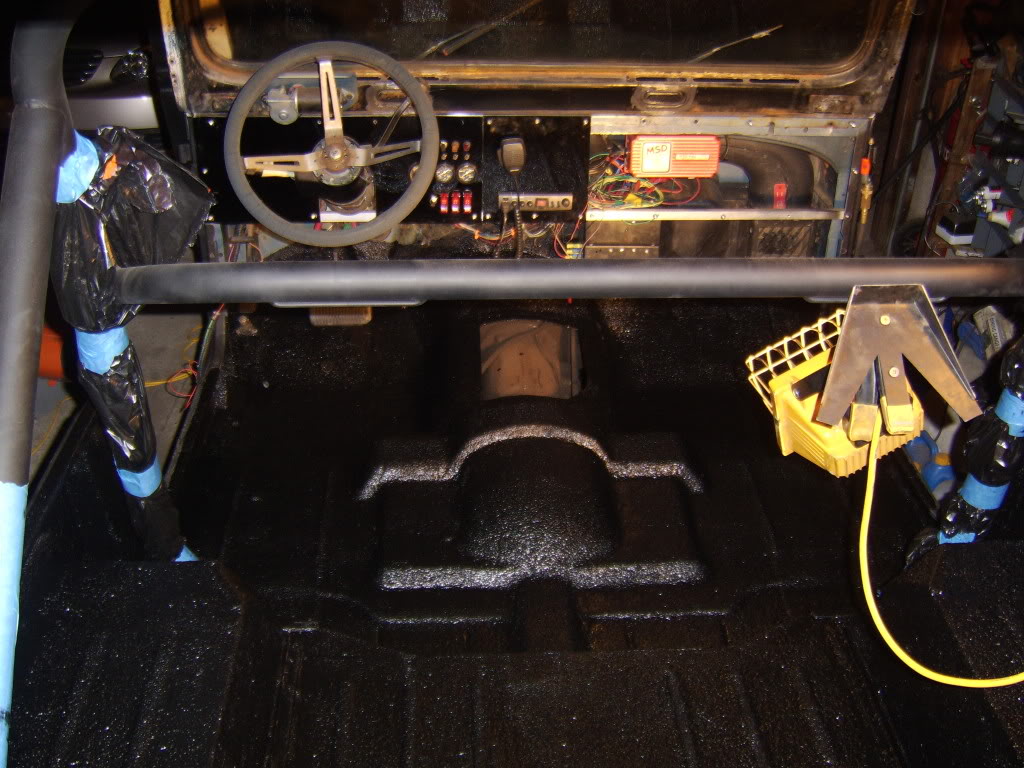

hey fellas just wondering if any one has herculined the inside of there rigs i just did mine along withthe flat bed. It come out slick ill popst picture soon if any one has got any post them too.
I've done this to my Cruiser and a Heep using Herculiner. I had water-resistant seat covers (cheapies :D) and made my dash as water resistant as possible. Nothing like taking the high pressure washer wherever you please on a truck, especially for the seasonal stuff like tracking mud & snow everywhere. It works awesome except if it's exposed to excessive sun (like fenders, quarter panels). After a year in the sun you can see it peeling away from itself. Durabak costs a bit more for the UV stable mixture (120$/gal) but if you're just inside the Herculiner works awesome.
