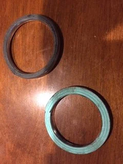

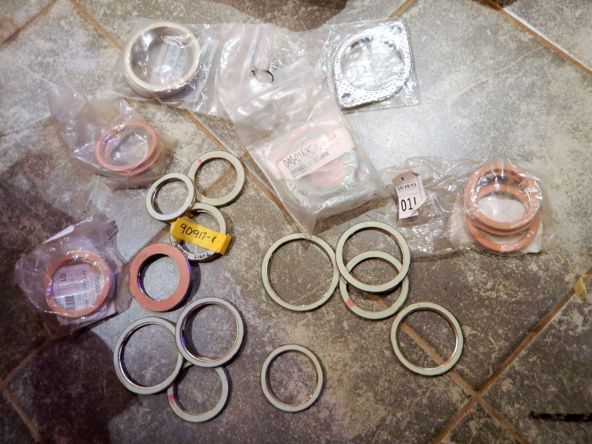

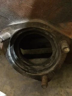

Trying to get the 60 put back together before the weekend after having the head redone. I bought a few exhaust donuts for the manifold, just to have a spare or two incase they blow. They look small and I am not sure how they should seat. One is green and cloth on both sides, one is cloth on one side and metal on the other. They fit up into the manifold fine. I read somewhere else they are suppose to fit over the bottom pipe. Which it it and why are there more than one design?
Over bottom pipe. If not, they gave u the wrong ones, for the Cat end. Happens frequently.
Do not have the part # handy, but felpro makes a good one if you need it yesterday.
The green one, over bottom pipe.
It's the wrong one. It's for the Catalyst conv side.

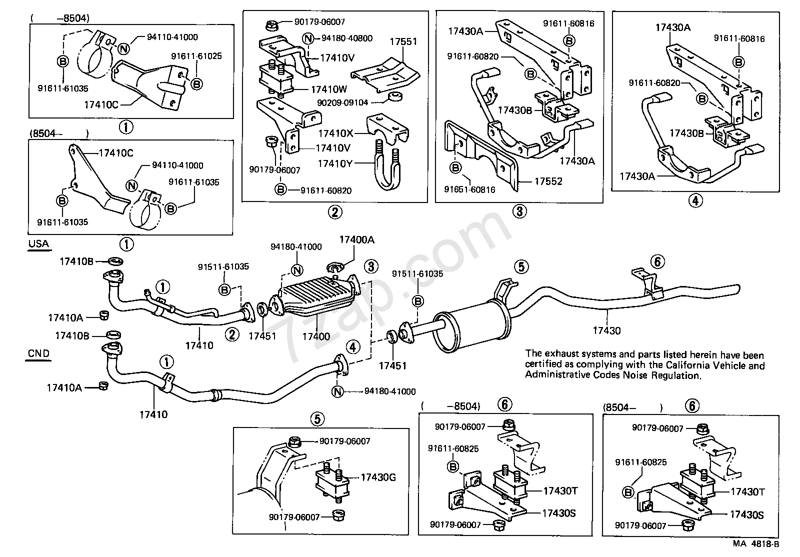

- Here is your Diagram OEM toyota :
- Your call Out # is 17410b / Front pipe to manifold Gasket
- your part # is 90917-06003

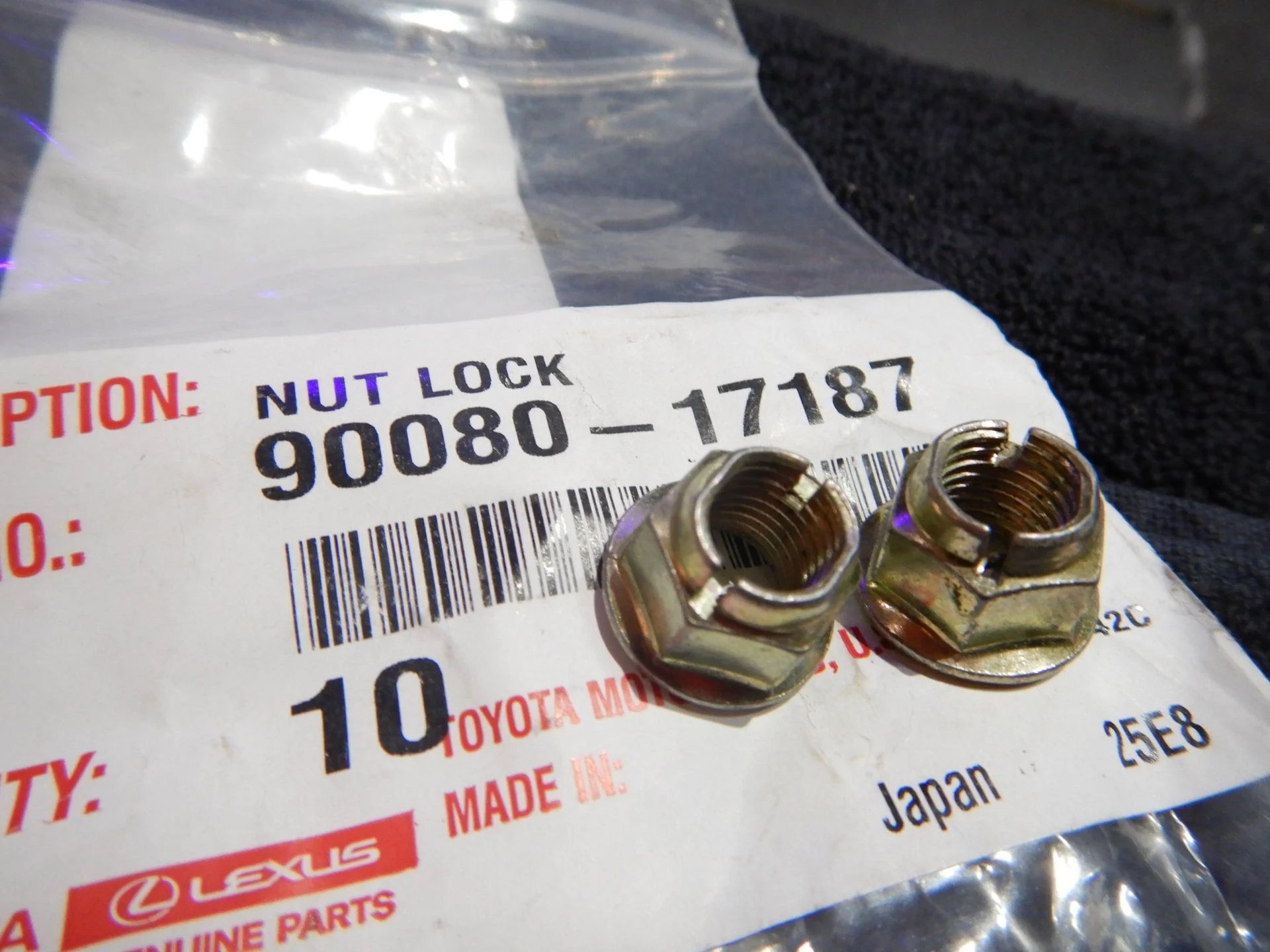

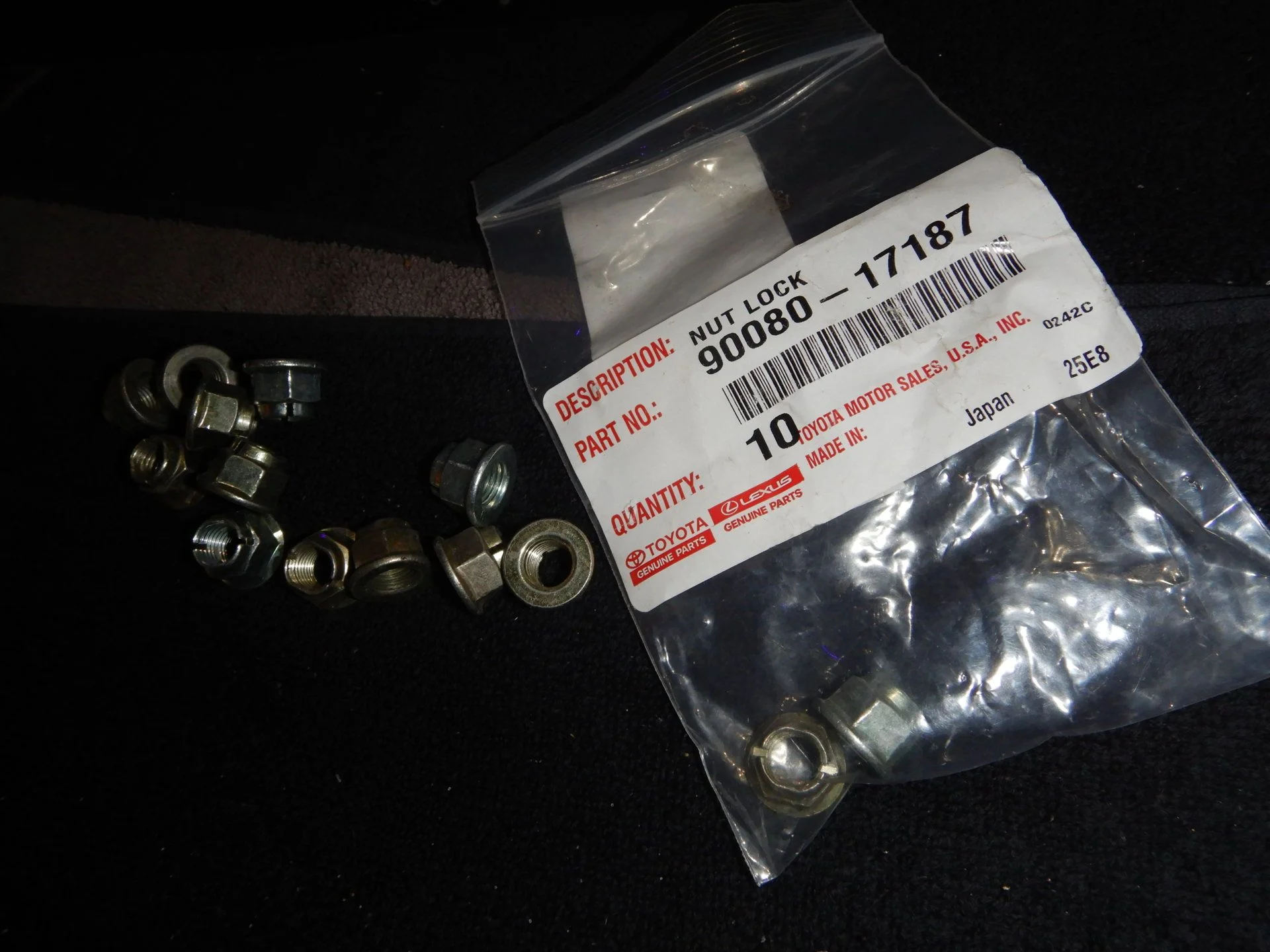

- You also Need qty x 3 New OEM TOYOTA Locking exhaust Nuts part # 90080-17187
- ONLY use this part # nut , this is the best locking exhaust nut TOYOTA has made to date , and it's still made in
JAPAN ...........
- if you dont live near a dealer or dont have access to one , take a accurate measurement of the OD
or outside diameter of your front pipe , and PM it to me , one or more of these is a 90917-06003
i will simply Mail you out 3 nuts and the correct gasket you need , there's NO Cost involved on your end .....
- the measurement needs to be in mm / milimeters please .
btw, WELCOME TO MUD ...................... :)
i will try to help you out in any way i can , to get your exhaust leak fixed .........
Kindly Matt ...

View attachment 2098420View attachment 2098421View attachment 2098422
Now THAT is good service.
@jkaylor83FJ60 ,
Your Front pipe parts are Bagged , Tagged and at the Post office as of 10:48 PM EST
i PM'd your tracking # info to Ya .........
make sure you Tighten & Final Torque your 3 Front PIPE Flange Special Secret Sauce
OEM toyota Locking Nuts i included with your Professional Samples Order ,
in a even Star Pattern , this is Very important step ..............
good luck my friend .
