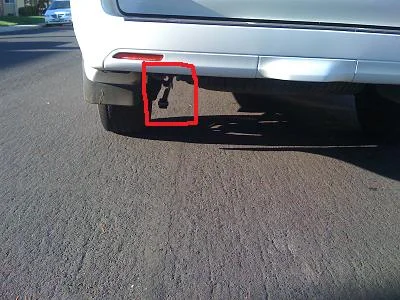

This morning my wife calls and is broken down on the side of the road. She said she was doing about 35 mph, when the car "came loose" and she "fishtailed" a bit - then pulled over and found what looks like a control arm dangling loose? The car is now on a flatbed headed back to the dealer.
My question is how could this happen? Could it be the dealer forgot to tighten it back up after doing whatever repair was done to the drive-line? Do these things just come loose? I don't see how. I've had many vehicles, this one being one of the nicer and to think that it just came loose is puzzling?

This will probably fit better in the FJC or 4Runner sections, as the GX shares the same underpinnings as those 2.
The "clunk" is the common rear driveshaft slipjoint that binds a bit when stopping and accelerating. This is very common for many models of Toyota trucks and SUVs.
The fix or TSB on the GX was a replacement rear driveshaft and also replacement rear lower links on the axle. It seems they didn't torque the bolts properly and one came loose. So it would be best if they double check all bolts/nuts and parts that was touched or replaced for this TSB. Seems like a sloppy tech.
Once they put everything back together properly it will be just fine.
for tech on this platform, toyota120.com/forum has a lot of appropriate info.
The lower control arm bolt - someone outside of the factory messed with it as bulldog-yota said.
Easy for your wife to feel shaken in the GX but this is the equivalent to loose lugnuts from a tire store or faulty brake pad install. installer error as in I bet they didn't tighten it and just had it finger-tight after some TSB as Bulldog alluded to.
IMO, clear dealer installer error and not from the factory or a reflection of the vehicle.
I agree with the other posts. I would talk to the service manager after he looks at your GX. Ask him to have all the bolts retorqued to spec. Glad your wife was not hurt. I would imagine that the Lexus service manager will do whatever you ask so you don't take this problem to the GM. Let us know what happens

I just got a call from the service manager. He believes a bolt was left loose and that caused "the event". He assured me that the shop foreman has personally torqued all bolts in the undercarriage and nothing looks to be damaged. A detail and full tank of gas and it will be ready at noon.
I expressed my concern over future issues with the vehicle due to the event and he said that what happened will be in the paper work and that it was their fault. He suggests I take great comfort in this because if there is an issue in the future - it will be taken care of at any Lexus dealer in the world. I also asked that they both speak to my wife and assure her that it's not quality of car issue but a people issue.
