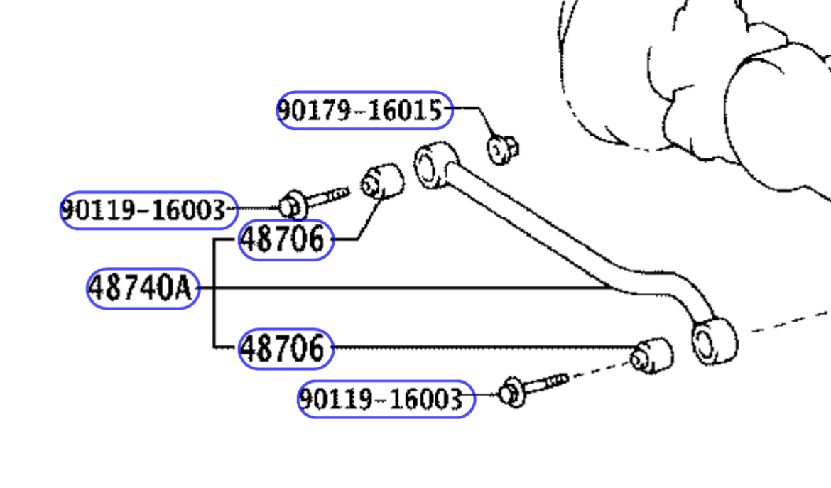

Driving my 1997 80 series yesterday when I experienced an issue with 'Death Wobble'.
Found the likely reason (Front Panhard bolt and nut missing). Can anyone confirm these numbers are the replacements and suggest where to find them for purchase? Thank you in advance. Bolt: 90119-16003 and Nut 90179-16015
Same as the leading arm, BTW
Those are the part numbers that I have from when I replaced those bolts and nuts (same on both ends). I think I bought them from Partsouq as part of a much larger order. If those are the only parts you need, then it’s probably cheaper and easier to get them from Cruiser Outfitters.
Good to know that the botls from the arm and panhard are the same, for a field expedient repair, for oh say, one of those times when your bolts falls out.
