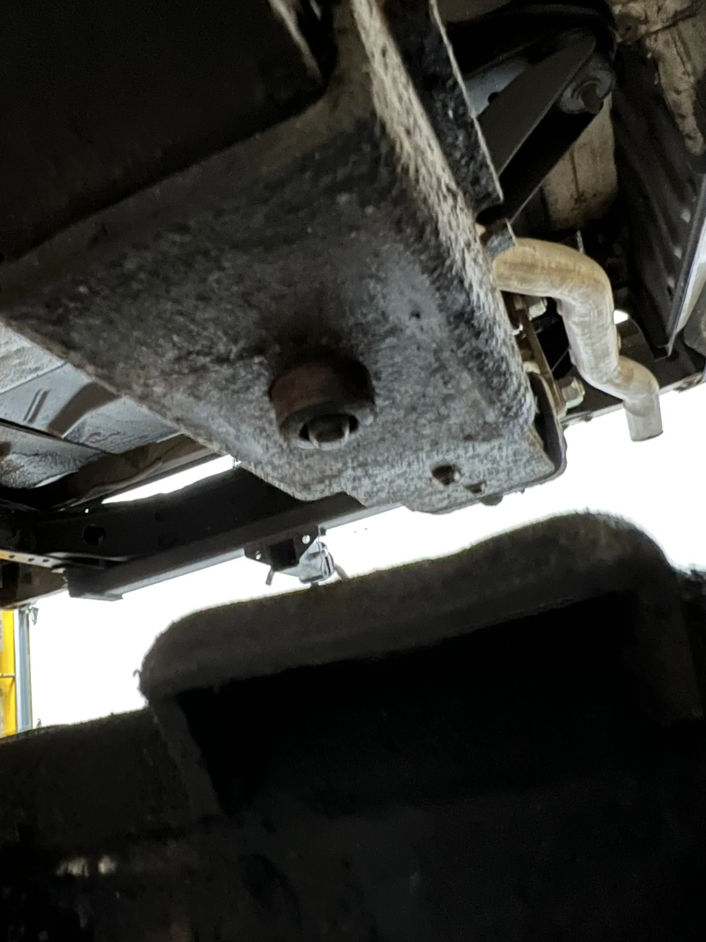

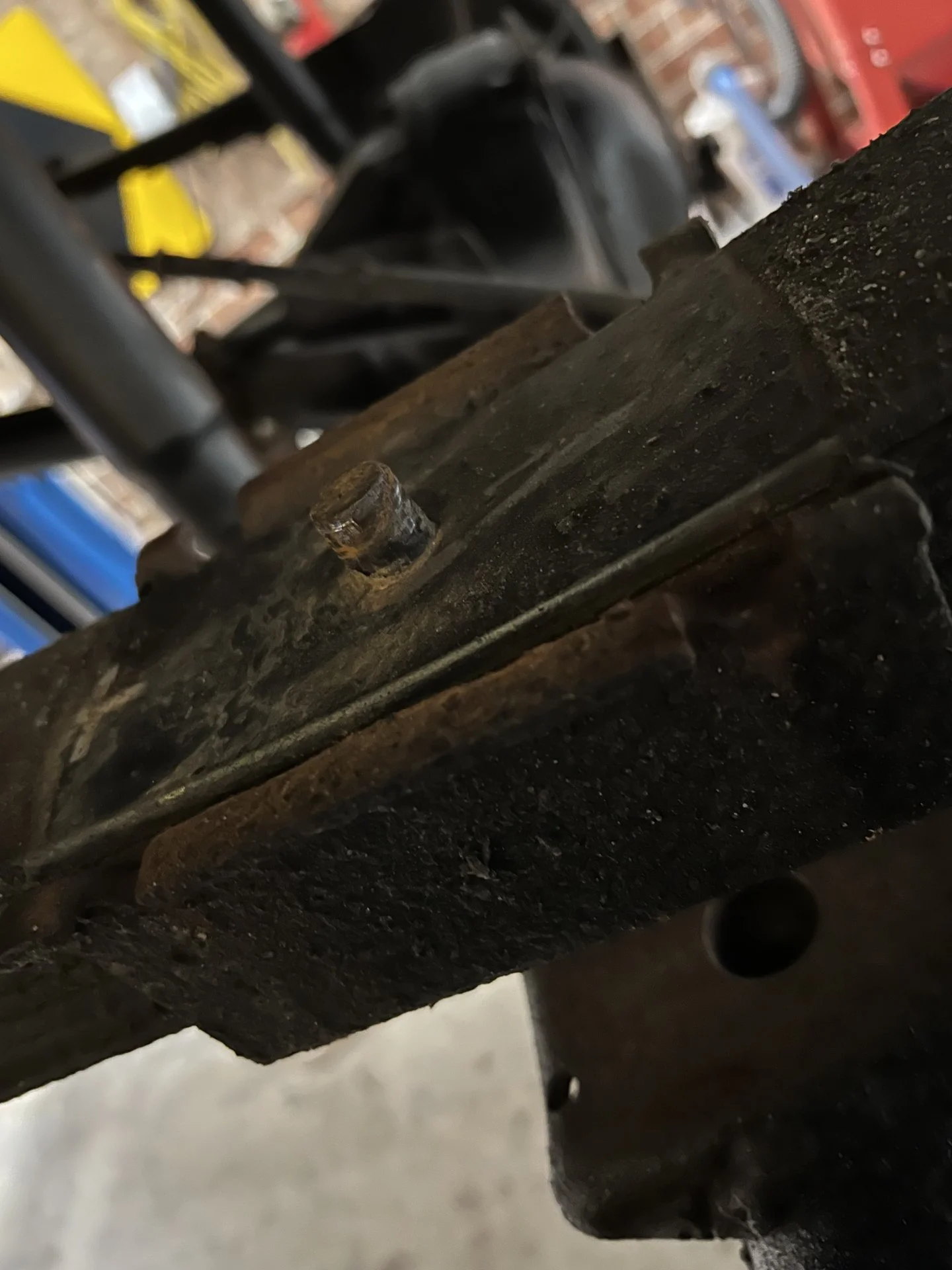

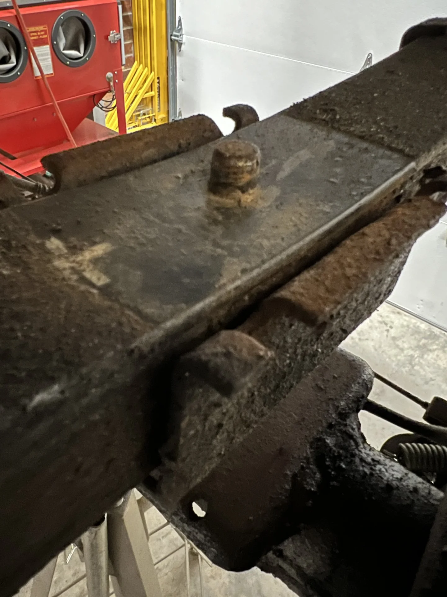

any suggestions or methods to remove these center pins?
it looks to be threaded underneath. cut the top off and drive thru?
Pry that metal bottom retaining cup off so it's just the leafs. Then you'll see a nut underneath that metal piece.
Compress and secure the leafs with a clamp or something similar since they'll expand and release tension when you remove that pin.
Then unscrew the nut while putting a set of vice grips on the top and it should break that nut loose and then the pin can be pulled through.
