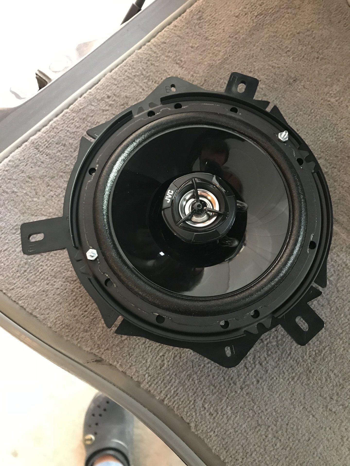

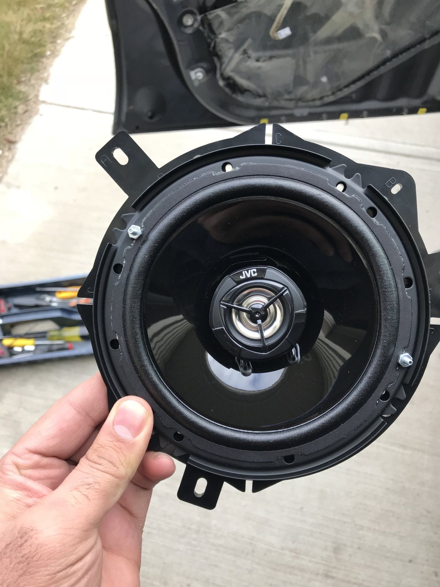

I used the existing bracket and screwed the speakers to it. I had to cut off two little plastic tabs and then the speakers sit flush.

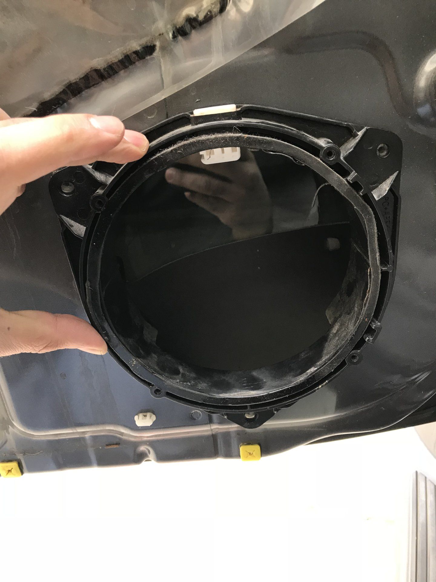

Can anyone confirm these are OE speakers? When I dug in, it was obvious I wasn't the first one to remove these speakers.. which is odd - I bought the truck when it was 4 years old with 39,000 miles. Anyway... does this look factory?

I played Crutchfield's fit game - enter the car/year, etc... but I'm seeing 5 1/4", 6 1/2", 6 3/4" and 2 ohm, 3 ohm and 4 ohm as options. Maybe on the size - just fill the hole with a mounting bracket. But the ohms? Surely there's an optimal impedance for the factory stereo/amp
