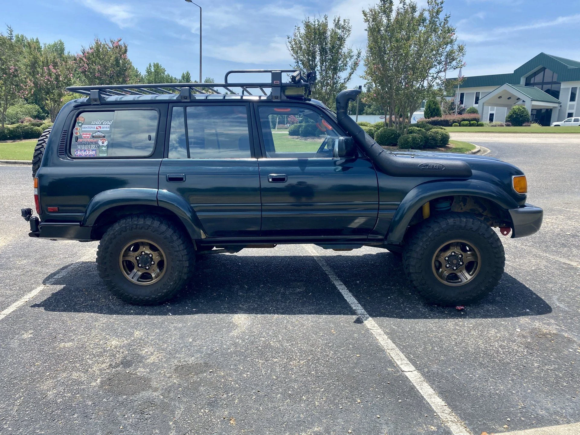

Hey guys I'm looking to de-mod return my 93 fzj80 to stock because its more of an overlanding rig and climbing up rocks. I'm moving from 315s to 285s and currently sitting on 2.5" dual rate dobinsons lift. I'm fairly confident I can reuse the shocks but looking to do a stock height spring (Like OME ect) and remove my 2.5" land tank caster brackets. I have a rear tire carrier, stock front bumper and putting the winch inside the front stock bumper (Stuff to be added will be a front bull bar, sliders, & drawers). The roof rack is coming off. Do you have any suggestions or anything to be weary of? I want the ride to be level as this was stink bugging pretty bad the entire time I had it. I'm open to suggestions on stock height springs - I don’t want to keep the lift going to 285. The exact model shocks and springs on the FZJ80 are:
  • C97-146VT: 2.5" Variable Rate Front Coil Spring Pair (Link)
  • C97-147VT: 2.5" Variable Rate Rear Coil Spring Pair (Link)
  • GS59-683: Shock Absorber Front 0-3" Lift (Link)
  • GS59-682: Shock Absorber Rear 0-3" Lift (Link)
  • SD59-824: Steering Damper (Link)
  • Landtank 2.5" Caster Correction Brackets (Link)
Current suspension, weight, & tire setup:
Edit: My contribution to this thread is if your truck is outfitted like mine this is how the lift will look.

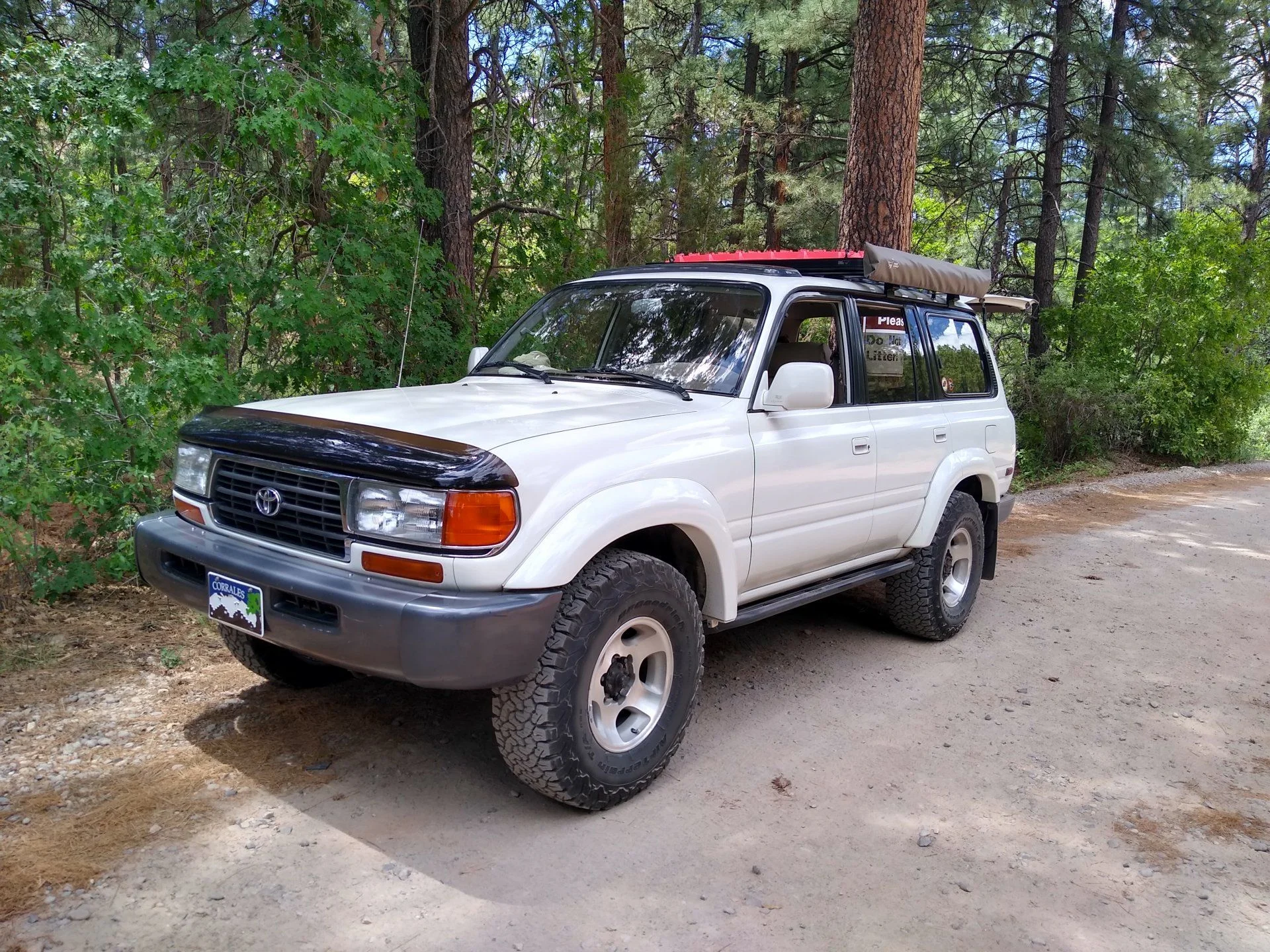

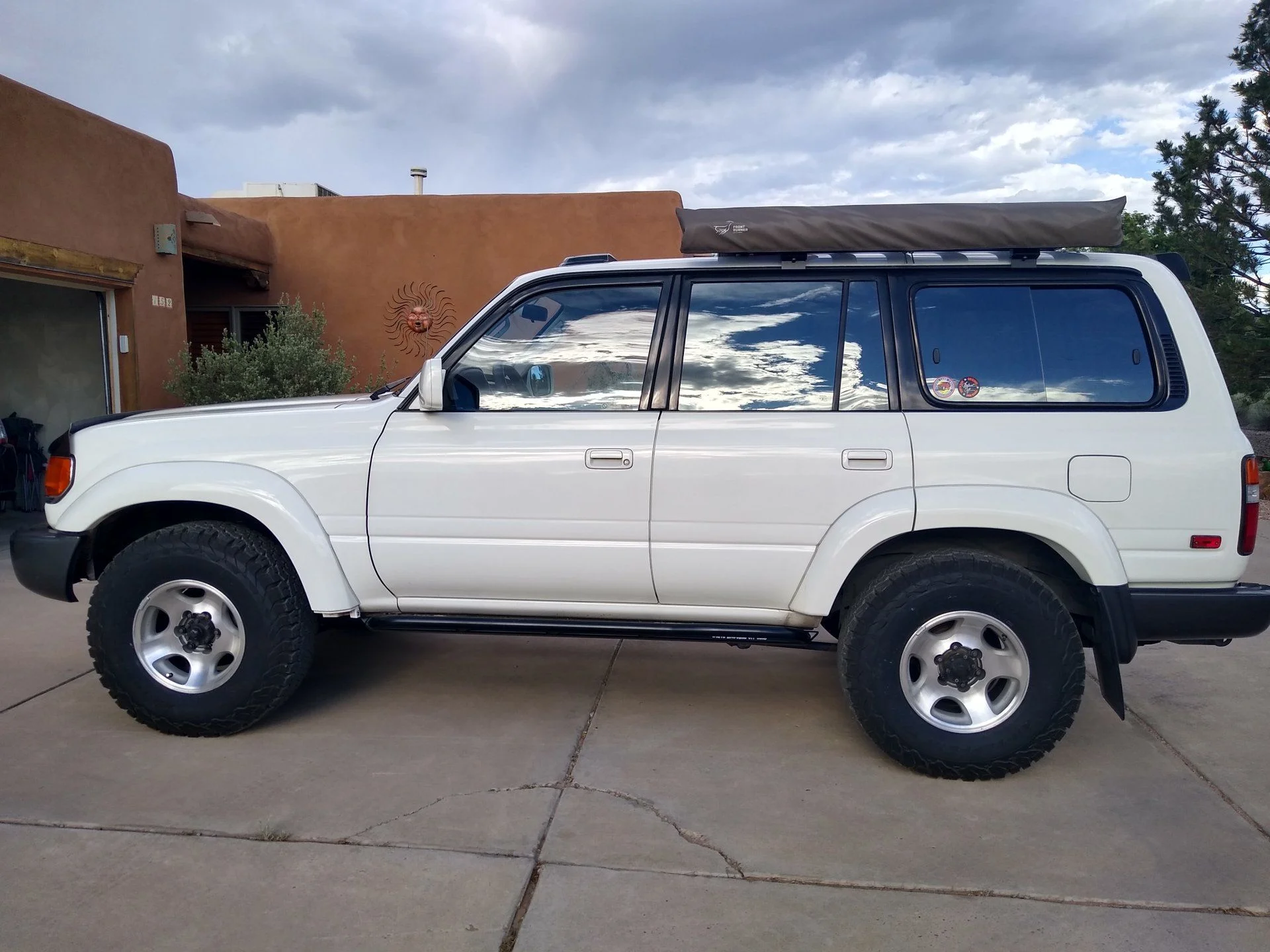

I've got the OME stock height coils. Running OME Nitro Sport shocks up front and OEM Tokicos in the back. With the weight you're talking about, this should work pretty well for you. I also added air bags in back, because we tow sometimes and get loaded for camping, too. Being able adjust ride height with the bags is a good thing and can help dial out the stinkbug to suit the needs of the moment.
This is how it sits pretty much MT (except I have a sleeper/draweer system in back you can't see that adds several hundred pounds) with 10 PSI in the air bags (5 psi is the minimum required inflation.)

The stinkbug was a reference to if I replaced the springs wanting to avoid it. I’m removing the 315s in favor of 285s and I don’t want 2.5” of lift if I’m running 285s. I want the springs to ride around stock height and support the weight I have now/intended weight. The weight shortly going to the front is around $150.
In your picture it looks like the rear is riding lower than the front. I thought that was what you are referring to. I get the desire to go lower when running 285's. I still think making changes before you add your front bumper, winch, drawers, etc. is a mistake. You may find you need a stiffer spring setup with the weight for your type of driving. On road handling might feel lumbering and you find you're bottoming out on your bumpstops offroad. Giving it a 1.5" - 2" lift over stock with your weight will have it all settle in closer to stock. I like the idea of adjustable shocks and/or airbags for your use. I think it would give you good options.
