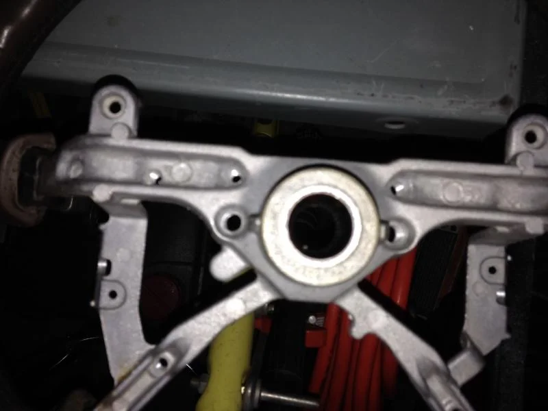

The All leather steering wheel on my 1999 Lexus LX is in pretty bad shape. Too much sun and hand "grime" over the years has caused the leather to crack. Anyway, after searching for some time I found a used OEM wood and leather wheel in perfect condition. The seller said the wheel fit land cruisers and LX 470's 1998 to 2002. Used wheel arrived and it appeared to be a perfect match until I started to slide it on. The outside diameter of the center of the wheel that slides into the bushing connected to the clock spring is too big. It also has 3 ribs where my Lexus has only two. Anyone have any ideas how I can make it work? Thanks!

OK, Here is what I found out at the Lexus Dealership; my 1999 LX has a production date of 09/1998 and there was a "running" production change during for the 1999 model year. So, the wheel I purchased will fit LC and LX models produced in 1999-2002. Furthermore, the problem fitting the new wheel isn't with the clock spring (Lexus calls it a spiral spring) the problem is with the combo switch behind it. The good news is that the newer combo switch is a direct replacement for my 1999 LX (with a 1998 production date). The bad news is the dealership wants about $800 for the new switch. I might find a better price online. Also, the combo switch is modular; meaning the turn signal and wiper switches "unplug" from the combo switch's center piece. The center piece houses the bushing that the newer steering wheel fits. This bushing rotates with the steering wheel to register the wheels position with the POS sensor. Also, it appears that my turn signal and wiper switches will work with the newer combo switch center piece. So, maybe I could find a used combo switch or center piece. Does anyone have a recommendation for LC or LX salvage parts?

Well I hate to call BS on myself, but it may appear I received bad information. I took the wheel back to the Lexus parts department today, looking to see if my steering wheel position sensor would work with a later model combo switch parts. This time the parts manager was there. He confirmed there were "running" changes during the model year, but that the parts were still interchangeable. Then he had a brilliant idea, "why not look up the part number on the steering wheel you purchased on eBay" Duh! Should have done this earlier. Turns out the part number stamped on the wheel (45103-30240 B1) is from a 1997-1999 Lexus LS and their system says the wheel is not interchangeable with the LX470. Sounds like the game is over. FYI: I paid $500 on ebay. If it would have worked, it would have been a really good deal as the wheel is in near new condition. Real burl wood!
