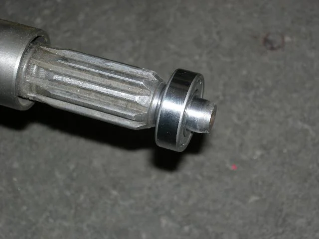

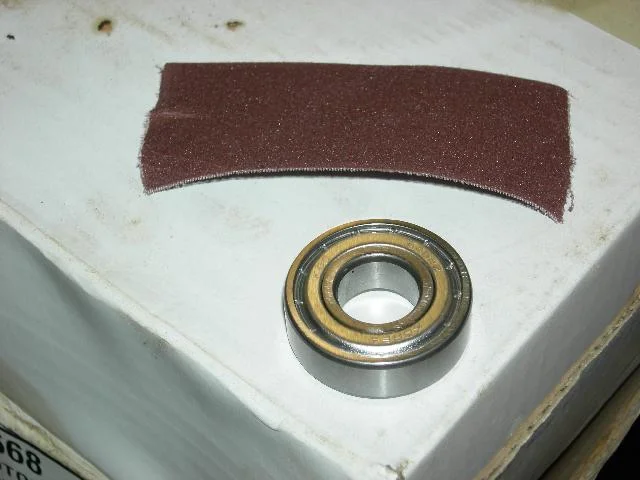

So the flywheel is in and the new fasteners are torqued. Before installing the pilot bearing, I always make sure that it is a slip-fit on the end of the transmission input shaft so as to avoid any binding while installing the transmission into the clutch and flywheel housing. I just use a piece of emery cloth and lightly sand down the input shaft.
After the pilot bearing is a slip fit on the input shaft, it is then installed into the end of the crank shaft. After it is seated, I put a dab of anti-seize in the center of the pilot bearing where the input shaft will be touching it.
