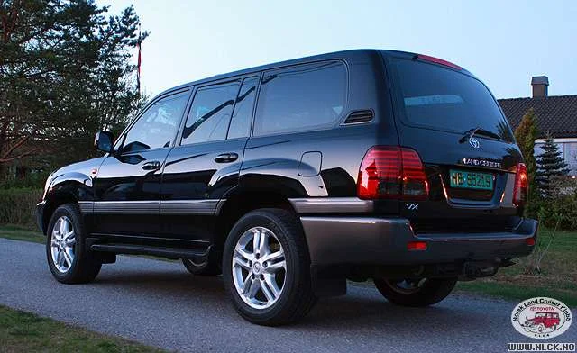

You can use 20" Land Cruiser/Lexus wheels on the 100 series, se picture.
I guess the 18" wheels also fit, they have the samme backspacing.

Excellent.
