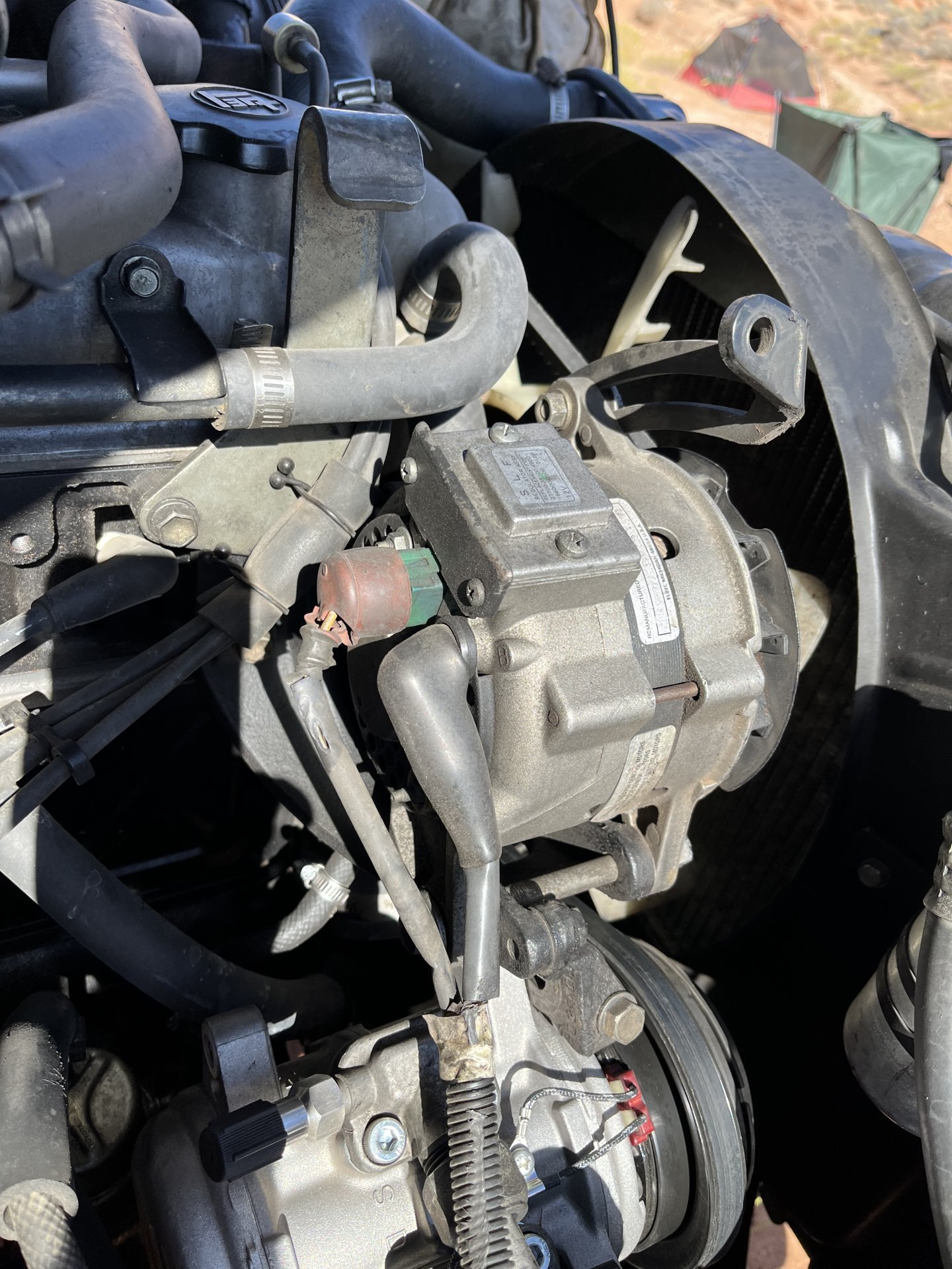

My alternator is slowly dying on my 1987 FJ60. It will charge a little unless there is a large load like headlights on. Worried it won’t get me home tomorrow, 5 hours north. No parts houses have them. Waiting for the parts houses in Vegas to open up. If I have to make the 2-hour trip I guess I’ll do that. Hoping there’s someone out there in the St George area who might have a line on a used one. Or ideas on how to possibly revive the one I have. It’s only a couple years old, maybe 30k miles, an AC Delco I bought from Rock Auto.

My alternator is slowly dying on my 1987 FJ60. It will charge a little unless there is a large load like headlights on. Worried it won’t get me home tomorrow, 5 hours north. No parts houses have them. Waiting for the parts houses in Vegas to open up. If I have to make the 2-hour trip I guess I’ll do that. Hoping there’s someone out there in the St George area who might have a line on a used one. Or ideas on how to possibly revive the one I have. It’s only a couple years old, maybe 30k miles, an AC Delco I bought from Rock Auto. View attachment 3105763
With a 2F you should be able to run 5 hours with a flaky alternator if your battery is well charged and you don't run the AC and fan. Alternatively, instead of sourcing an alternator that may or may not fit properly just pick up another battery as a back up if yours dies on you during the trip.

Not the same. A 3FE alternator can be made to fit in the 2F spot but it's not a direct drop in.
NOBODY has an alternator. Not even in Vegas. So I dropped the battery off at Napa. They’re going to get a good charge on it, and the hope is a weak alternator with a strong battery will get me home tomorrow 🤞🏼

I don't know if they will be open Monday but I would try to contact interwest rebuilders in St. George. They rebuilt the alternator on my 91 fj80 with no problems. They have been around forever and I am sure they could get you rebuilt and running.
