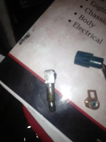

Hi, just broke this part trying to change a hose. The spigot rusted and just snapped. It is the brass one that had the jagged end.

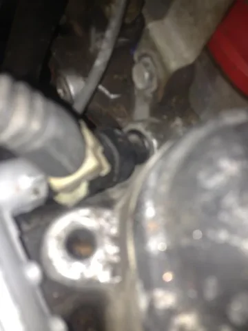

85 4runner and yes it's next to thermostat housing.

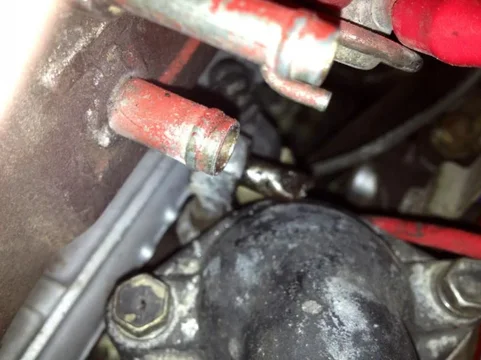

Here are a few more pics to clarify where and what it is.
Good thing it broke when pulling hose off as what ever this thing is, is totally clogged with rust and such.
If anyone knows a part number please post us as the dealership has already given me the wrong part. They gave me a hose union for an 89 this part is threaded and cant be used. I need one for an 85.

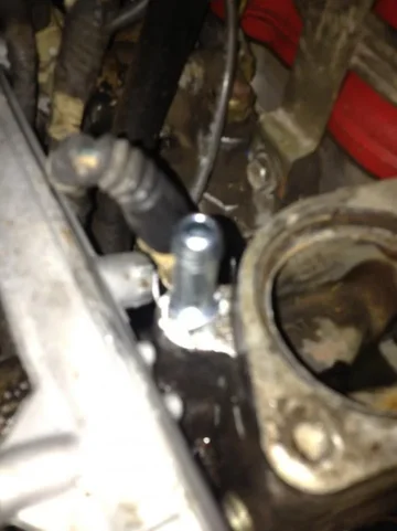

So here she is all tapped in
I will put the intake manifold back on tomorrow and will post up whether this worked or not.
So I just wanted to confirm in fact that drilling and tapping did work.

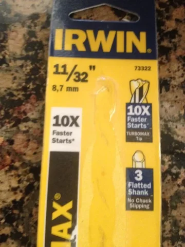

Here are pictures of the drill and tap I used incase anyone needs to do this in the future.
