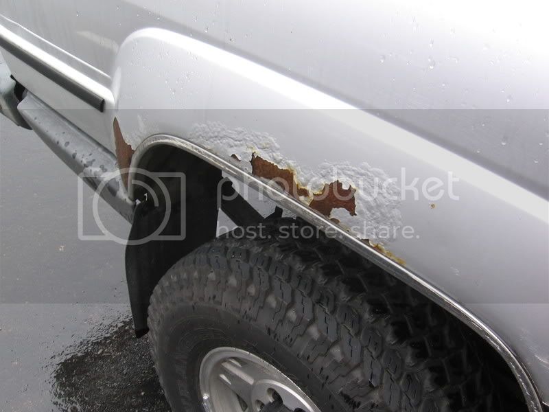

So I have an 86 4 runner that is in awesome shape.
There are 3 trouble spots.
Passenger rear fender #1:
Passenger rear fender #2:
The other spot is like the passenger fender #1 except that it is on the drivers side, and at this point is just bubbling paint.
I would like some recommendations on how to fix this. Of course I don't want to spend a lot of money, so I would like the best bang for the buck.
I am more concerned with stopping the rust than having a 100% quality repair job.
Can I sand down the area, fill, prime and get some color matched paint in an aerosol can?
Thanks in advance.
I'm no body shop guy but I would sand it all down and find how deep has that rust got you. If is just beyond the surface I would treat it with Metal Ready by POR and use a thin layer of body filler. The you can to a $50 paint on everything.
same place mine was rusted... take off the pannels on the inside and it will be on both sides... I sanded it down as much as I could. POR 15 both sides, then used POR body puddy, then POR again. then painted it... I also bought bushwacker fender flares to cover it up... that was 2 years ago... in MN winter, never wash it... the only place it is starting to come through again is where I could not get POR on both sides...
Quick question, you said you took your panel off...How did you do that? I thought it was riveted on the top? If there is an easy way to take the panel off then please let me know because I am currently getting ready to put two new panels on and thought I was going to have to drill through all the rivets and re-rivet everything when I was done.
