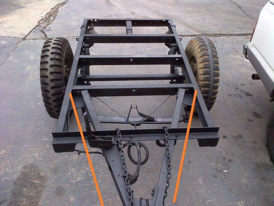

Nope. It was like a 1 page thread looking for ideas. Halfway through the page a guy posted this idea, and a few posts about it. Seemed like a good solution. Attached blueprint drafted up by me to convey the gist of the mod.
The orange lines represent the new beams. They would mount into the existing pockets with some creativity, and the bolts would be moved out on the from of the frame. Running the longer beams the lunette casting was still usable and came forward quite a bit.
