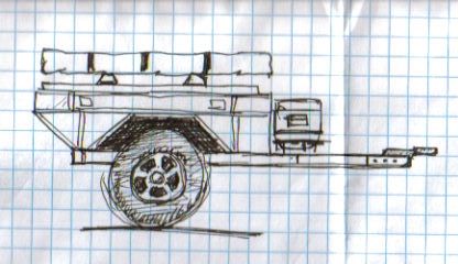

So I am getting ready to start buying material and an axle here in the next week or two. However, I thought I would run my initial plan through you guys to get any feedback or suggestions you might make.
Chasis:
2x3x.120" wall tubing for frame rails, ladder cross members, and 3/16" wall for the A-arm drawbars.
The rear bumper will be 2x5x3/16" welded to the frame rails.
The cross members will span across at the front of the "tub" and at each leaf spring hanger point.
The drawbars will be tied into the front spring mount junction exactly like the m416's.
"Cargo Tub"
I am going to build up a skeleton like frame for the box out of 1" square tubing. This will be skinned from the inside in aluminum with sheet metal screws (unsure about this).
lid would be similar construction except I will gusset at appropriate spots to hard mount posts for my roof top tent.
I may use surplus fenders from a m101 to cover the tires.
Let me know what you think, getting closer, I will post up sketches when I get a chance.
Rezarf <><

Otherwise, the plan sounds good. I'm curious why such a beefy rear bumper on a trailer? It's only as strong as the frame it's tied too...
FYI you can get all kinds of different fenders from Tractor Supply and Northern Tool in both aluminum and steel. Just something to look into.
Honestly, I hadnt really thought about it that way, I'm still in over build mode, when I need to be in light wieght mode.

Here is a sketch of what I think it will look like.
flame away...
More doodles... this is a scale study. Note: a very ROUGH scale study.
Also, in the shot above the lid is just over the center section, however, I think I will make the lid the entire top of the trailer. The price of good latches has helped make this decision.
All these concepts were created in AutoCad .00001 :D
