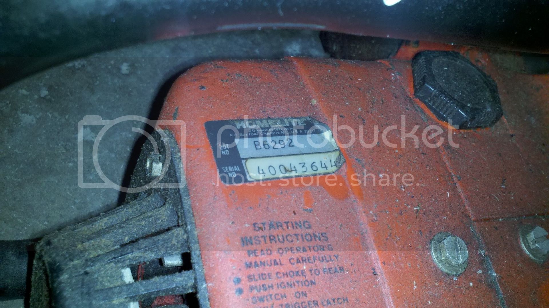

After the cherry tree in our back yard got blown over a few days ago, my dad dug out an old non-running Homelite 150 Automatic chainsaw that his dad had bought some time before 1980. I'm going to try the basic tuneup stuff on it and see if I can get it going again. Problem is I can't find any markings on it to denote exactly which model of 150 it is. All there is is a decal listing a lot # of B6292 and a serial # of 40043644, and it has a 16" bar. I've searched all over and even checked Homelite's site with no luck whatsoever. Any of you guys know how I can find out what exact model it is?
I'll post a couple pics once I can get to my laptop.
Homelite 150 is the model number. They made Blue ones up until 1972'ish and then changed the color to Red.

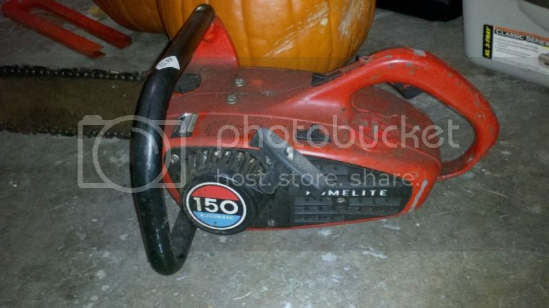

Here's what I'm working with. If nothing else, it'll be a good winter project to get it all fixed up and sharpened so I've got something for household use.
That is the newest version.
So I take it the only big changes between models were between the pre and post '72 version?
If that's the case, that makes it a lot easier than I expected.

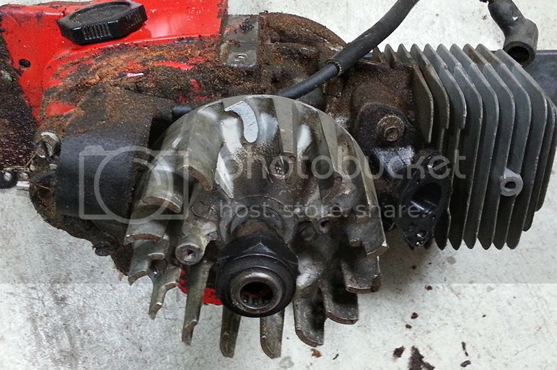

Had to really pull to get the engine out of the case, fumbled when it finally came apart, and the flywheel thunked on my work bench.
That's enough to piss ya off.....
