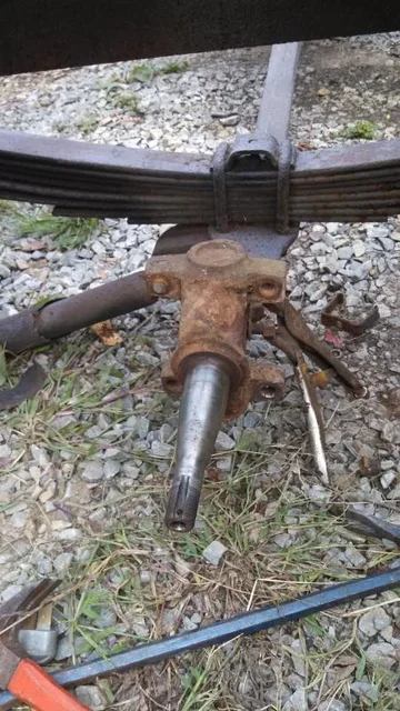

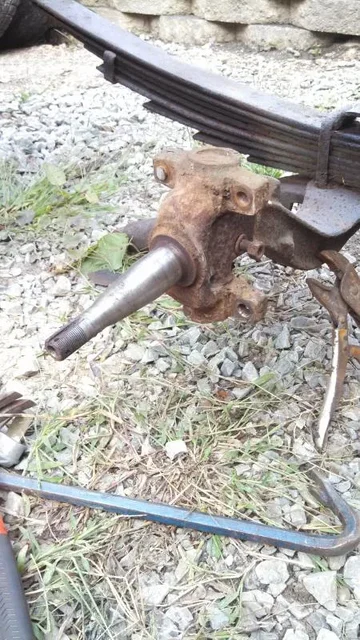

I purchased a homemade trailer and I am trying to get a new hub kit for the axle. The only identifying marks is moraine products 5453821 1 1/8 and the widest part of the spindle measures roughly 1 1/4". It is a drop beam axle. Any ideas?
That appears to be the front axle from a late 40s to mid 50s Ford truck. Is the bolt pattern 5 on 5.5?
