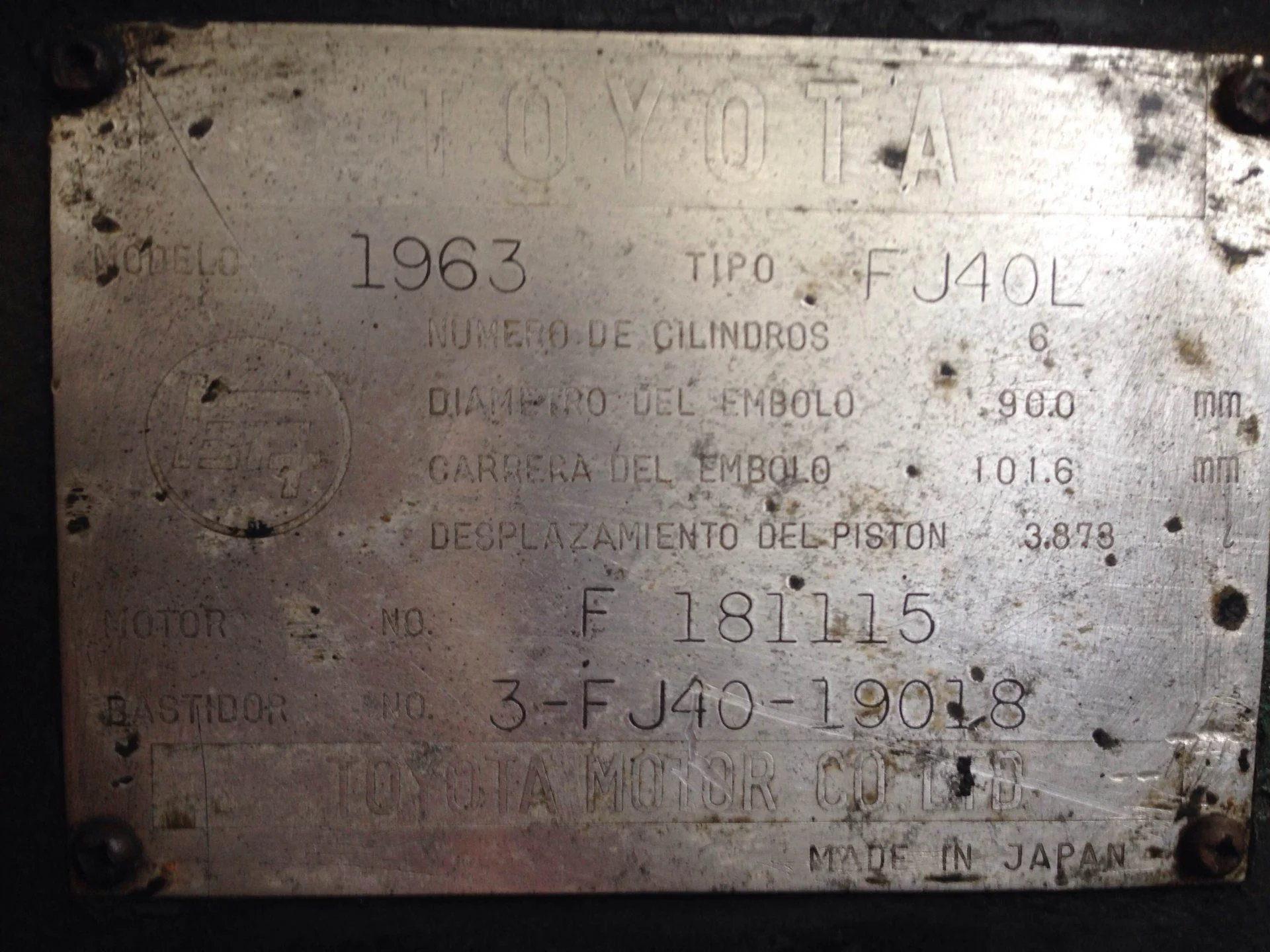

Hi guys, I'm Roberto Ramos, from Honduras I just got a fj25 1966 I will try to renew it, I'm looking for a service manual also please advice me where I can buy spare parts, the car is starting and running but I would love to change everything from radiator to stop lights, previously the car belong to the army force in my country but a good friend bought it in a audition, I will change the upholstery and fabricate a new tool box-seat on the back, also I'm planing to install a set of speakers inside the same box (just for the highway ride) please advice me.....thank you in advance.
Roberto
This it is!
Hi Roberto, welcome, For the parts you need, check out the beginning of the 25 section for researched new Toyota parts. Other than that post up a parts wanted list. What everyone likes are photo's of your cruiser, lots of them. Can you post up your frame #, and data plaque of your 1966 FJ25 and some history of the vehicle? Thank's John P#3 Owner of "Project Old Fart"
The VIN will tell production date but I'm guessing late 63 to mid 64. My 9/64 FJ45 has the longer running boards. The latch to hold the windshield up started with 64 model. The lack of eyebolts on the dash make it a hard top model. 63 model and earlier had a high B pillar (part of the tub just behind the door opening). The tool box under the driver's seat looks like the larger square one which also started with the 64 model.vLike John#3 said the stamped Bezel would be 61 to 63 models. Not to uncommon to add those to a later year. I first did that to my 68 more than thirty years ago. Would be curious if there is a opening for a ashtray under that diamond plate on the dash. US had a ashtray by mid 62. We also had defrost vents around the same time. Not sure either of those were in other markets. Toyota's parts system doesn't go back past 69 even though a lot of parts still available. There is enough member on Mud with old parts catalogs that you should be able to get parts numbers to see if parts y can still get.
Well it's definitely a 1963 FJ40. Some parts are interchangeable with later years but if you want to remain original your best bet will be sourcing parts on the forum. I'll change your thread title to clear up any confusion.
