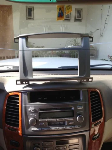

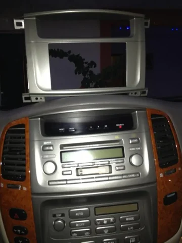

Where did the double DIN radio trim plate come from, OEM part?
This was recommended by a member here on mud. I ordered/paid for two...this place sent 1. This place is not much on communication :rolleyes: If I ordered again I would order 1 item per order. I could not locate a good option in North America.

Dang, all the places selling this double din panel are in UK and want HUGE money to ship it to the US...
You should be able to have two shipped for the same price as a tank of gas! Mine arrived right next to you in Kitsap county. ;)
