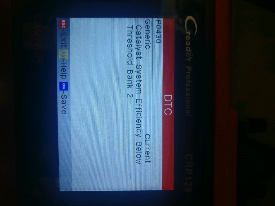

I had the catalyst efficiency one time on my 4Runner. It means that your catalytic converter isn’t operating as it should (clogged). I ran two bottles of Cataclean through it following the directions and the code never came back. You may want to reset all the codes and see if they appear again just to make sure it wasn’t a fluke.

Before replacing your cats your need to check your oxygen sensors for proper function first.

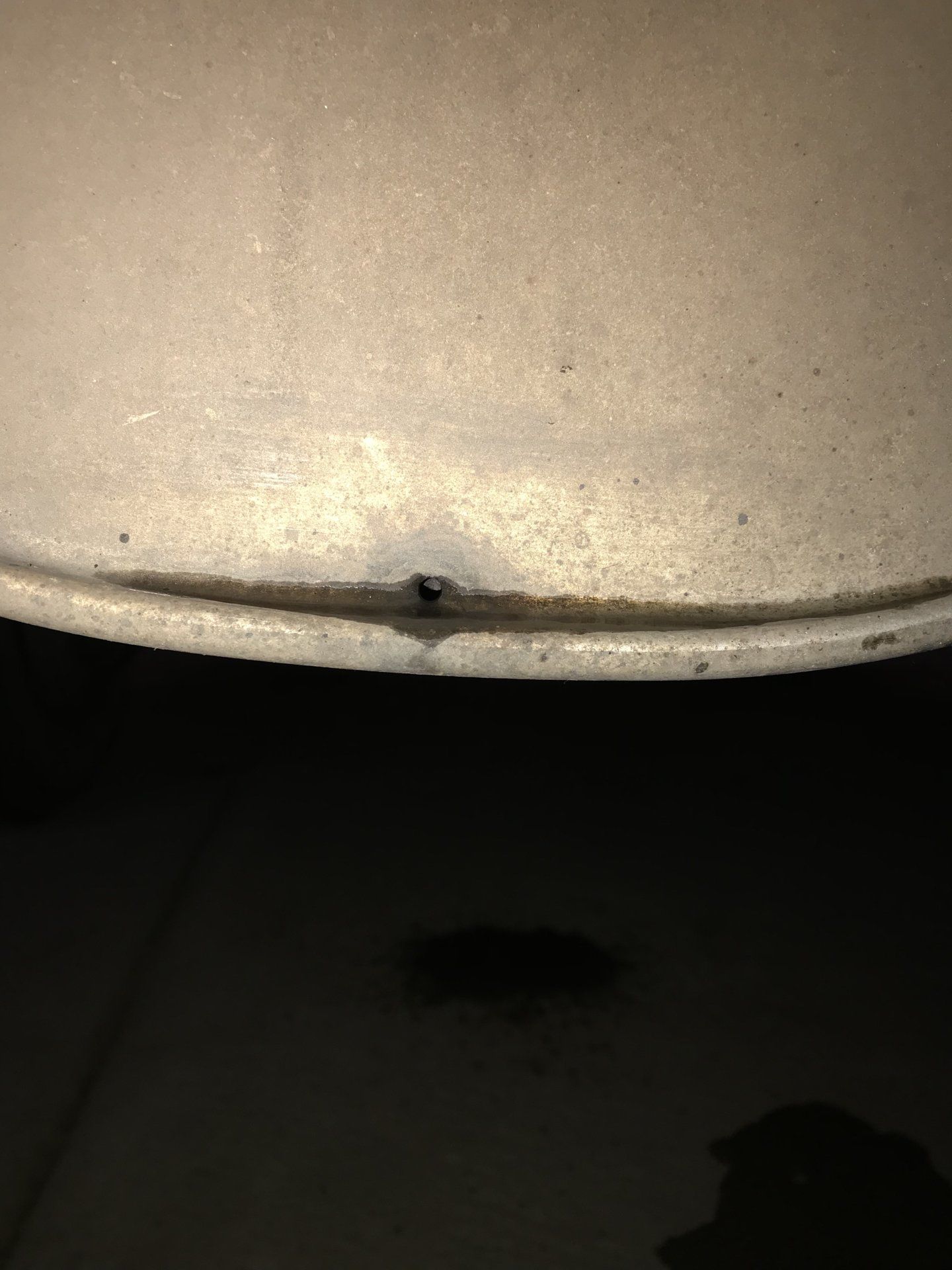

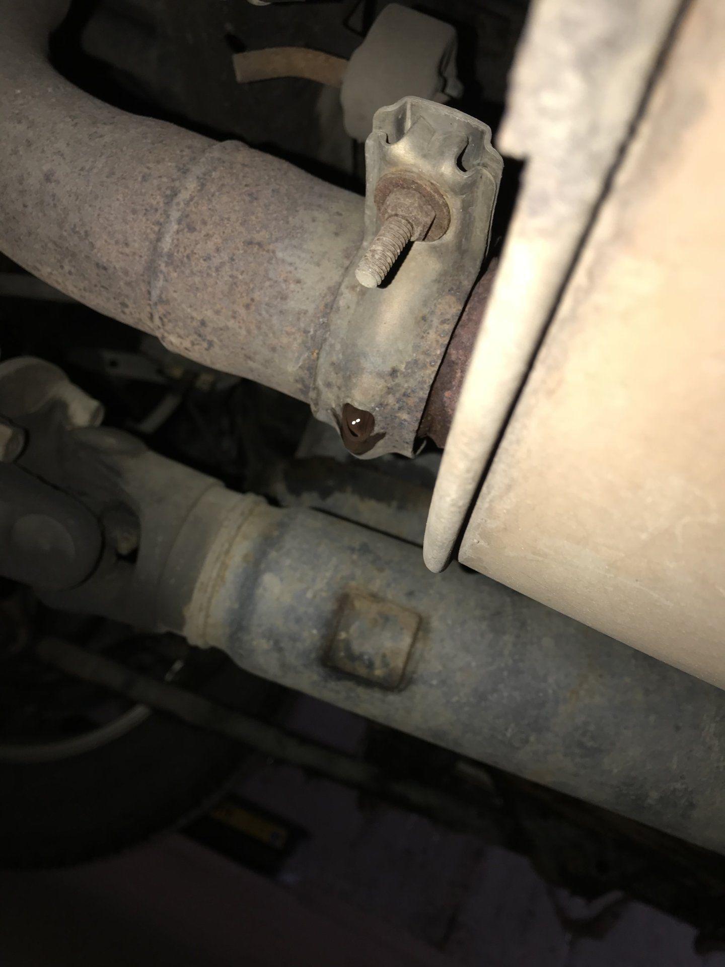

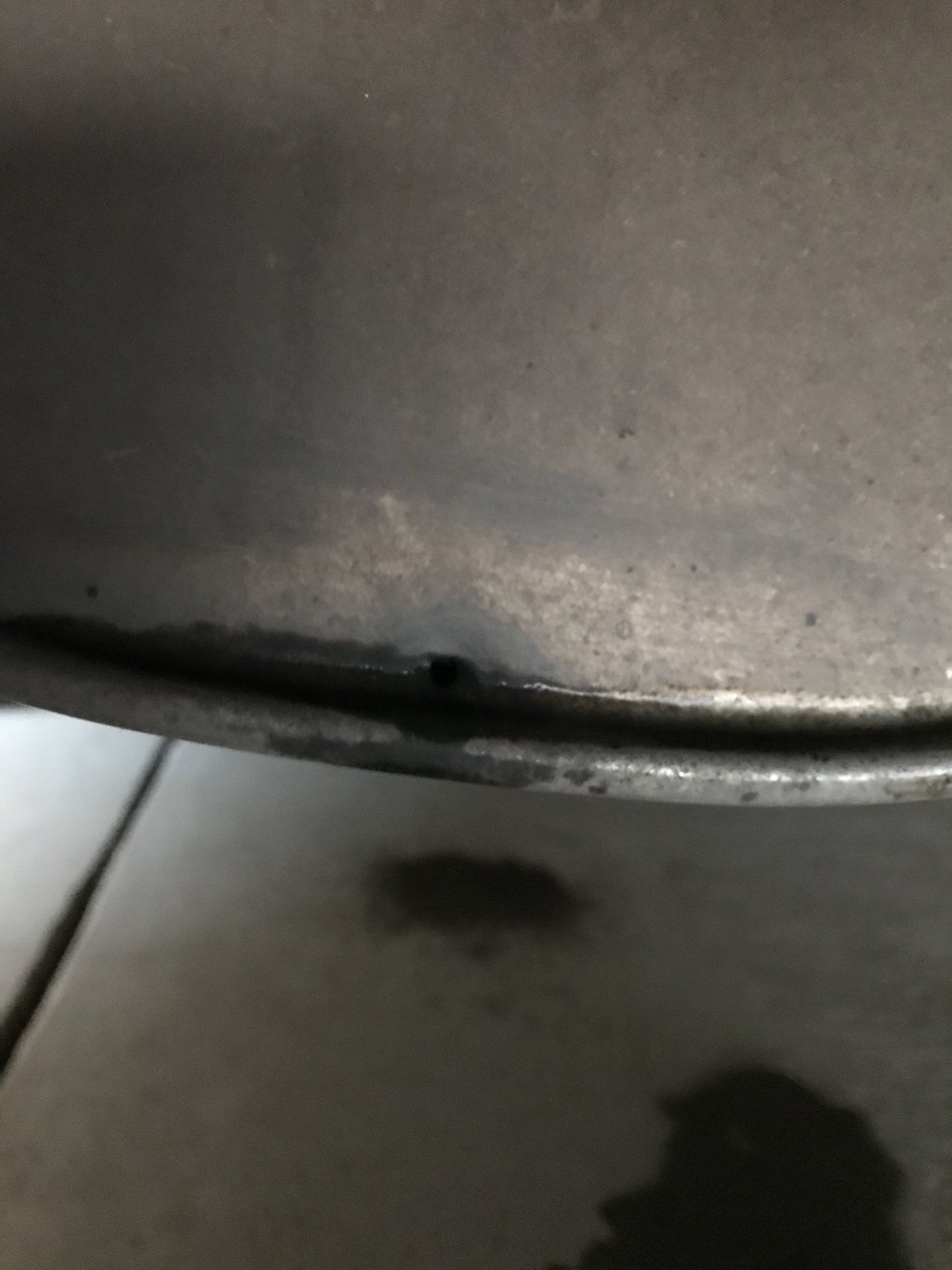

Something which I’ve failed to mention is a while back I noticed my muffler assembly leaking water from 2 separate spots on a cold start. Eventually it would slow down that I couldn’t wait around to see if it’s dripping water or not. Could this have caused some kind of issue?
One leak is right behind the muffler towards the rear of the truck, it’s under a clamp. 2nd leak is literally a hole in the muffler facing the front of the truck.
Mufflers don’t leak. If that is water it’s coming from the AC drip line or a puddle you ran thru on the way home.

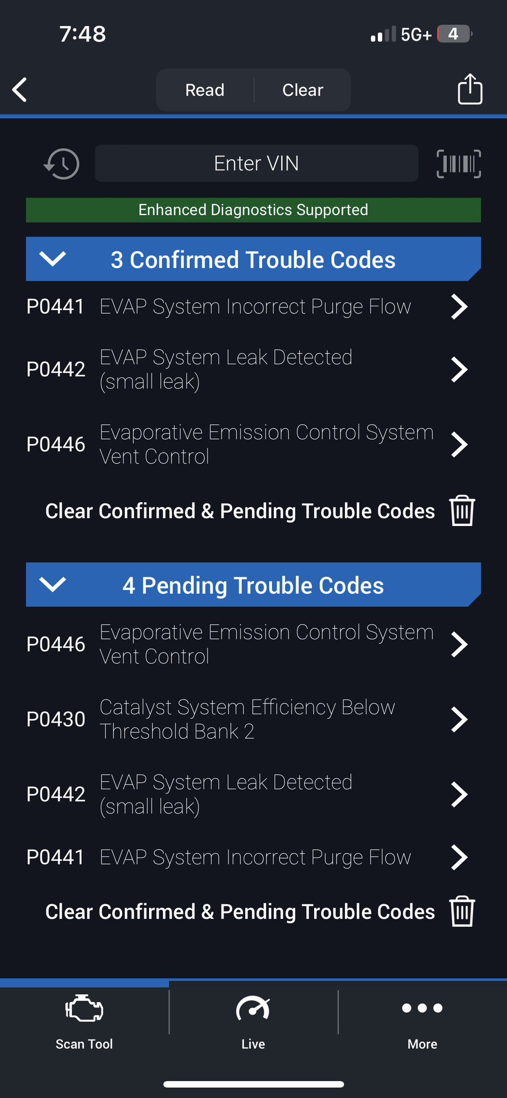

Reviving this one. I pulled the below codes and dug a bit deeper. General consensus is “get a new gas cap”. Cleared the codes, and I go to the dealership today because OEM or nothing for this part. Put the new cap on and it’s looser than the original on my 03 LX. It damn near rattles if you give it a shake, where my original cap doesn’t. I’m thinking it’s defective? It’s also MUCH lighter than the original. As soon as I cranked the car after swapping the caps, all 3 lights popped back on. Put the old cap back on, will clear codes tomorrow and see how long it lasts.

Cap didn’t fix it, replaced both vapor purge solenoid, and the other purge valve, replaced charcoal canister, still had the code. I think mine was rust on the filler neck.
The truck got totaled about 4 days after the charcoal canister swap. I pulled all new parts and sent it to copart
