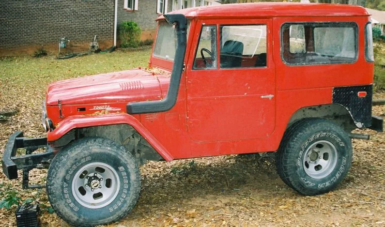

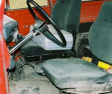

Josh & Jackson's FJ-40

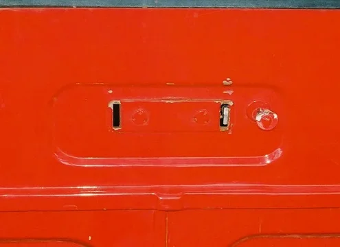

Let me share this, Josh would have never left his FJ-40 as dirty as this. Evidently, someone drove it, a lot, while he was deployed. My first job - since I've already repaired the flat tire, is to hose it out and fix the rear door while I am waiting for the Chilton repair manual to arrive. The starter is in the drivers floor board and the carb isn't attached. Also, what apprears to be the air cleaner assembly is in the rear.

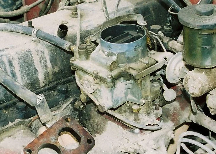

I took a good look at Josh and Jackson's FJ-40.
Here's what I think...(for those who don't know me - this is usually where I get in trouble)... there's a mud line in the engine bay and on the engine just past the exhaust manifold. I think the guy who was keeping it until Josh got back, buried it in mud/water. There wasn't any water in the oil (checked the dipstick). There's gunk in the starter. I'm going to drain the oil this week - oil change - and look for water. I'm also going to remove the plugs and look for water.
I'll keep ya'll posted.
