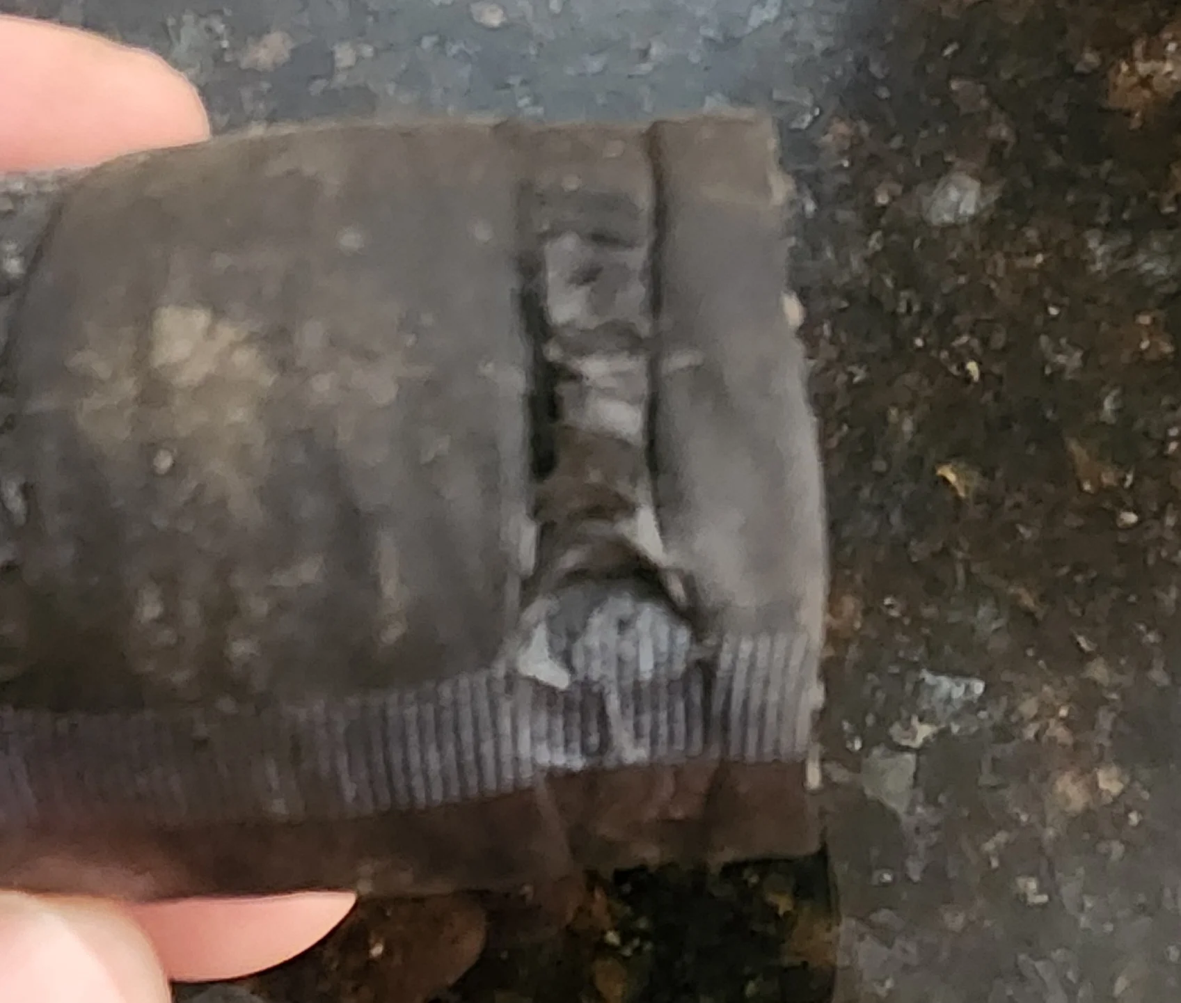

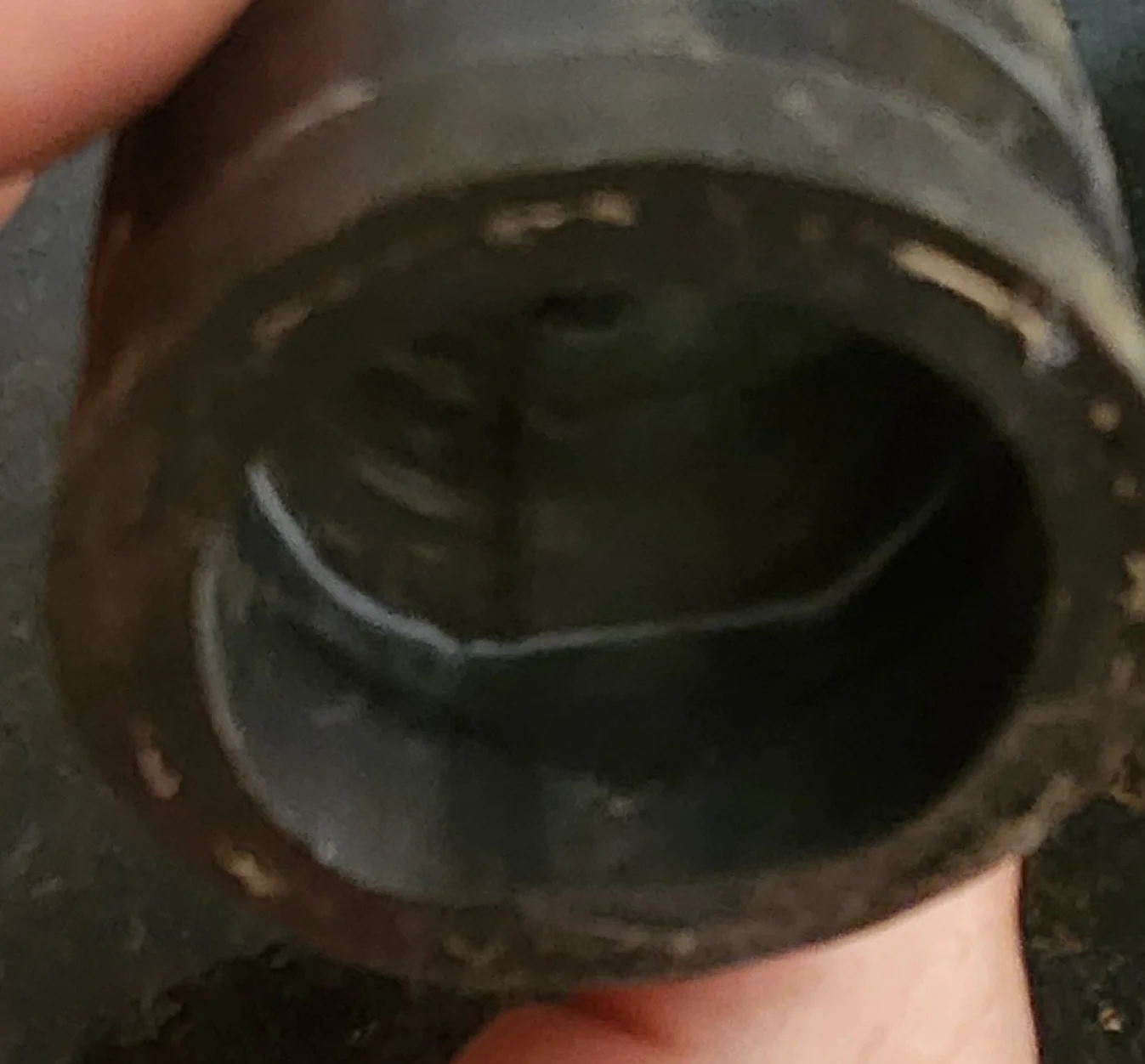

Found a leak a small leak path on the old hose.
Problem with worm gear type hose clamps is the tension are not uniform. Trying to clamp down from 1.25" hose to 1" is cutting into the hose.

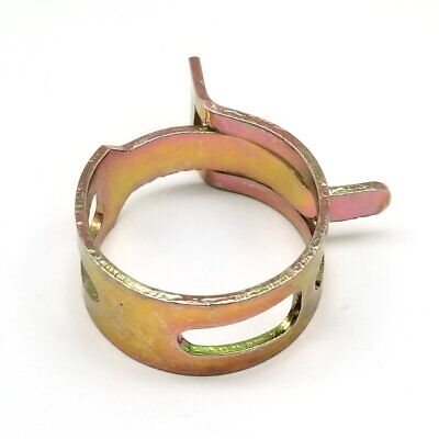

I might need to replace the worm gear with spring tension hose clamp. Not easy to find locally. This seems to be the correct size with 1" ID hose I use.
