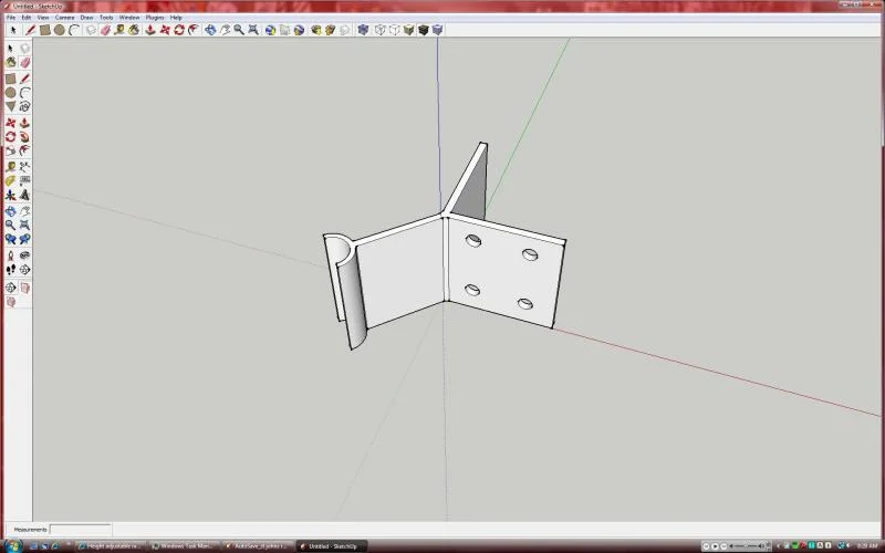

reinforce it on the tub corners with a stout braket...it'll help tone down the sway while in the tent and during travel.
I'm afraid too much movement will cause it to rip itself apart
great job btw!!:beer:
Just a thought...
Great minds think alike, I'm already there!! Nice model, that's what I was thinking for the front too. The back will have to allow the tub to slide out, so it may be removable or multi-part.
