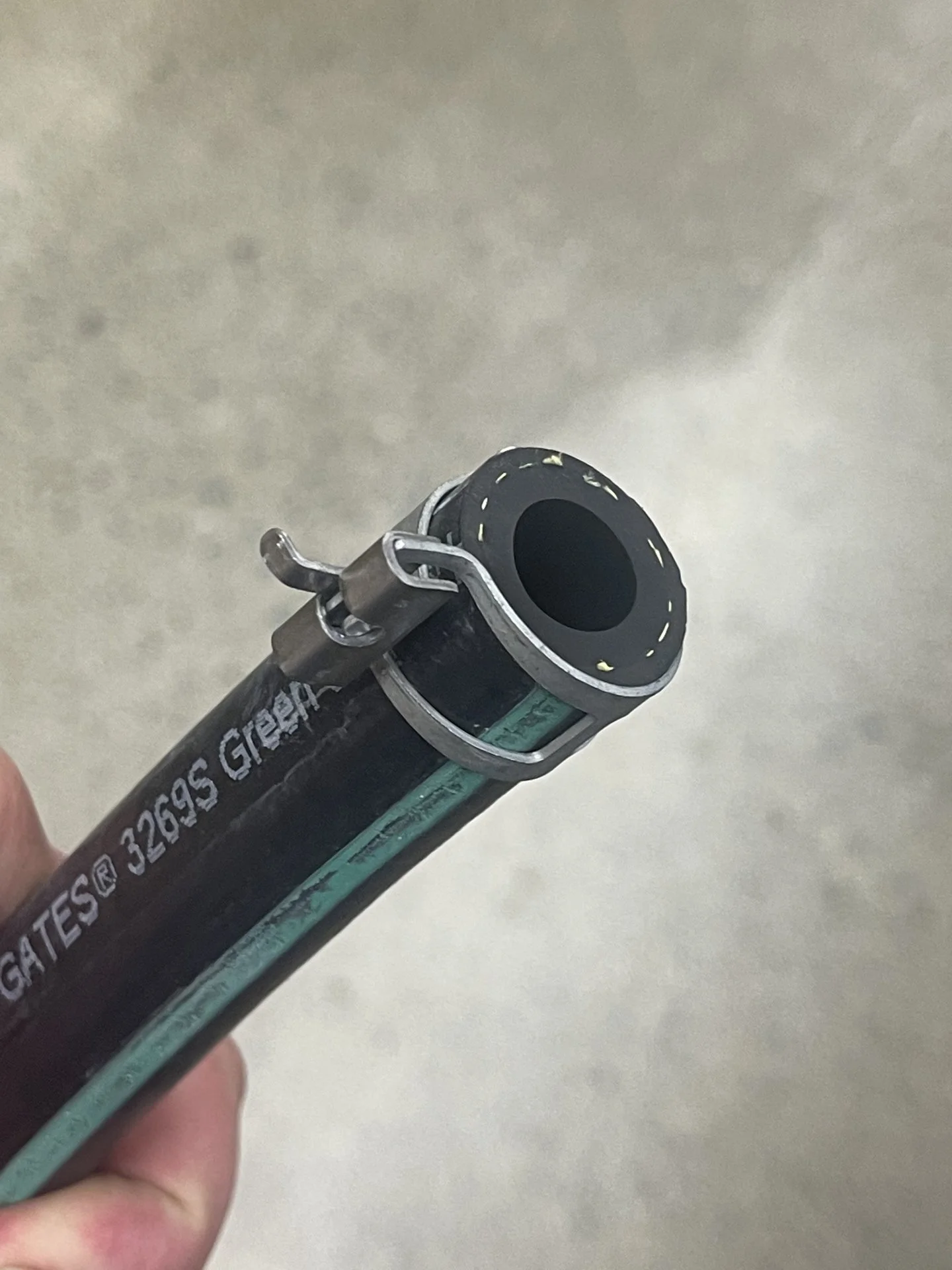

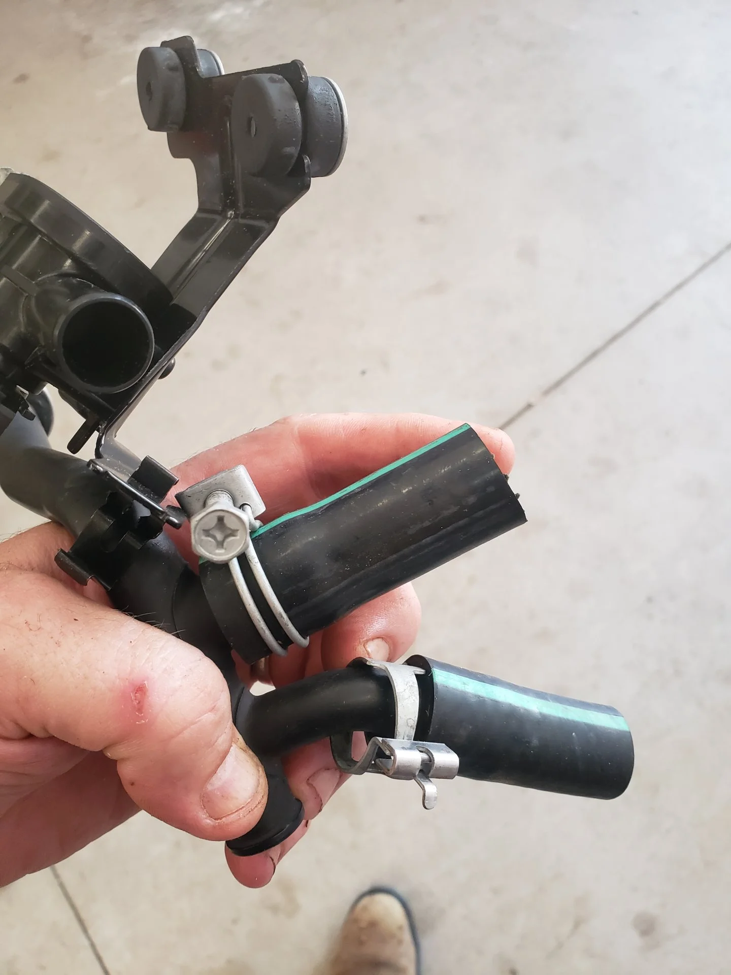

The OEM 1/2" constant tension spring clamp (87124-60070) wont fit over the thicker 1/2" Gate Green Stripe hose no matter how sweetly I talk to it (bottom hose in pic). 15/16" from McMaster are a 6 week lead time....
Anyone got any suggestions on an OEM quality constant tension spring clamp that will work and in stock?

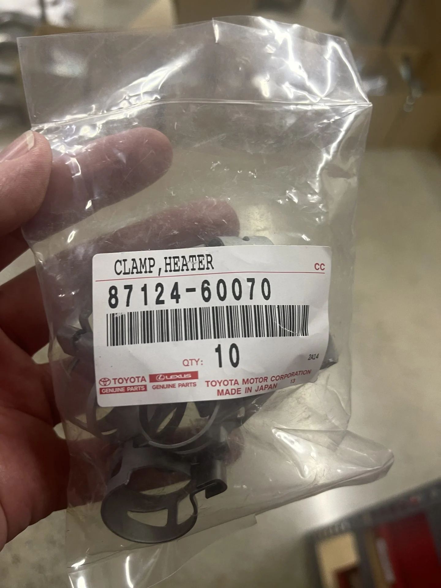

Thanks, Fellas. 60070 is the PN I'm using. Fits fine on OEM hose. It'll go over the Gates hose but not the hose and nipple.

Put the clamp on first over the nipple, then push the hose on. The clamp goes on from behind so that it doesn't need to pass the nipple's bubble.

Amazon product ASIN B005EMZTHSThese are excellent clamps, IMO as good as OEM spring clamps. Just measure your hose when it's uninstalled and also when it is sitting on top of the nipple to find out what range of clamp you need, then order accordingly. Order a couple sizes if you're unsure.
