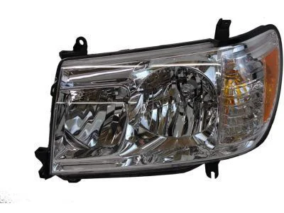

Is that even true in the 06/07 where the side markers are made into the same assembly with the headlamp? I know you stated those years, but of course I don't have the option/ability to remove my side markers separately, so just want to make sure.
I'm pretty sure all OEM headlamps were in two pieces, regardless of year. They have main portion with low beam (plus high attached high beam housing on LX) and the separate corner light housing. The only lights I'm familiar with that are all one piece are the Chinese aftermarket units like Depo
The answer to your question if you can remove the HL assembly from an 06/07 may it be an LC or LX without removing the bumper is Yes. For an LC you have to remove the grille and side markers though, front bumper no.
Unless you cut the bottom mounting tab on 06 and 07 Land Cruiser head lights, I'm pretty sure you have to remove the bumper.
06 and 07 Land Cruiser came from the factory as one-piece plastic headlights.
I've heard of people cutting their bottom mounting point as a slot so that they can remove the headlights without removing the bumper, like this:
