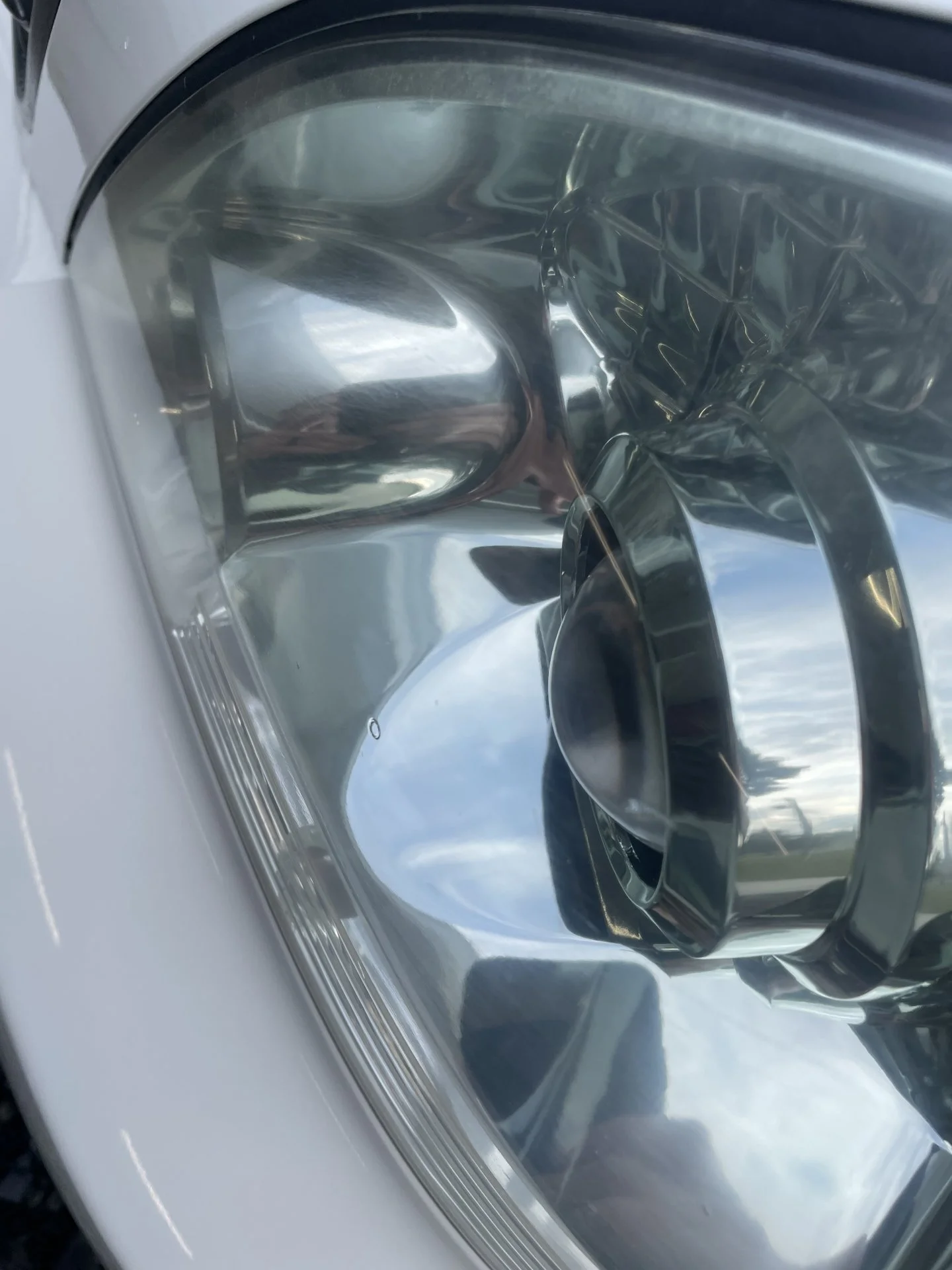

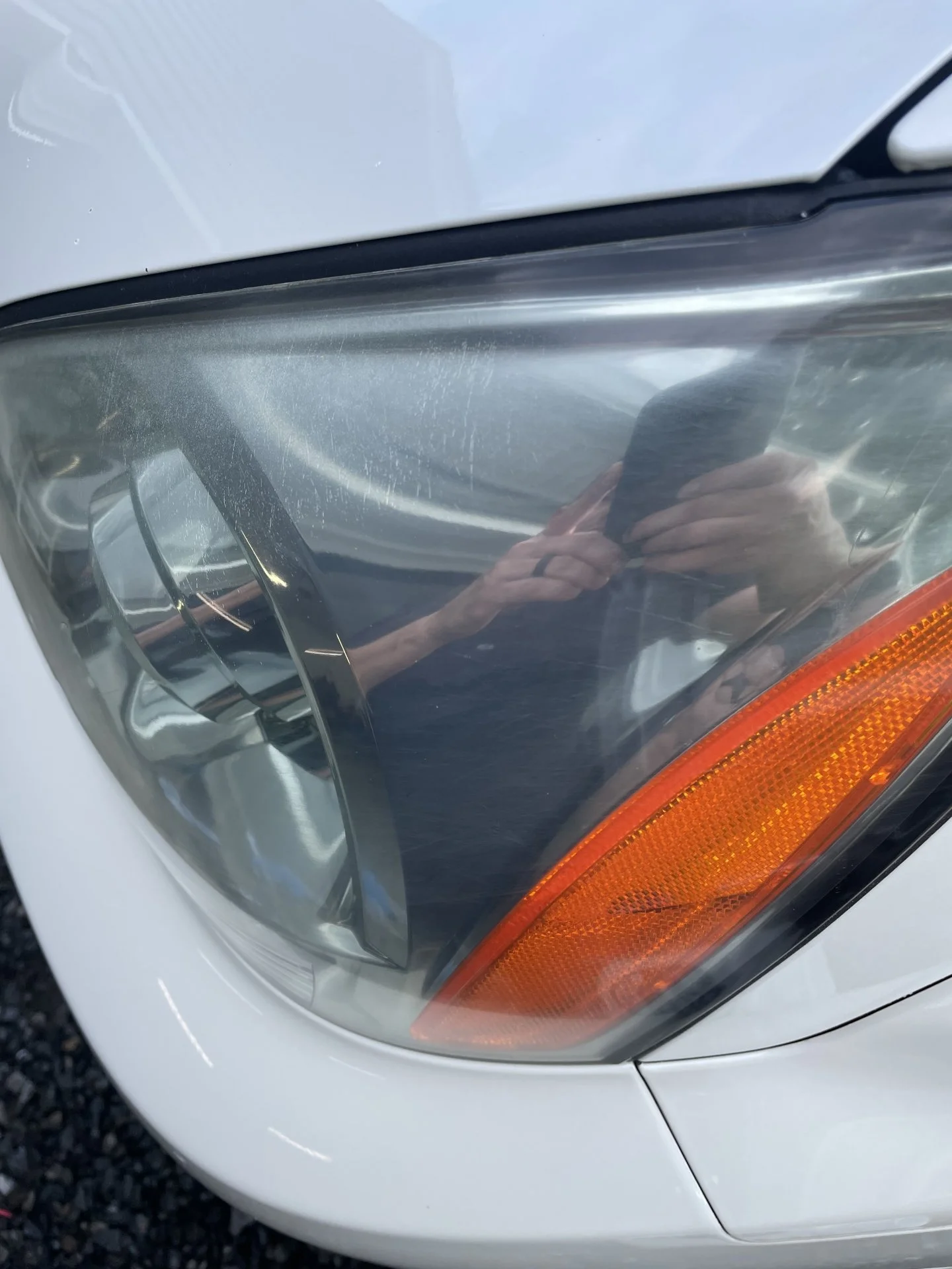

Talk about thread revival! I used 1000, 1200, 1500, 2000, Meguiars 105 and lastly Ultimate Polish. Lights look good, no yellow left at all but there are some very fine scratches left, anyone else had this problem? Here are a couple pics, I hit each 3 or 4 times with compound/polish using a wool pad for compound then black pad for polish.
Micro cracks in the lens on the inside would be my guess. Mine look similar
I restored my OEM lights that were subjected to 10+ years of Texas sun. It’s incredible how they turned out. Like, they shouldn’t have been able to be restored at all they were so bad. Mine also have those tiny stress cracks. That’s just a product of age with the lense. There’s nothing you’re going to be able to do about that at all. I used the kit that has the drill attachment for buffing. I also keep the clear plastic restorer on hand and do a quick hand buff on occasion. It keeps them maintained at their current level, which is entirely acceptable.
