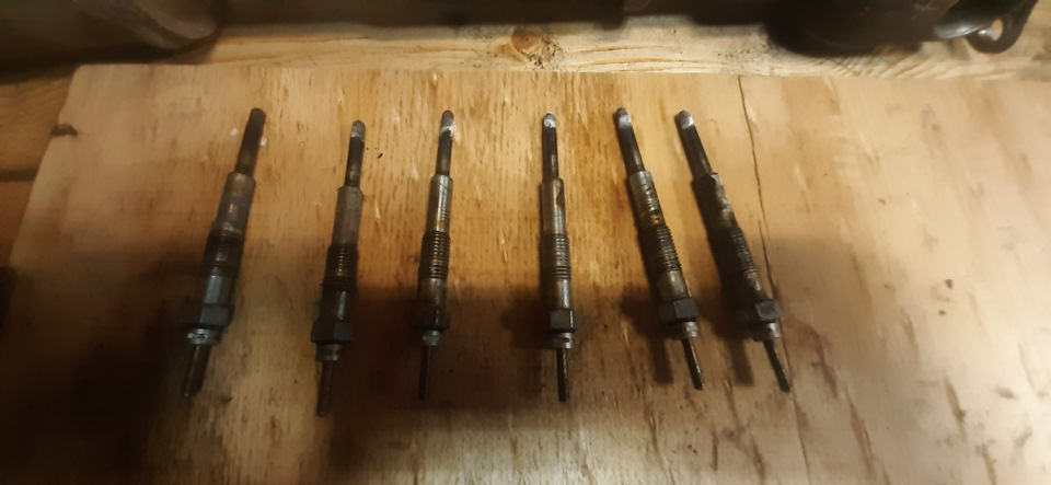

I recently replaced the head gasket on my 1HZ engine. If you have the tools, it's not that difficult. However, you'll need some mechanical experience and the engine manual. The cylinder head weighs 40 kilograms.
