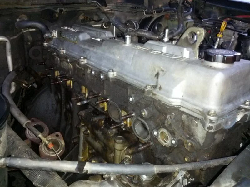

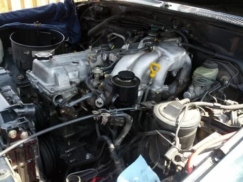

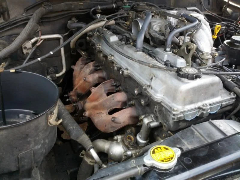

So here I started working on the exhaust side.

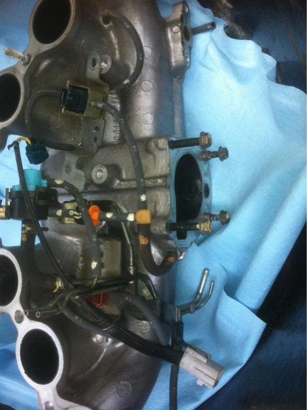

Then I moved over to the Passenger side and moved through the battery/alternator area.

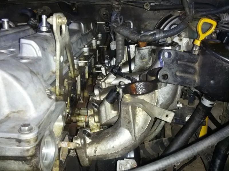

Here, the exhaust side is completely free.
And here, the intake side is completely free.

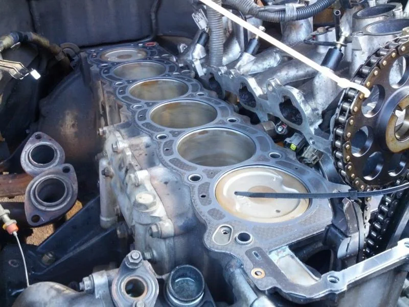

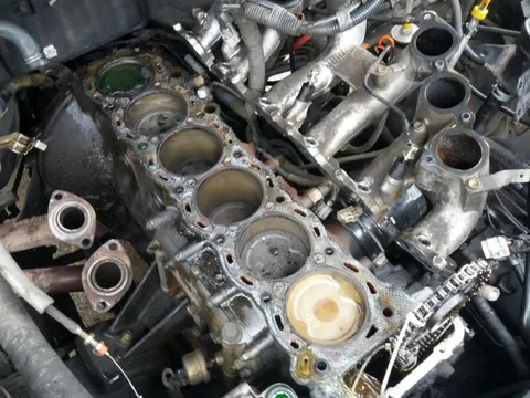

My head gasket issue was definitely cylinder #1. Looks like it was steam cleaned compared to the others.

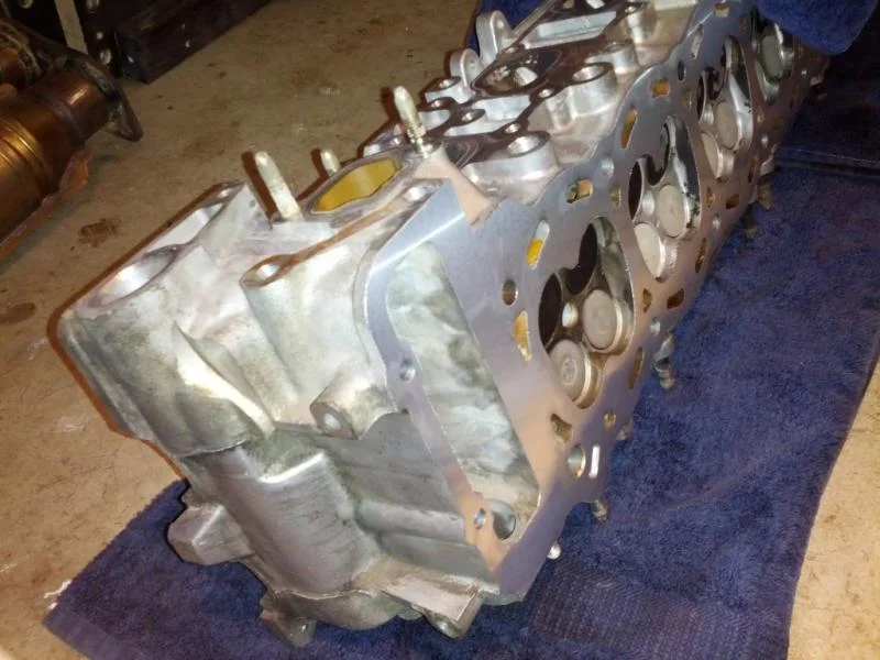

Here's the resurfaced head back from the machine shop.
Here's the much beefier head gasket on the block.

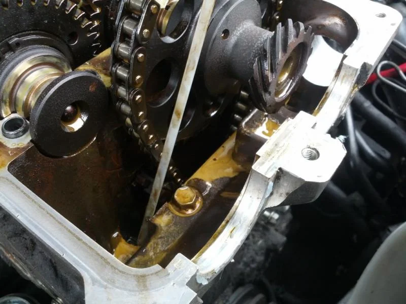

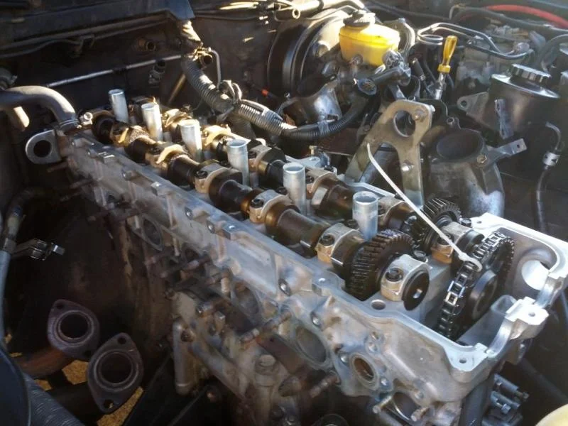

Putting the cams back in and keeping the timing.
Mostly back together

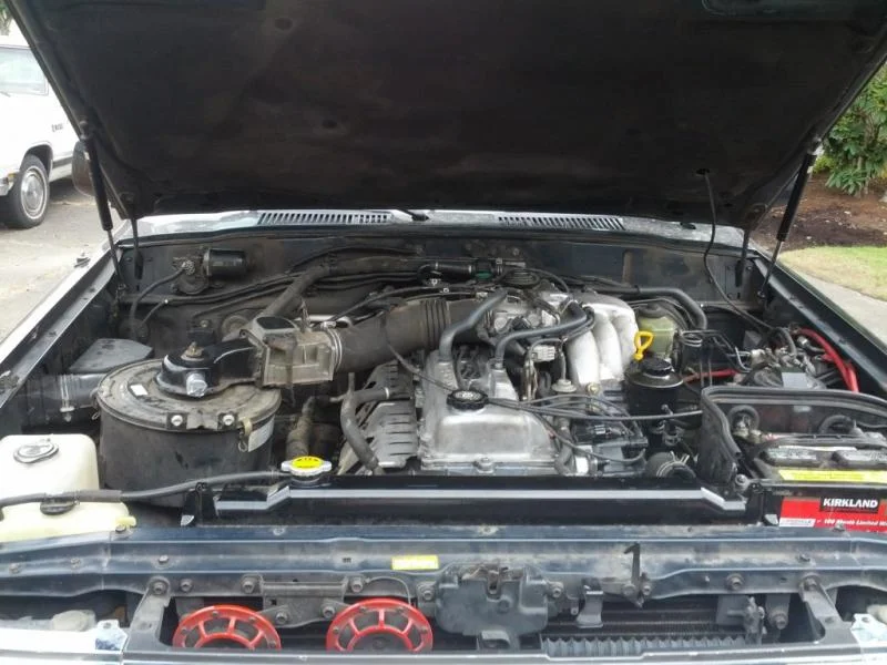

Finally complete! I also removed the PAIR system on my vehicle. For now I installed plates over exhaust portion, but I plan on relocating the o2's up there soon.
Not too bad for about 19 days worth of work.
I had also installed a Koso Slim temp gauge during all of this. Temps are staying nice and cool. Took an hour drive down I5 at 60mph on a 75F day. It was sitting right at 176 degrees the whole way. During stop and go around 80F, it likes to be around 185-190. I don't think I've seen it over 194F yet on muggy/humid day with the A/C on.

From me climbing into the engine bay and coolant from the back spilling into the cylinder. It wasn't from the gasket...
Why is #6 green?

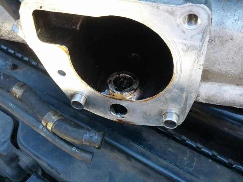

Ha! Disgusting! Absolutely disgusting. This little circle port was completely flat with carbon buildup. Had to poke a screw driver through it. There was ample oil sludge and buildup in the rest of the runners.
well done!
how did the intake manifold look?

Saw %6 with the coolant and thought dang, then realized it probably spilled in after it was opened. Good job! I got to tackle a head gasket replacement soon.
Well good luck with yours! Most of my re-assembly time was cleaning the peanut butter oil build up off. I honestly didn't even know that the front of the block was silver until I removed half an inch of caked on oil crud with a couple cans of degreaser and carb cleaner.

I'm about to tackle this. Just curious what the head work cost and if they did anything other than mill the head?
Head work was $115 total. They cleaned, pressure and leak tested the head. Then milled it.
