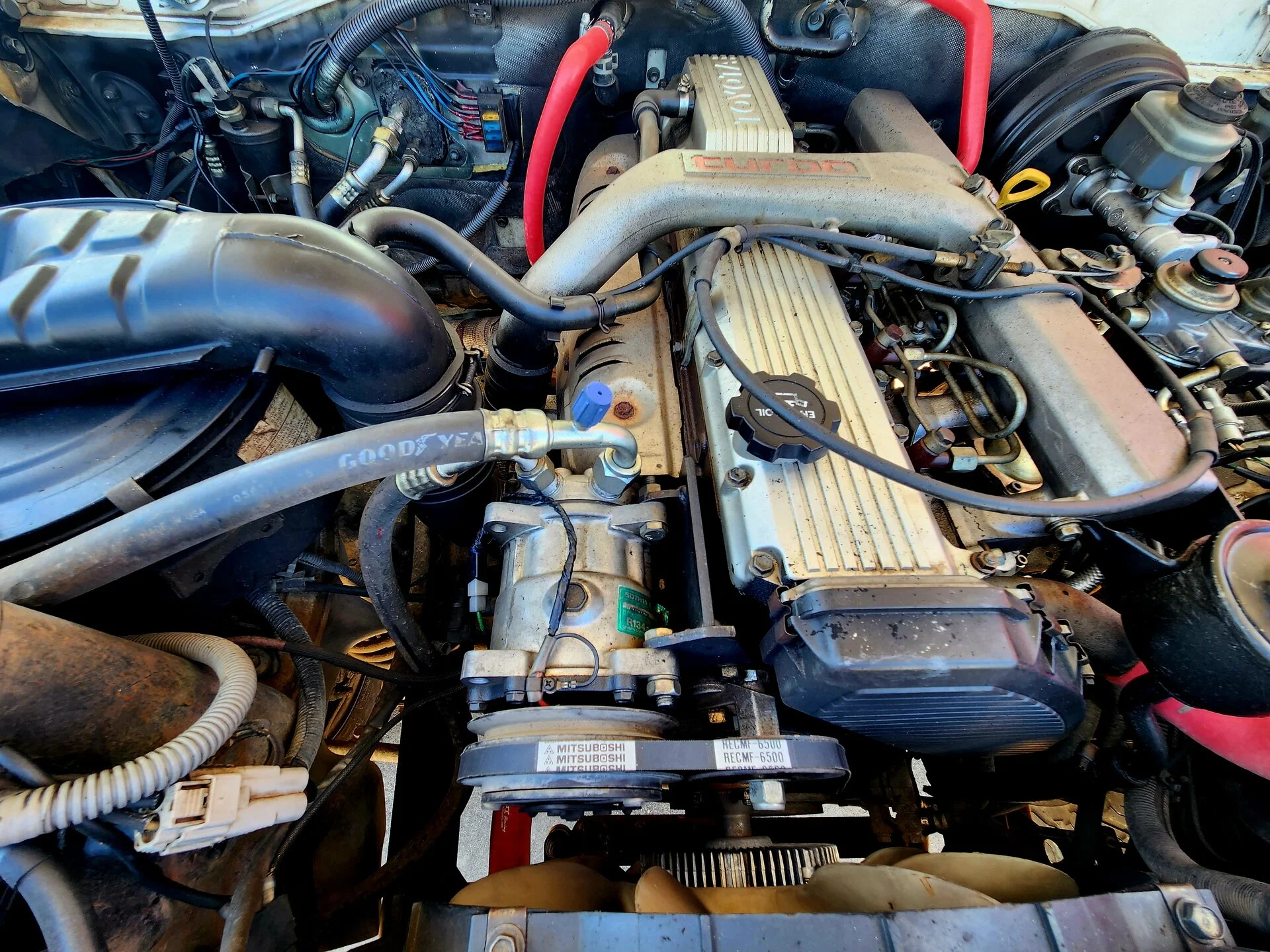

Clutch done gone on my 1990 HDJ80
AC. It was recommended l just get a whole new AC setup!? Came from Spain. Upgraded coolant in 2021 by importer.
Thoughts? Sources?
Rock on!! Gracias (:
You have some weirdness going on - that is not the factory AC compressor or bracket.
definitely not OEM
is there a part number on that AC compressor you may be able to just buy the clutch assembly
but if the compressor is seized you will need a whole new compressor or rebuild.

I'd guess not all the rubber got replaced w the upgraded coolant, and it degraded and now s***sfuct.

It made a terrible racket having difficulty engaging, then would engage, quiet, and operate great.
Now it spins making a godawful racket and smells like a burnt clutch and no cold air. So l reckoned the clutch was out. I appreciate the input above!
ultimately you can restore everything back to OEM.
