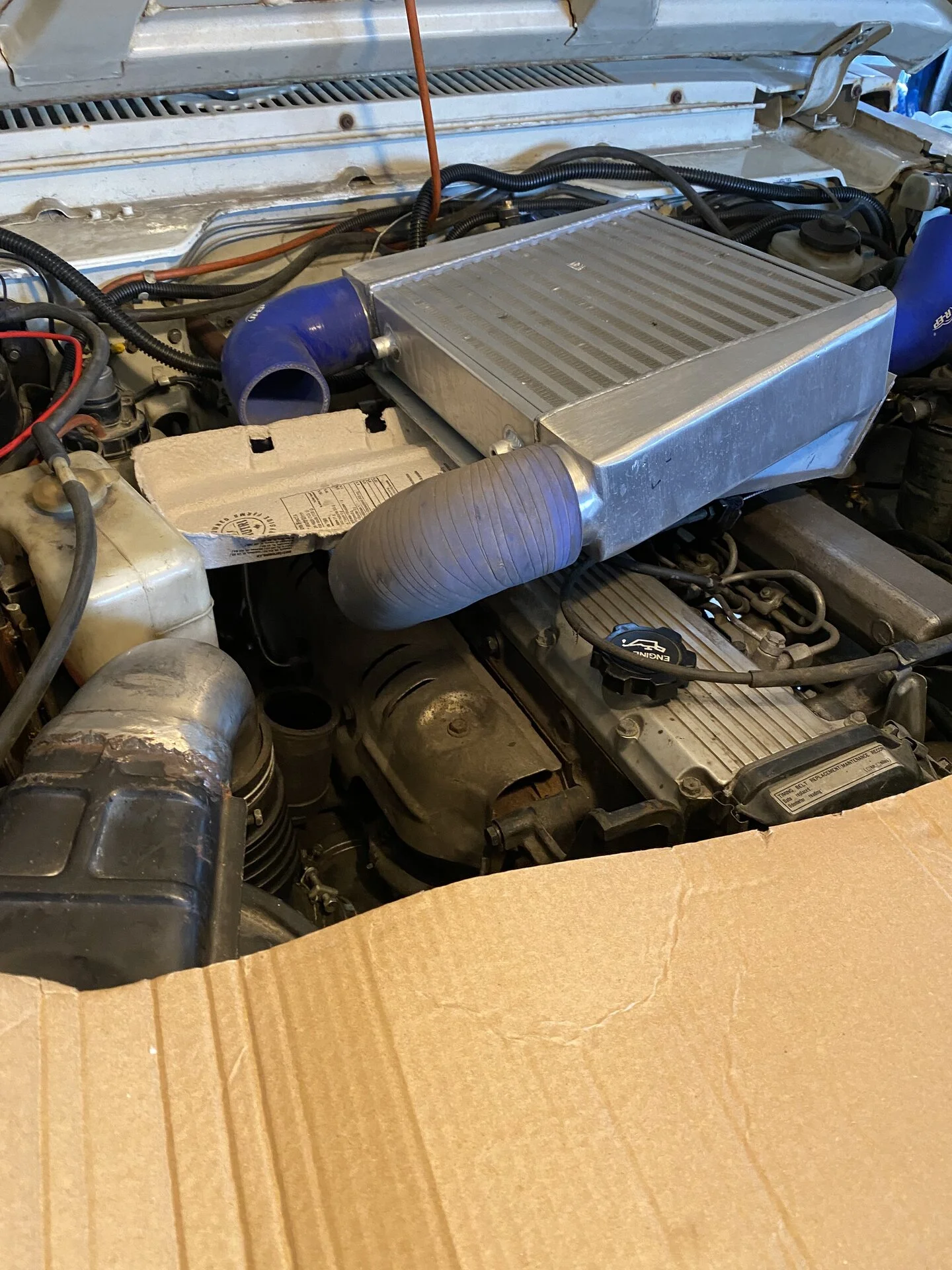

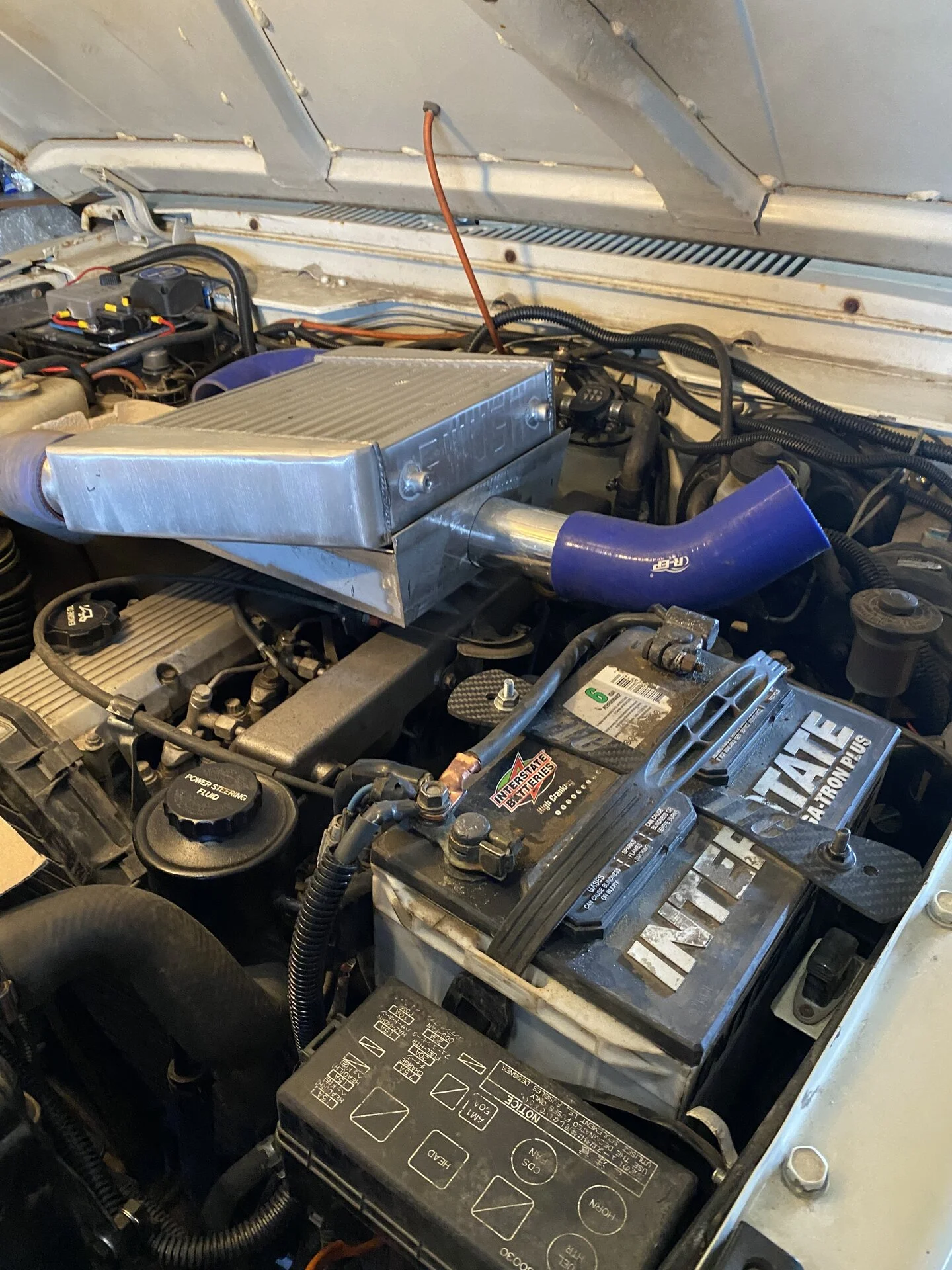

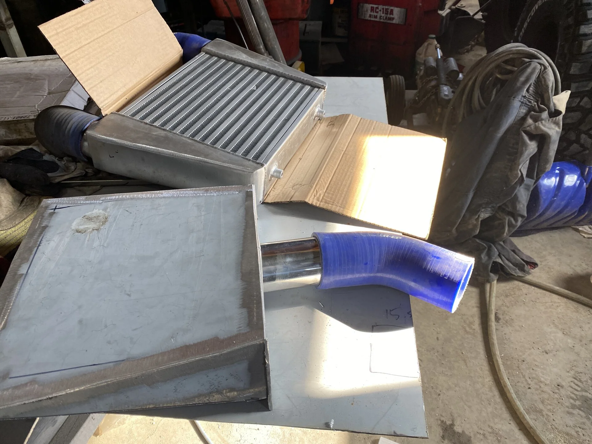

Hi all,I dropped in a 1HDT in my 71 fj55,and I’m going to take my intercooled Gturbo hdj81 off the road to do sone bodywork this summer,so going to use the hdj55 to do some towing,boat and small trailer,I know without intercooler,the egr will be high,so I’m going to fit a top mount intercooler and I don’t want to cut the hood and install a hood scope,and front mount is not a choice either without cutting into the structural frame of the front bib,I’m going to build a box under the intercooker and direct air to the intercooler using a 2.5” tube from the side vent of the left fender,what are your thoughts?

I like your idea of not using a hood scope and find your approach quite interesting. The question is how much air is actually coming through that hose. That would probably depend on the pressure situation on the "hot" side of the intercooler. Hot air could go the wrong way and exit at your side grille....

Does it leave enough room to hook up to your intake manifold? Where are you going to hook in to it?
i took the HDT crossover pipe off,using a 1HZ pipe,i will have to shorten it a bit,will show pics when i get to it

Interesting idea but I think you need a far bigger duct than the 2.5" pipe. Either that or you need a decent fan pushing air through it.
