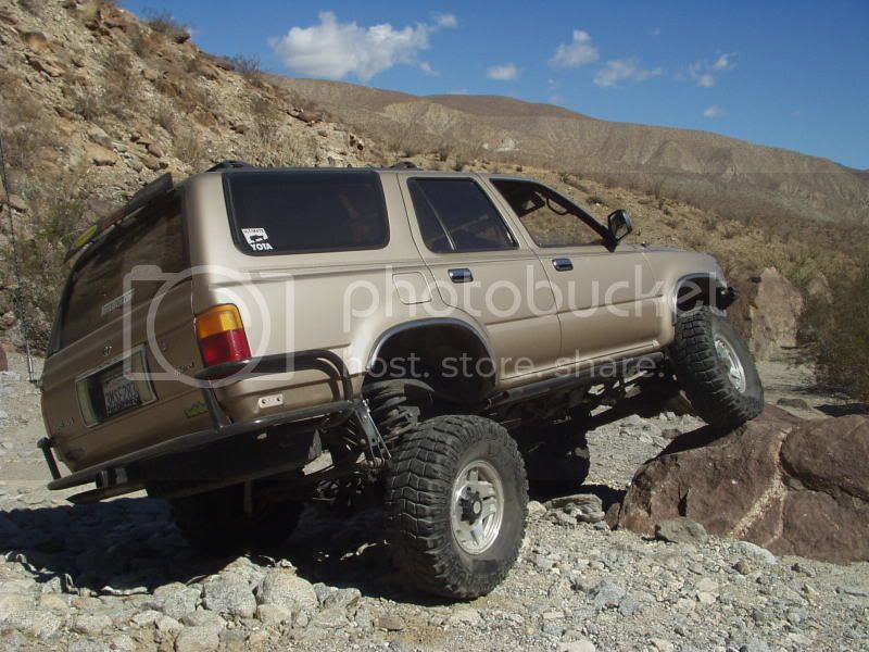

I run the OME 860's on my 4runner, but it is heavier than your first gen.
I love them. They flex great, and stabilze my on road ride.
Put a big bumper with a big tire on it, load the back with tools/fridge/etc and put in a roll cage. (can't remember if you have one already...
