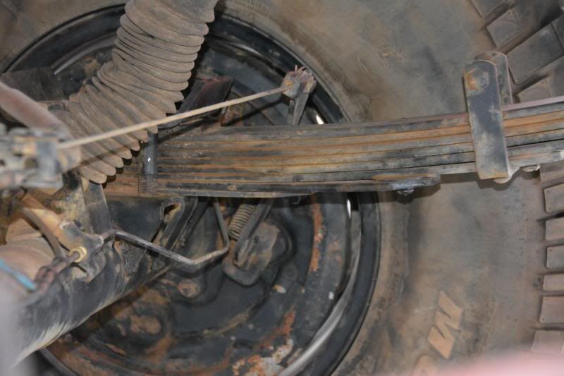

It should be simple, yes. Either TG, All-pro, NWOR lift kit, or chevy rears and rears up front. If it had any of that I could figure out what to do next to drop it ~4+ inches.
Instead, it has shock hoops that look like TG or AllPro or Marlin, rear U-bolt flip spring pads that I haven't seen anywhere, relocated rear shackles, and Alcan springs with 7 pack front and 8 pack rear. I haven't found any vendor that sells Alcan springs with their lift kit. So I'm thinking the guy did some custom stuff.
It rides fine, I don't know how it flexes yet, but I need to drop from my current frame height of ~26 down closer to 21 or 22.

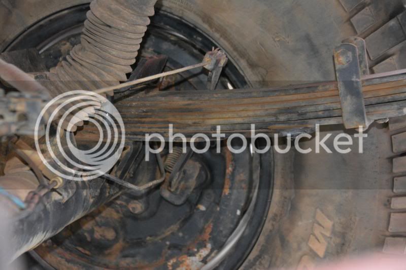

Rear: Alcan 8 pack, strange spring perch http://s207.photobucket.com/user/fgz1/media/85 4Runner/131210_4Runner004_zps87de0fa5.jpg.html

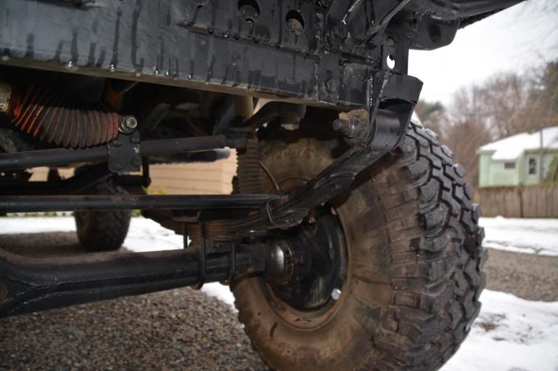

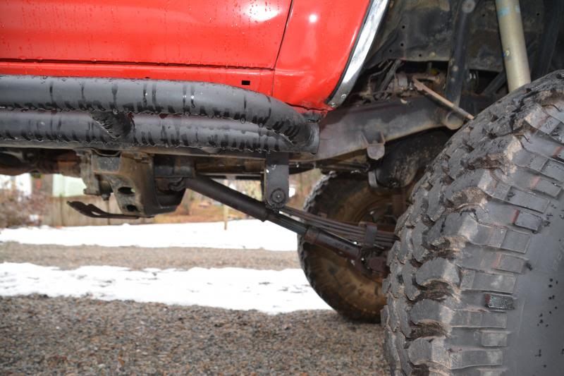

Front: Alcan 7 pack, terrible (vertical) shackle angle http://s207.photobucket.com/user/fgz1/media/85 4Runner/131210_4Runner010_zpsd9bb12ef.jpg.html http://s207.photobucket.com/user/fgz1/media/85 4Runner/131210_4Runner016_zpsbccc02f2.jpg.html

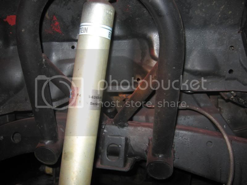

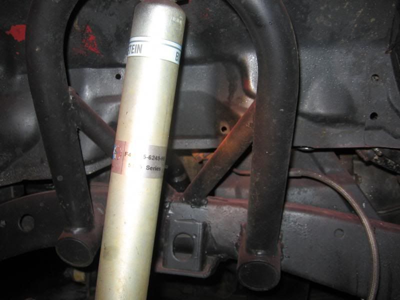

Shock hoop, bilsteins http://s207.photobucket.com/user/fgz1/media/85 4Runner/131209_4Runner001_zpse94a4c0b.jpg.html

alcan springs are custom springs like you thought and from what people have claimed are really good. those pics are difficult to see anything

Rears:
Front:
Shackle angle:
Shock Hoop:
your rear spring "ubolt" assembly used to be sold at All Pro I think. I have the same set up on my truck. Why are you wanting to lower it?

how about your front shackle angle they look like there almost straight up and down , could be the angle of the pic
I took some additional pics of that front shackle angle because someone else pointed that out. Yes it's vertical. Flattening the current springs won't fix it, I need longer springs. So I'm either looking into RUF or custom Alcans. The customs aren't that much more than most vendors springs, and I'll recoup some cost when I resell my current ones which are in great shape.
