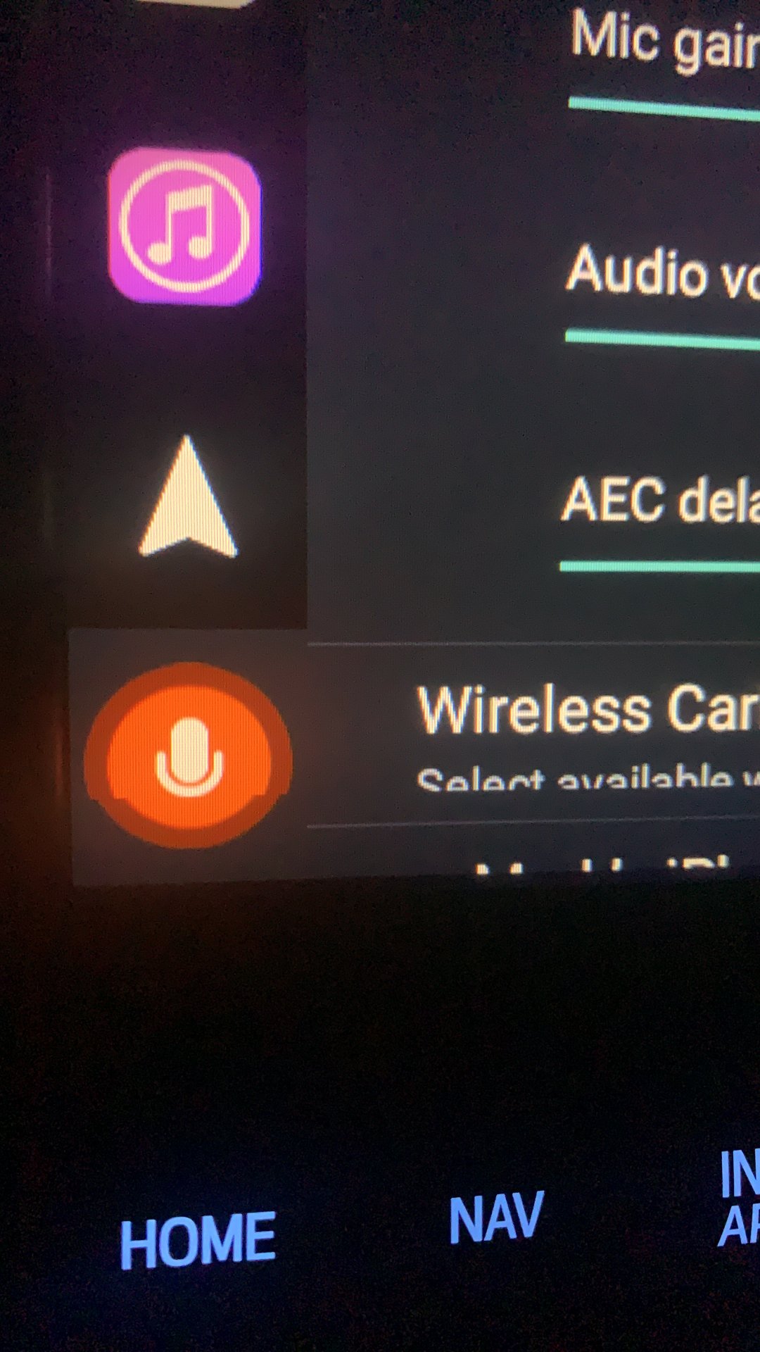

The GROM is far from perfect, and really impossible to make a short list of issues. I believe there are at least 3, maybe 6, different GROM VLINE2s that cover the 200 series (between LX and LC). They all interact with the OEM system a little differently. Also, the user equpment (phones) all possibly interact differently with the VLINE2s. I have an iPhone 11 Pro Max. It's getting long in the tooth by now and i believe at least half my issues are caused by the phone. On longer drives (over 3 hours) i will usually lose wireless carplay connection at some point. Generally, the only thing that resolves this is closing apps on my phone. I believe it's a memory issue with the CarPlay app on the phone. But there are also definitely bugs on the VLINE2 side. If you have the LEX6 model installed in a 2010-11 LX570, you have to run a firmware that is about 6 generations old if you want your screen to work most of the time. The newer firmware versions cause the screen to go black and will not return until you hit the USB button on the dash. In the one specific firmware, the screen flashes black sometimes but always returns back to the VLINE2 on it's own, so it works best. These are the 2 biggest issues I have with mine. Other than this, it works pretty well. As long as you understand that you are running on V8 Android, so it's not going to be like having a fancy new android tablet in the dash. I like having the Android features though. It allows me to run OBD Fusion from the screen, as well as some other video streaming apps (only when not in motion of course). The touch functionality is pretty terrible as well, but it's manageable.

I just installed one in my 2013 Land Cruiser. At first the none of the vehicle cameras worked, but after unplugging the vlite2 from the headunit and plugging it back in, everything now works correctly. I have only had it for two days now. Time will tell

So far, decent. Once in a while the GROM carplay screen will disappear and the radio will show the factory line in screen, but carplay doesn't stop working. The screen comes back to normal after one or two seconds. Wireless carplay can be a bother. It is a little buggy and cause the GROM unit to reboot. I would certainly buy it again.
