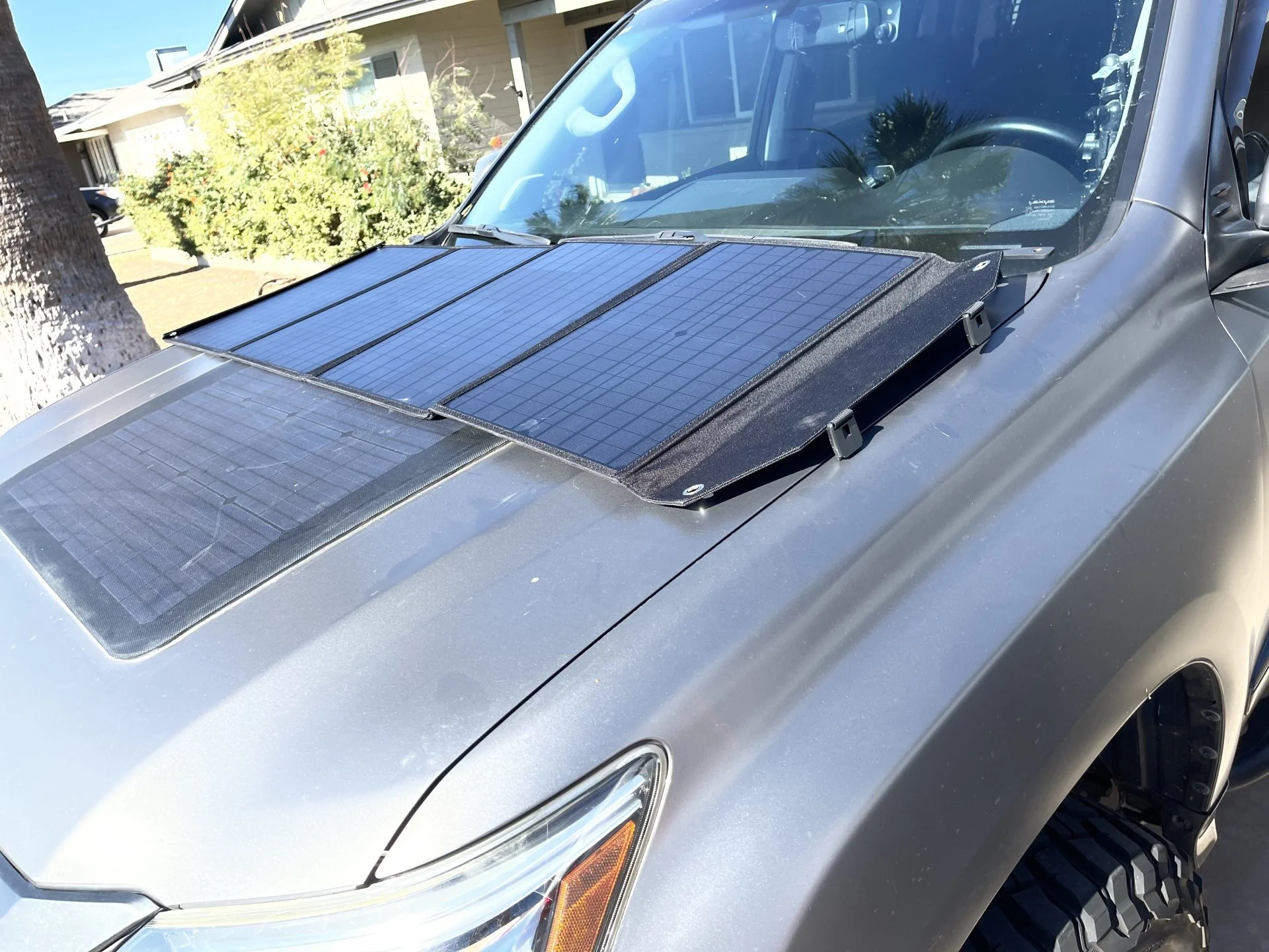

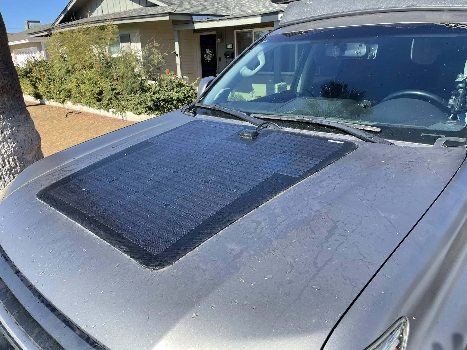

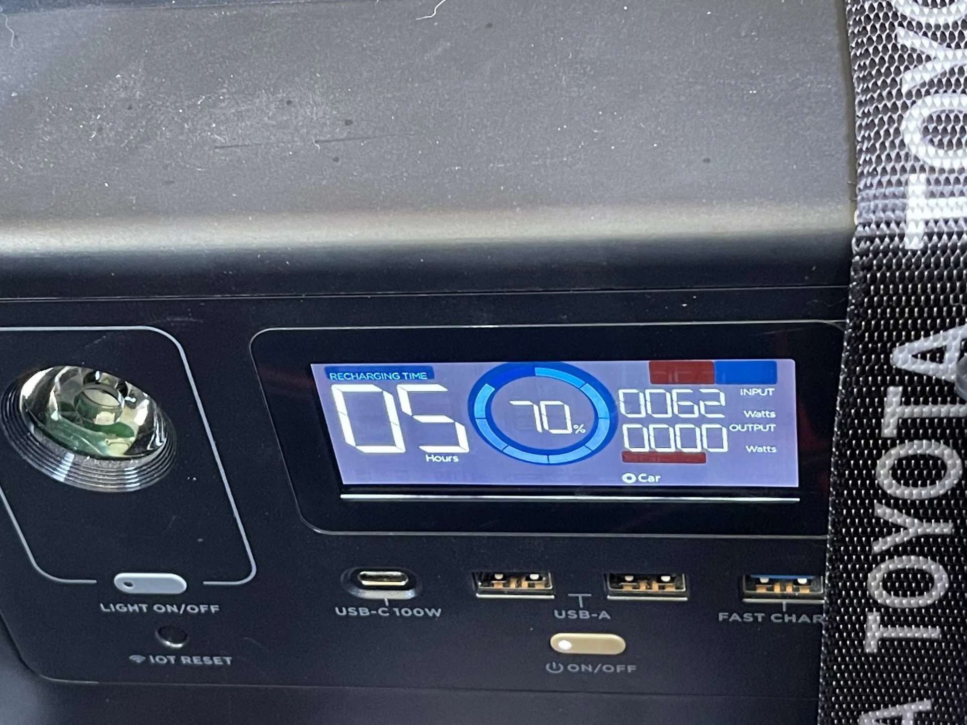

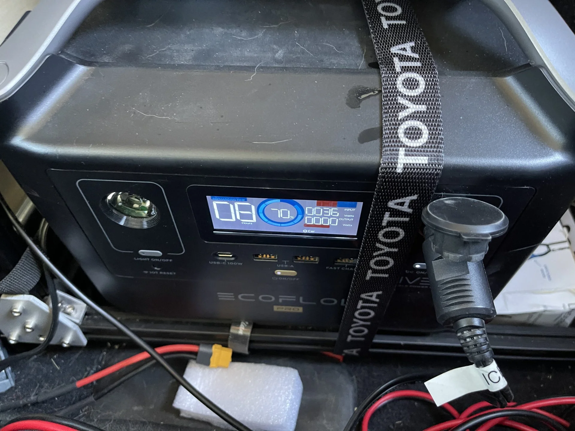

I have a Lensun 100w on my GX. I’m disappointed in the output. But I am not a dissatisfied customer.
I only get 30-45ish watts in direct sunlight. In comparison, my rockpals 100w gets around 60w in the same position using the same cables.
I have been using them since Oct 21. So there may be improvement in the summer.
The build quality is good, and the panel matches the body lines in the hood. It does its job in topping off my battery, so overall I’m content.

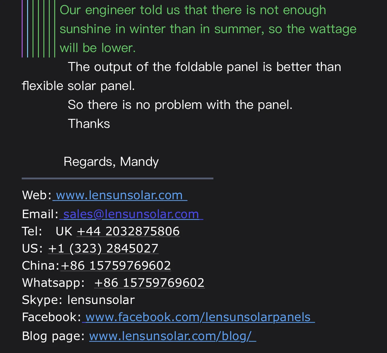

Attached are the readings I sent Lensun, and their response.
one thing we need to remember is that the nominal power is normally calculated for a panel artificially maintained at 25C. In reality, however, in all but really rare circumstances, the panel will heat up and the "power produced" is less at the same irradiance. This is quantified by the power temperature coefficient. This is a significant effect, not a minor one. But the problem here is that if you have a panel that is affixed to a surface otherwise exposed to the sun, it will heat up much more than in "standard" installs where the installer should try to maintain an air gap in the back to improve cooling. In addition, if the panel is on a hood which is also heated from underneath, things don't look good from a temperature perspective, and it would not be surprising to see much less production than the nominal values would suggest. That is a basic issue with hood-mounted panels IMO.
