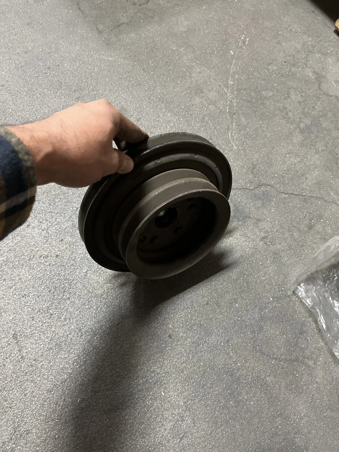

I have a 3 Groove pulley from a 3fe that will work for your application.
will the a/c function the same?
the belt will be spinning slower revolutions versus the 2F crank pulley, there is a bit of difference in diameter of the a/c belt pulley
I went out and measured my crank pulleys, only measuring the a/c pulley
2F is aprox 9" diameter
3FE is aprox 6 3/4" diameter
You’re absolutely right. I was able to find my spare 3 Groove 2F Pulley.
