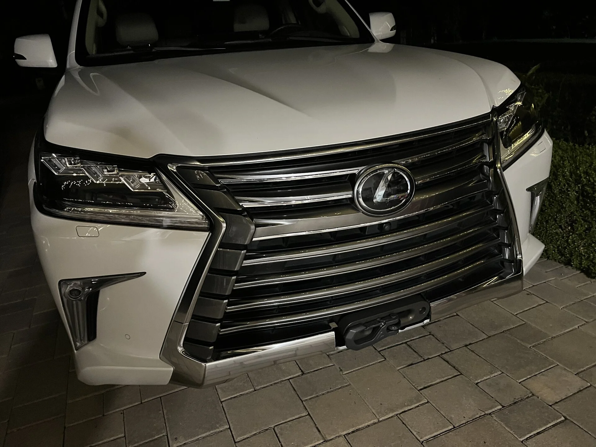

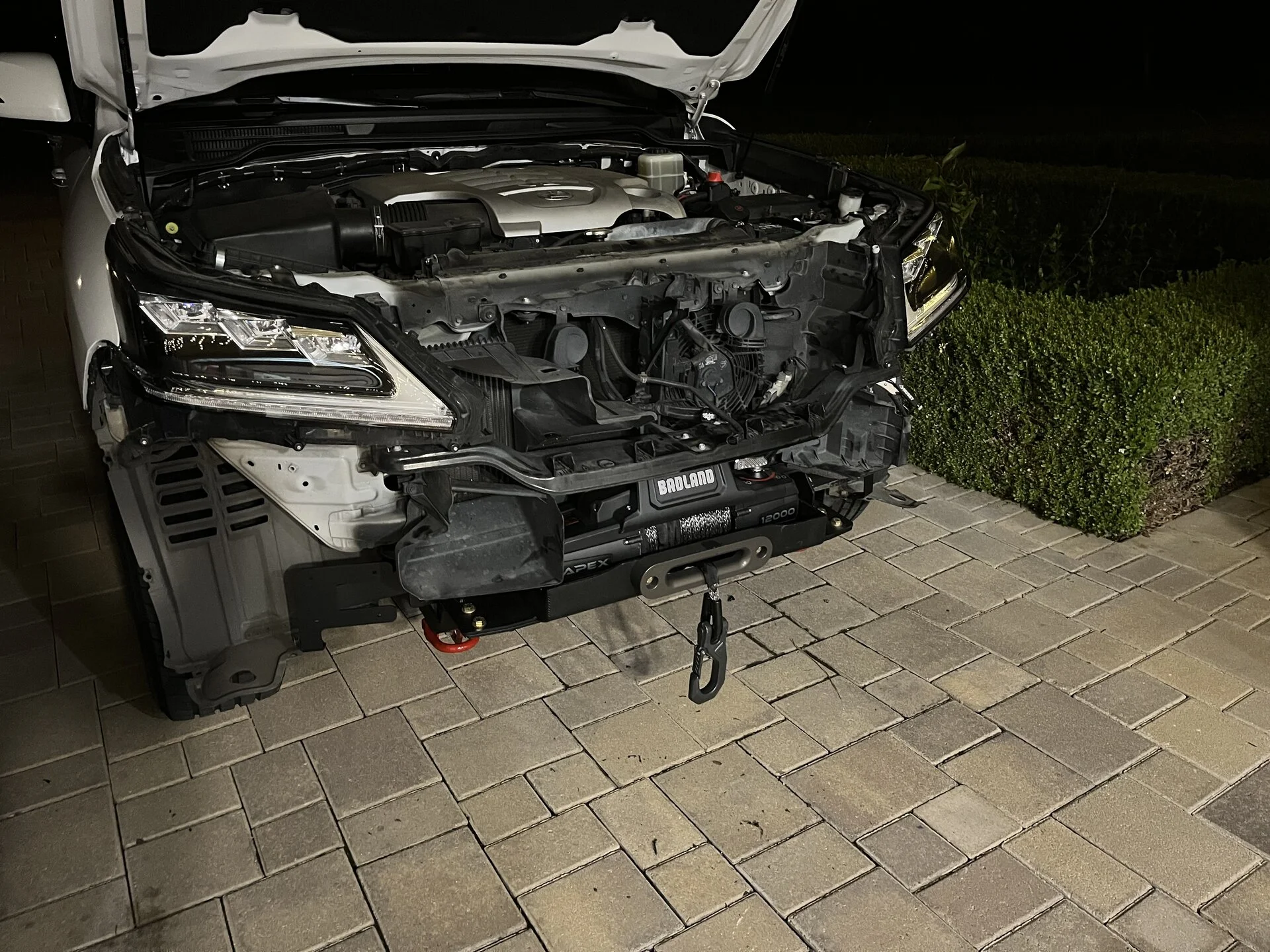

Thank you. I was able to get everything buttoned up, and honestly it wasn’t bad doing it myself.

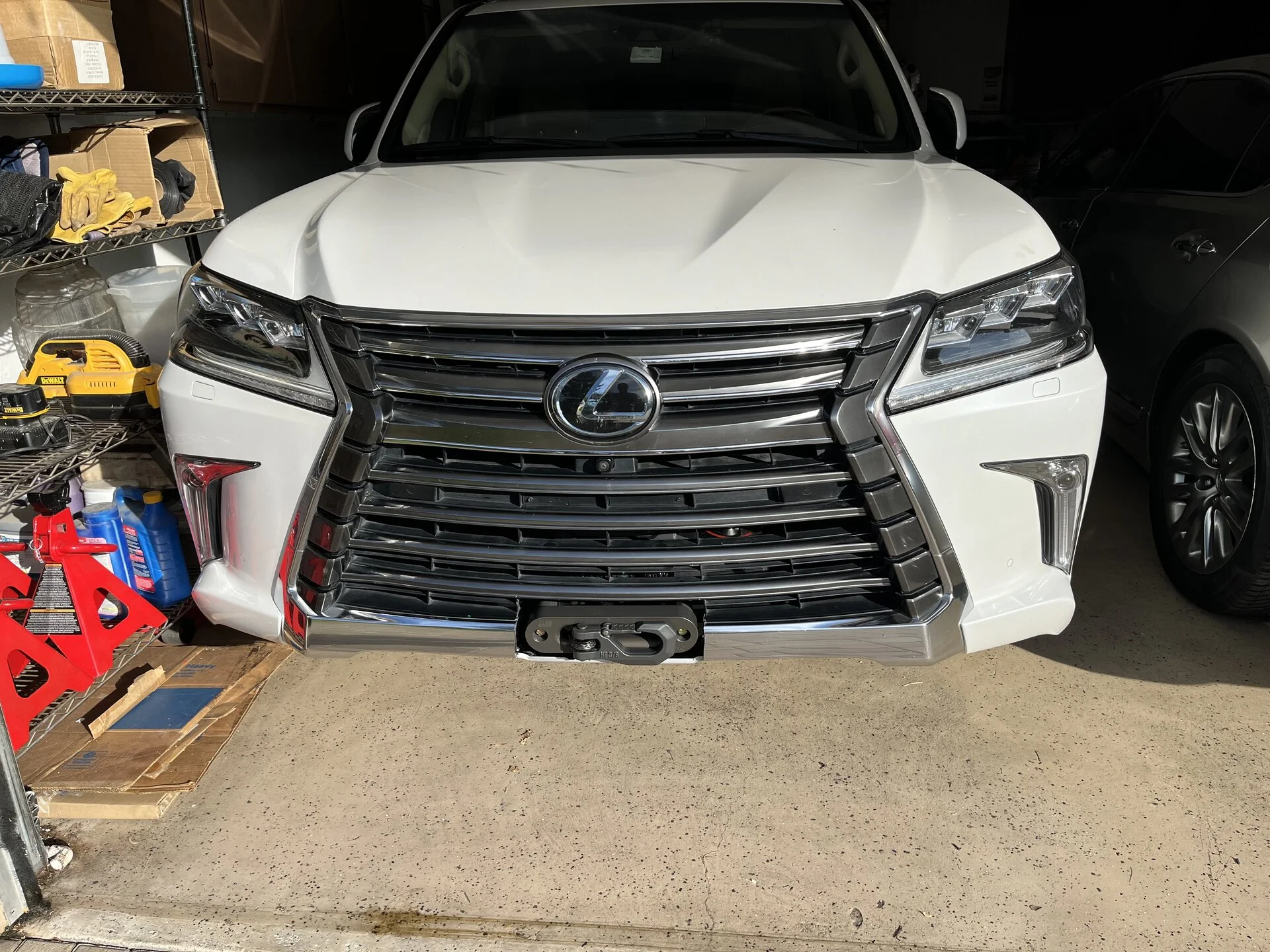

What would you recommend doing to extend out the fairlead? I did a search on here but didn’t find anything worthwhile. In the photo with the bumper back on I have some spacers and longer bolts, which gives me the 3” I need to push it forward, but I’m not sure it’s the best solution.
I’ll consult with another guy in my local club. He has the older grill but the same combo. I just saw it yesterday and he has some sort of extra angle bracket he penetrated the bumper with. You’ve already cut the rectangle so it might not be necessary. If the fair lead is flush that’s all you need. And in Texas we have to have a front license plate. Victory4x4 makes a cool fairlead mount flip up plate holder.
