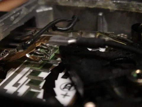

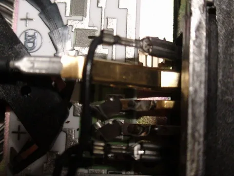

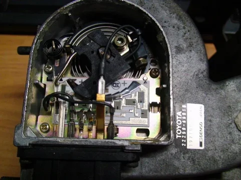

I unscrewed the screws instead of trying to figure out how the connector actually came off first. Now car starts and runs 2 secs and shuts off. Like everyone else I was cleaning my intake part etc.
At least my throttle body is already super clean and my intake hose has no cracks in it and is in pretty flexible shape.. and surprise air filter in great shape.
Got the lid off the MAF and took pics of the connections.. only problem is I can't see any obvious disconnections from the solder on the three prong things which are shown in the threads I found on this problem. Or maybe I am dumb don't know haha. I was just comparing my pics to the ones in a thread where the guy redid his solder on the 3 prong connectors
Oddly enough I read all the FAQs and newbie stuff and don't recall coming upon this dreaded possibility.. my bad.
Can anyone see any obvious disconnects with the solder in my pics??? thanks

Peel those little tinfoil things off the 3 connectors then undo the screws that started it all. If you gently wiggle the connector youll see what was disconnected. Theres 3 prongs that will need soldering, one is obscured by another wire.
Good luck.

I realize what I have to do to possibly fix.. will update sometime this week until I can get a soldering iron etc.
Well got my MAF back in and works great... not even any idle issues and the truck revs smooth as butter now where before it would feel rough revving up the powerband once it got past like 2500 rpm.
I didn't have my own solder iron so I paid my local shop $23 to do it for me and apparently they did a good job.
Saved me $700 boy am I relieved and will never touch those screws again since I know the proper way to take off the darn thing.
