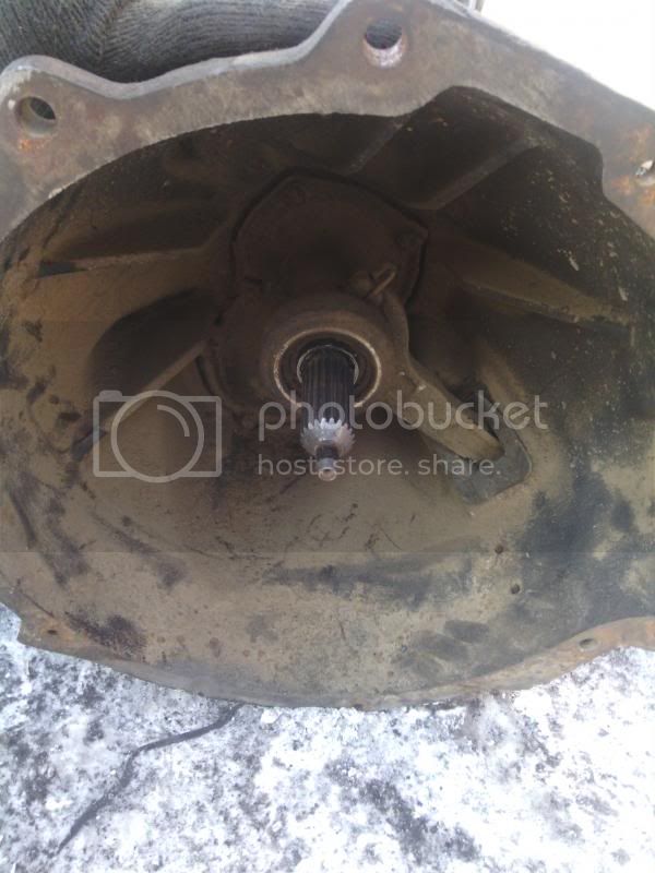

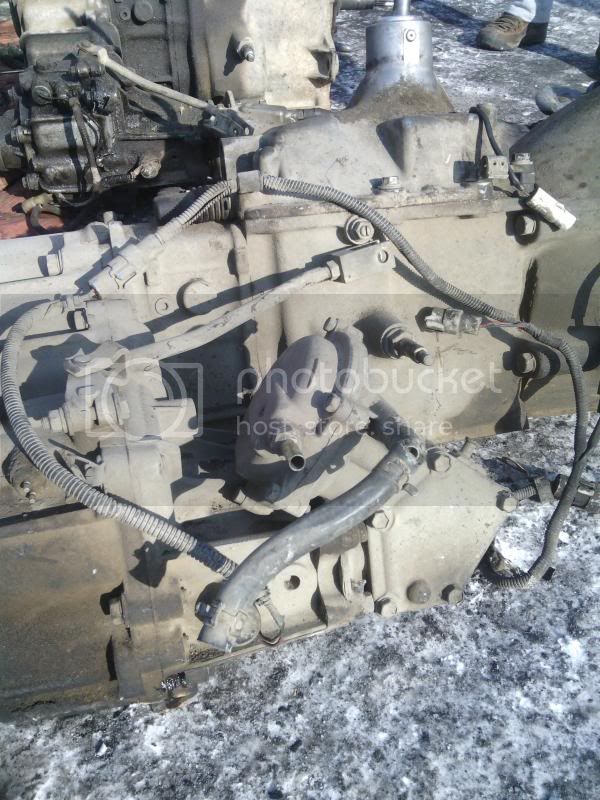

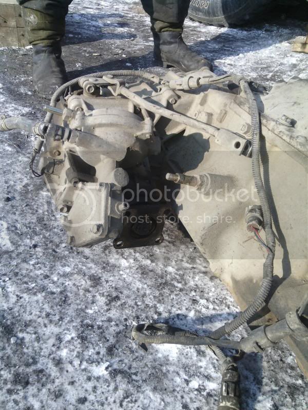

Hi Guys, Do you know from which car this might came from? Guy says it came out of 61 series but the vac shifter looks different.
Any ideas? Here some pics of it.
Thanks
US model FJ62's have vacuum controlled TC shifter.
EDIT:..never mind my comment...you were looking for something else related.
Fine spline input points to B series engine I thought.....
Or HZ/HD engine. I bet it came from a 70 series truck with either a B or HZ series motor.
All of the vacuum transfer case shifters for 6x trucks I've seen look like this (vacuum hat is flat):
Thanks
Old post and you probably figure out it came from either BJ42 or BJ46. Possibly the top cover your selling? Unfortunately I already have couple of top covers already. That transfer case with vacuum shifter would nice if you weren't on the other side of the world.
