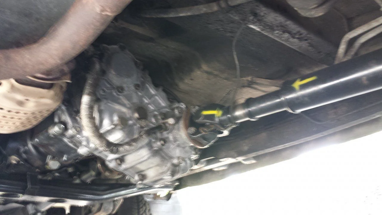

Just had a H55f installed at ACC TOYOTA in Georgia. They replaced the drive shafts and rebuilt the transfer case at the same time. Best mod you couldH
Mod you can do, Very Very low 1st gear with stock tires.
The transmission mount also changes.
