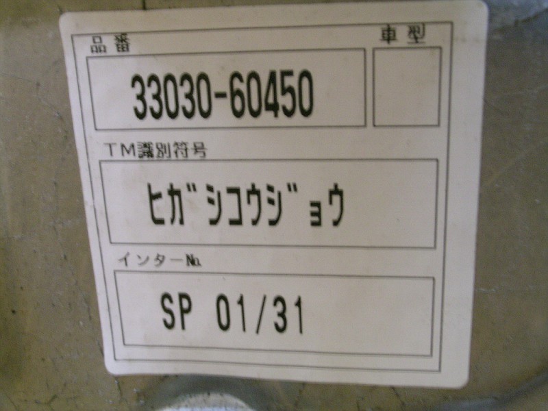

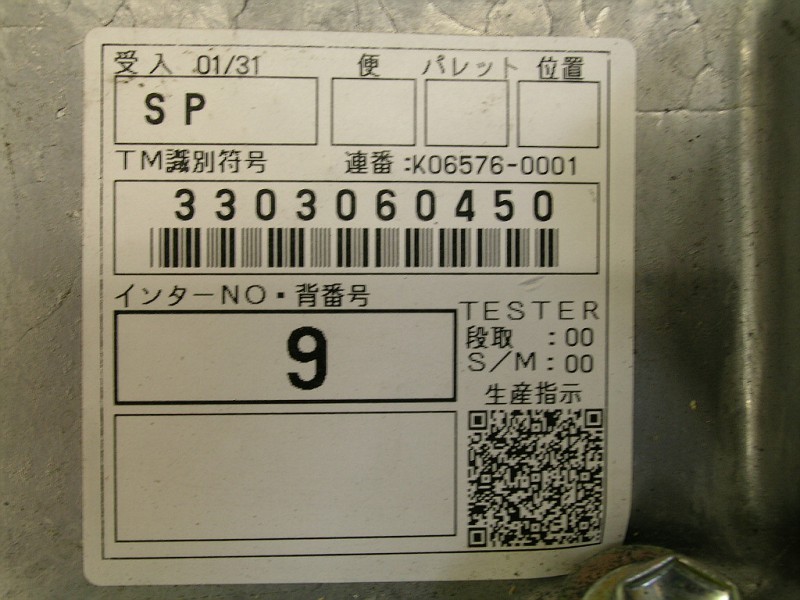

Where are the H55 trannys labelled? I'd like to figure out just what 5 speed got put into the FJ60…..BTB Products did the vortec conversion a couple of owners ago and the receipts are a little vague but there is clearly an invoice that includes "heated and bent to correct angle for clearance and then installed transmission shifter"…The photo above shows the shifter from my BJ74 installed and not having any clearance issues…..Perhaps because they used the 4 speed shifter they had to mod it for clearance?
The 5-speeds had a white decal with the part number and some other info on the top cover but that's about it.

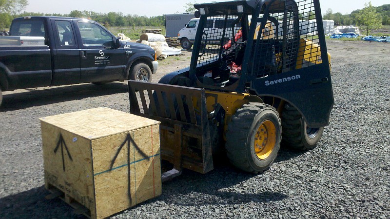

Georg @ Valley Hybrids
As per beautiful Valley Hybrids crate i received a few years back...
:eek: That is STUNNING!!!! harumph…..time to shuffle again through the slop (raining on top of snow:crybaby: - would prefer all snow!) to look for stickers….very doubtful….
