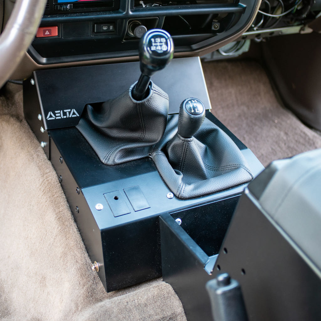

Delta has a pretty neat replacement console.

I can get OEM LHD manual consoles if anyone is looking. @mudandrock had also been having some 3D printed but he’d have to comment if those are still available.
