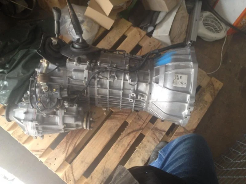

Hi all,
Throwing some thoughts that I had these days about h151.
During research of making 5th gear from 0.88 to something like 5th on h152 which is something like 0.76 if I remember correctly, all that I found is that a shaft must be swapped from h152 which need some more changes.
But recently some new info from fb groups came about kit which is only for 5th. The kit is from terrain tamer and a friend alredy did some research about it.
So this is what he found: the kit is not for all h151 gearboxes, there are gearboxes h151 for 80 series and h151 for 79series, so old gearboxes integrated in 80 series can't put this kit, but the newest h151 integrated in 79 series can.
Which triggered a new search why? And what I found is different letters on top of the box.
My box have S and newest selling now have T, i'm wondering if someone knows what these letter stands for and if someone knows about this kit only for 5th?
This is my box and in internet I found new once with T
